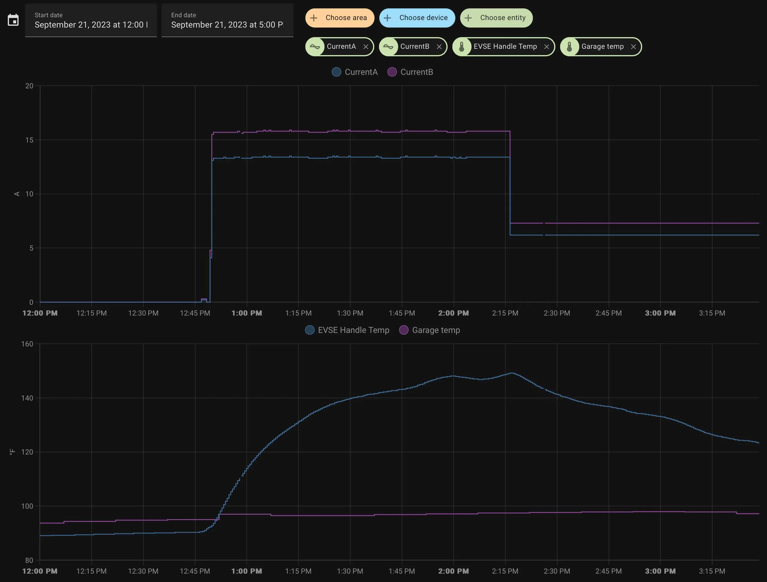

Currently I'm charing my FFE in the driveway from my WallConnector. It's a 6.6kW car. The charger is currently throwing 3.3kW at it because the handle is too hot for Tesla. (Probably not that related as this is a 11 year old Focus EV)
Ford Mustang Mach-E L2 charging speed recently dropped 33% Screenshot 2023-09-21 at 3.28.52 PM

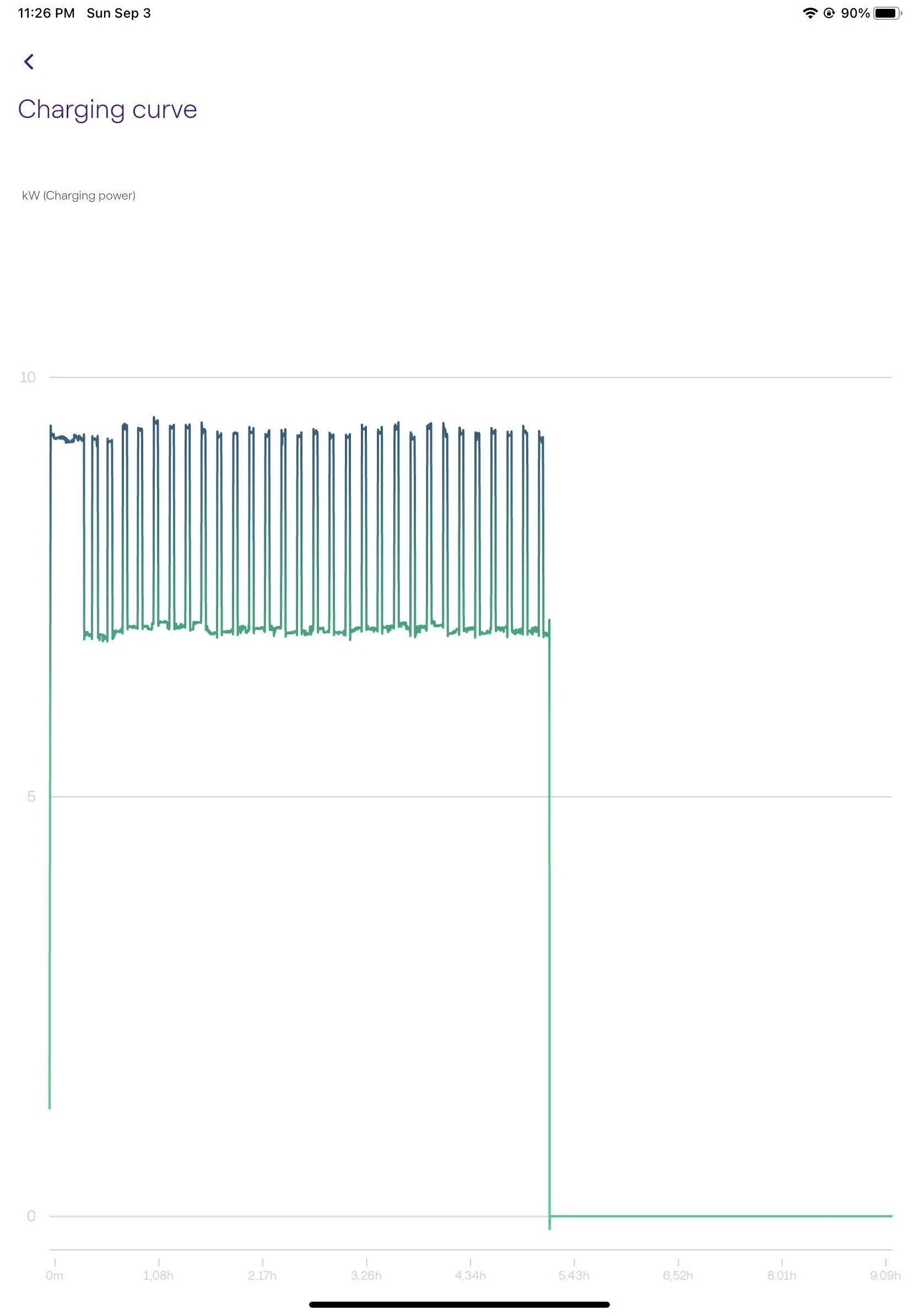

mine doesn’t zig zag, goes up and down like a yo-yo after about 45 minutes of straight 40 amp
Ford Mustang Mach-E L2 charging speed recently dropped 33% IMG_2366

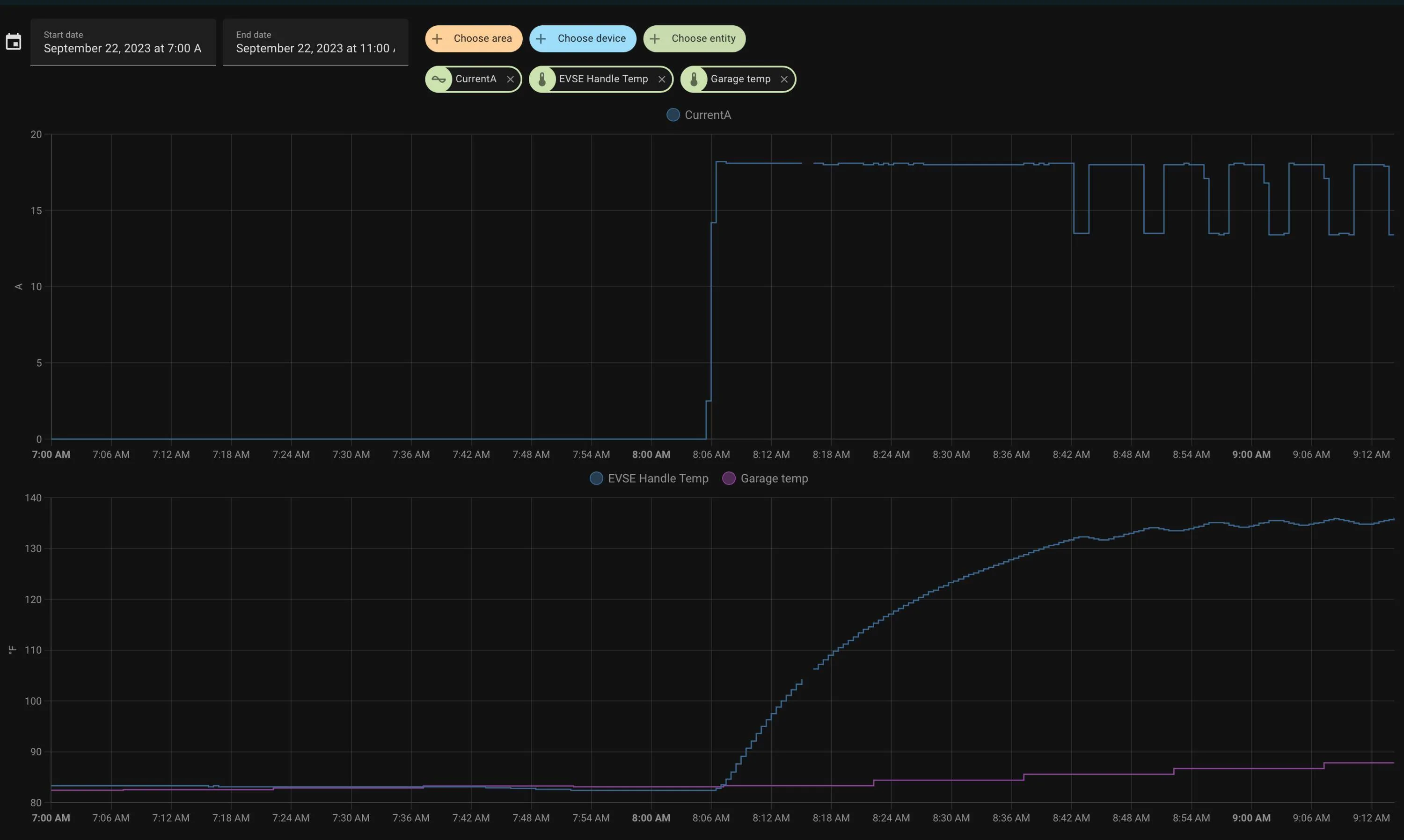

He only charged for 1.5 hours and it probably wasn't quite hot enough in Canada for the true yoyo to happen.
Ford Mustang Mach-E L2 charging speed recently dropped 33% Screenshot 2023-09-22 at 9.14.36 AM
It's going to have to be less than 60 degrees out to keep the yoyo from happening it looks.
