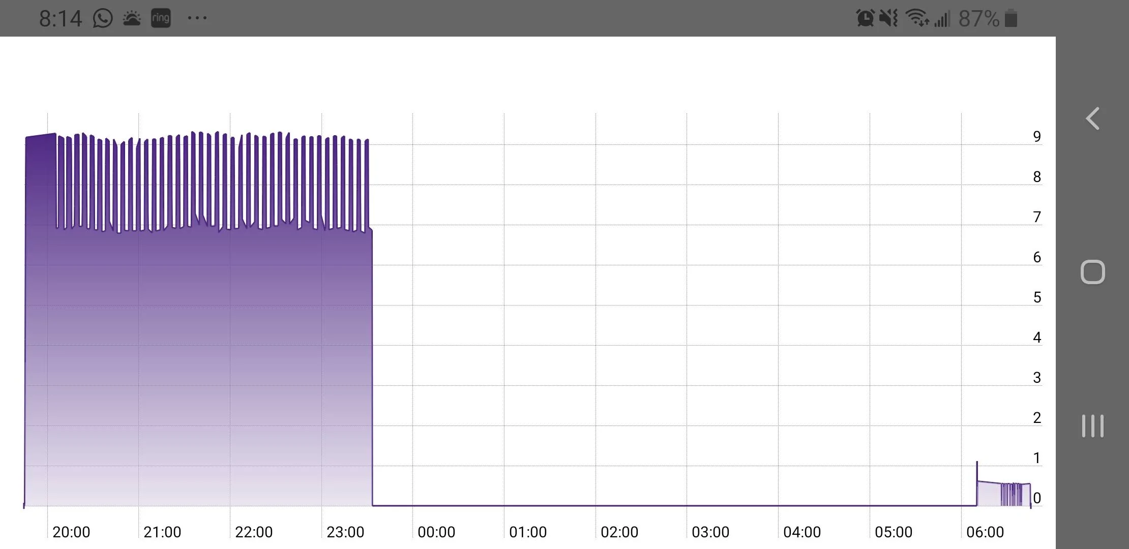

BTW when I cleaned the pins (my car has 32k on it) it helped with the tiny fluctuations, they still happen, but not as much (as much of a swing from .5kW, now more like .25kW).
I don’t know anyone with a 48 unit. As I said before Best to get my torch cigar lighter and see if I can heat up the unit just enough .
Come on over, I'll wait. lol.

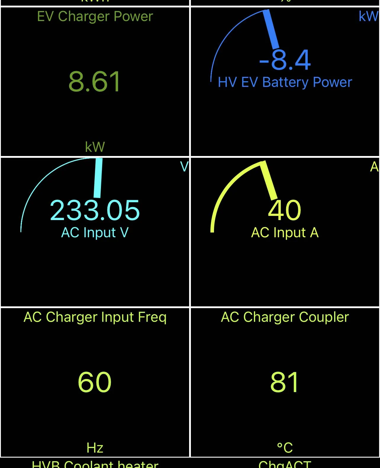

Trying to add to the data collection but I don’t know how y’all are making those data log graphs. With my OBD reader plugged in, the coupler temp was showing 70°C while charging at 32 amps after 30 minutes or so.
Ford Mustang Mach-E L2 charging speed recently dropped 33% IMG_4317
I then amped up the Grizzl-E (pun intended) to 40 amps.
After 15 minutes it’s still pulling 40amps, 8.4KW with a coupler temp of 81°C.
Ford Mustang Mach-E L2 charging speed recently dropped 33% IMG_4320
I’m sure it’s about to slow down, but I can’t stand out here all night staring at my phone.

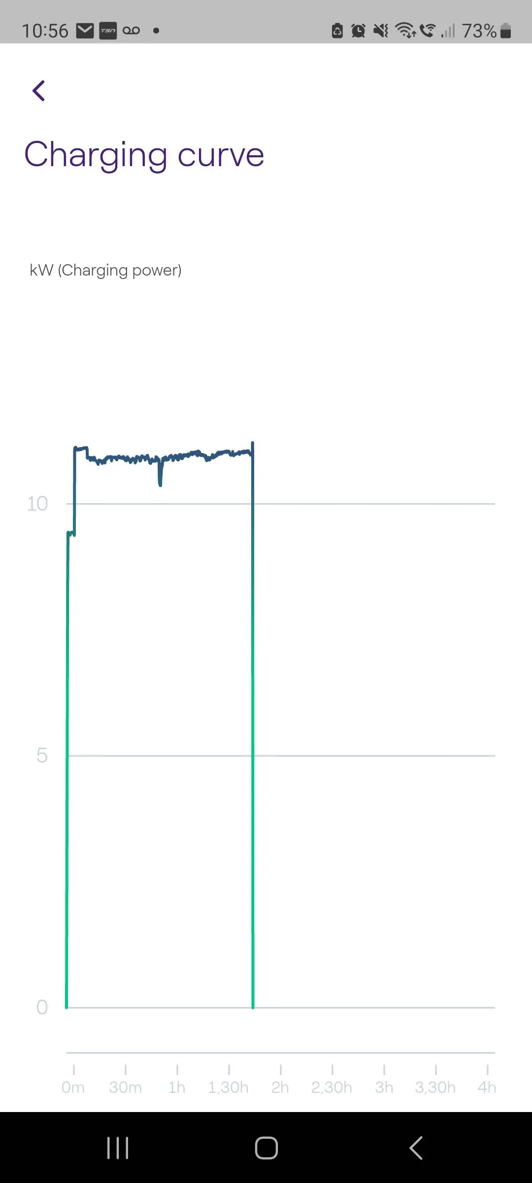

My EVSE is a juicebox pro 48. It's a smart charger that automatically draws the charging curve. I bought it specifically to be able to monitor and troubleshoot anything that occurs. Money well spent.

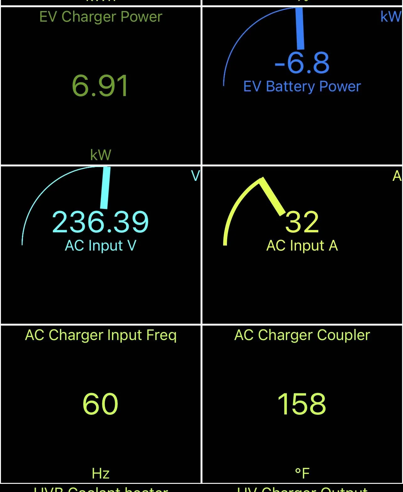

I guess for this purpose my complete lack of a circadian rhythm has been useful. Couldn’t sleep so I went to check the car.
84°C coupler Temp and still doing 40amps. Fans were not running. But then I watched it drop to 30 amps. Stayed there until the coupler temp reached 74°C then back up to 40 amps. I watched for 10 more minutes and screen recorded my car scanner app. Took right at 5 minutes to then hit 83°C and fall back to 30 amps. This time to fans turned on and the temp took 3 minutes to fall all the way to 72° before it resumed 40amps.
So my new charge port is still reaching 84°C and charge is being throttled to 30 amp speed. It’s only 58°F on the garage tonight and still I can only maintain full 40 amps for about 5 minutes.
