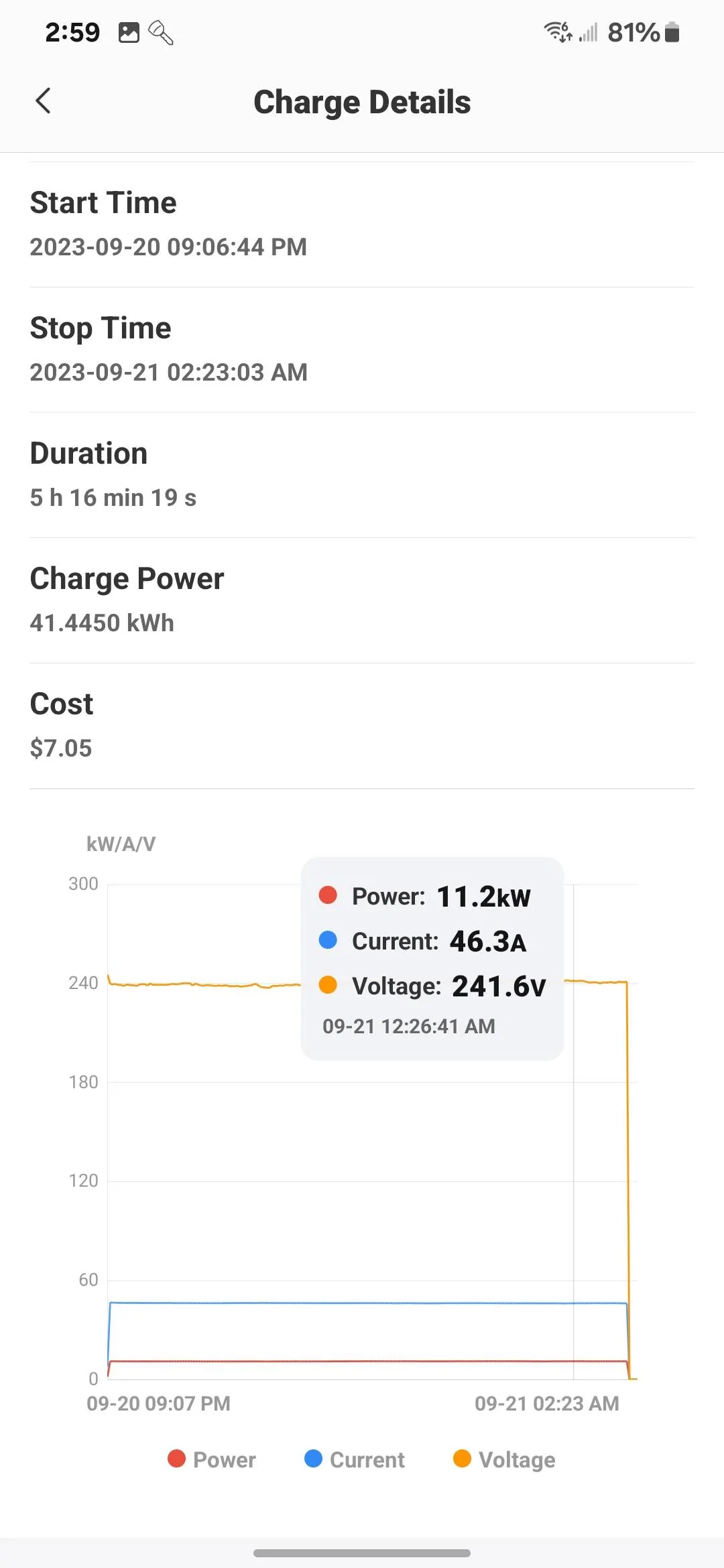

Space_Pony
Jun 7, 2023
1,710
1,442
Indiana
2023 Premium Mach-E awdX
I've never seen any problems like that. Are these problems mostly on the 21 and 22 models. Fordpass shows a constant 10 kw and Autel shows 11.0-11.2 and 46.5 amps with no fluctuations in the chart.
Ford Mustang Mach-E L2 charging speed recently dropped 33% Screenshot_20230925_145939_Autel Charg
kdryden99
Richard
Sep 25, 2020
1,644
1,426
Montreal Canada
Nissan Sentra Spec-V, Infinite Blue Mach E4X Prem
Yours seems to be fine.
My EVSE is set to 48A. A couple times recently, it’s charged fine - 10 KW shown in FordPass. When the throttling kicks in, it drops to 7 KW, or about 34-35A input. I’ve never had it not charge at all.
10 Kw though is not 48 amps. When I would set the current to 44 amps it would bounce not cut off. 48 amps is 11-11.5Kw so it sounds like it is already throttled. You might be observing the 34-35 amps throttle because it's set to 48. If you leave it 40 amps I'll bet you see it bounce after ten minutes. This would indicate the same problem as I had.
