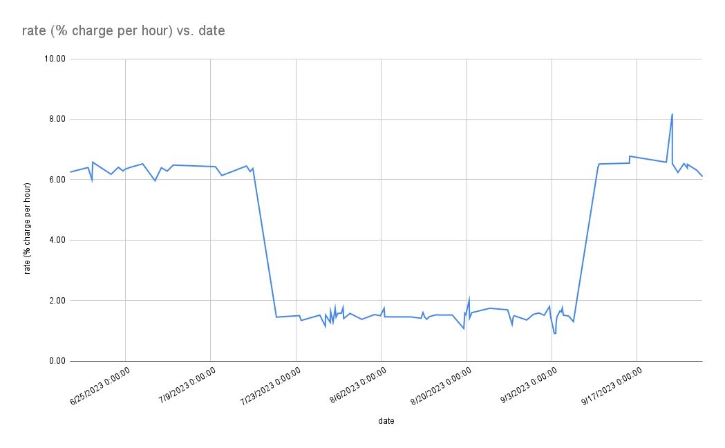

Adding an update from my end since I reported my experience with this issue on July 29th. My problems started on July 19th and lasted for about 2 months before it magically started working at the normal charge rate on Sept 10th. Notes from that timeline:
  • July 19 - First noticed issue which coincided with 23-PU0314-DCM-LAT update
    • Went from roughly 6.5% charged per hour to 1.3% per hour
  • August 18 - Received 23-PU0110-RAAD-PS update with no change in charge rate (expected)
  • September 10 - Issue seemed to resolve itself with no intervention on my end - back to 6.5% charging per hour
  • I did some DCFC in between July 19 and September 10 but not a ton
  • I did a few public L2 charging sessions which seemed like normal charging rates compared to my typical charger at my apartment
  • Ambient temperatures have been roughly the same throughout the period and not excessively hot by any means (Bay Area weather)
  • Did not do any port cleaning or get my port replaced
  • I had talked to some Tesla owners who also charge at my apartment during the time I was having my issues and they didn't notice reduced charge rates in their cars
At this point, I have no clue what caused my particular issue but I'm glad it's resolved. I hope others in this thread get some closure on theirs. Attaching my (crude) chart of my charging rates over the past 2 months based on FordPass charge logs in lieu of smart charger/OBDII logging.
