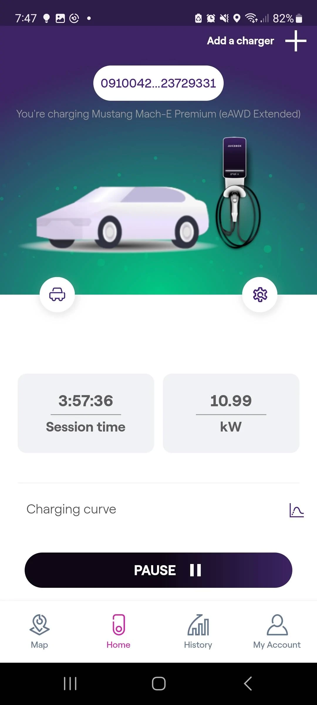

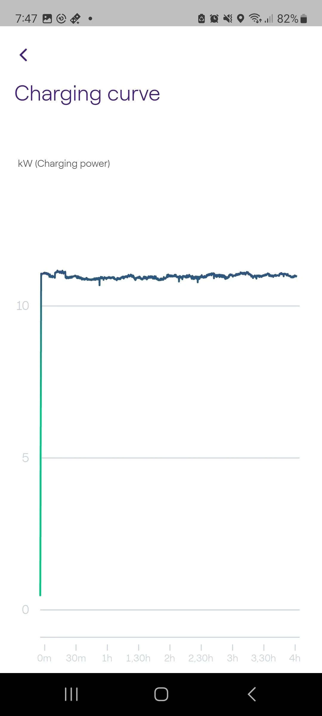

I'll post the work order tomorrow. I got back at roughly 4pm. Here's my curve at 48 amps. Seems the temp sensor/plug harness resolved the issue.
Ford Mustang Mach-E L2 charging speed recently dropped 33% Screenshot_20230924_194727_Enel X Way
Ford Mustang Mach-E L2 charging speed recently dropped 33% Screenshot_20230924_194718_Enel X Way

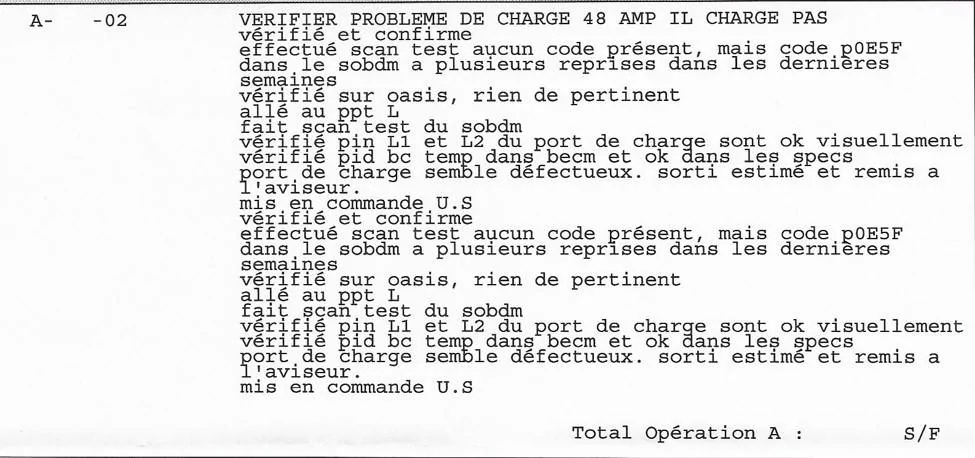

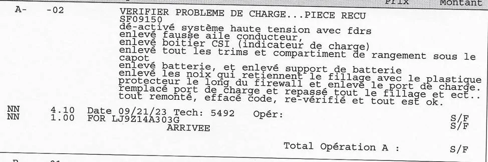

As promised the work order
The first part
"Verified problem charging 48 amp doesn't charge. Scan test no code present except P0E5F multiple times in SOBDM. Verified OASIS nothing pertinent. Verify pins everything ok. Verify temp in BECM OK. Charge port seems defective. Order port from US"
Ford Mustang Mach-E L2 charging speed recently dropped 33% WorkOrderMME_0001
Ford Mustang Mach-E L2 charging speed recently dropped 33% WorkOrderMME_0002

That is what I kind of guessed you had the code P0E5F and This was what help your dealer and you get fixed. We got the software that lowered the charging speed so we would never get that code and hence no fix. Just slow charging limbo for months with the current understand that our charging hardware is overheating and this latest inconvenience is for our safety so the vehicle does not catch on fire.
The fact it was not charging at 48 amps though seems to be the clincher not really the code.

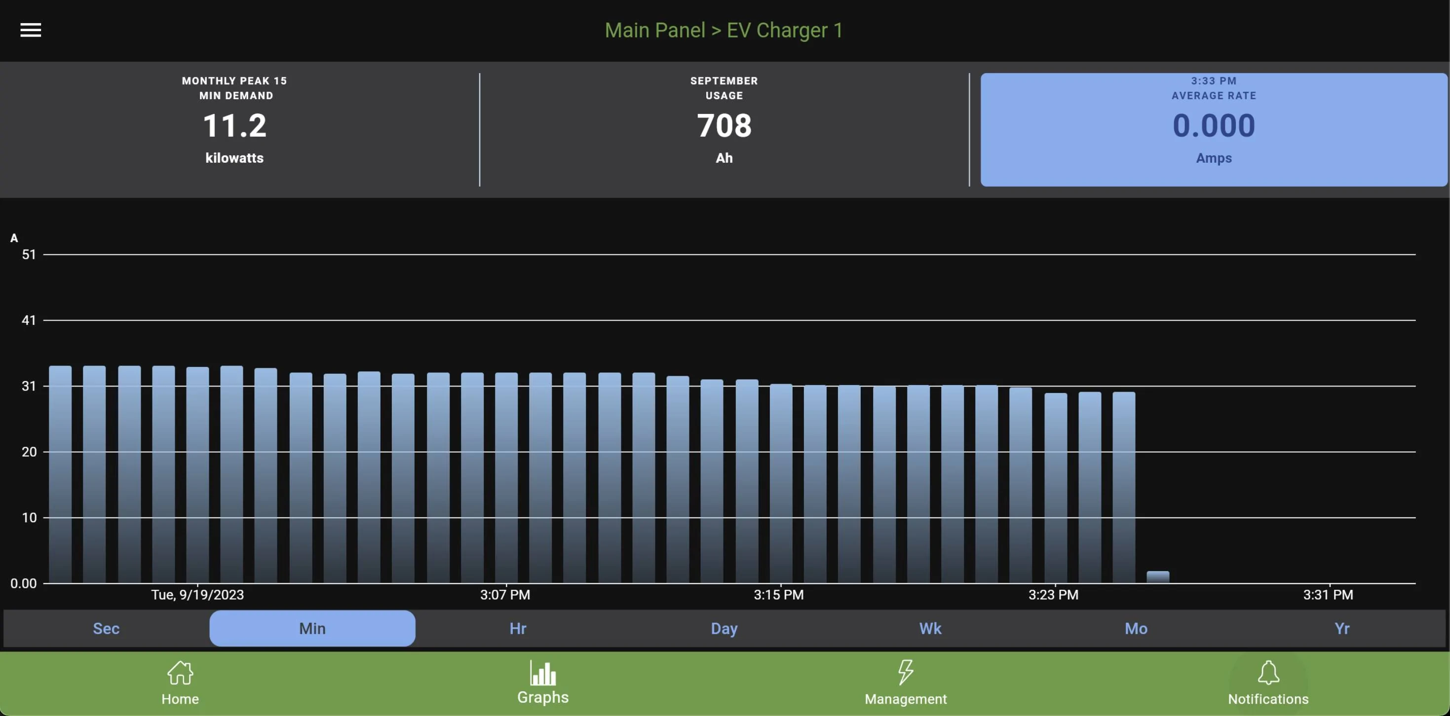

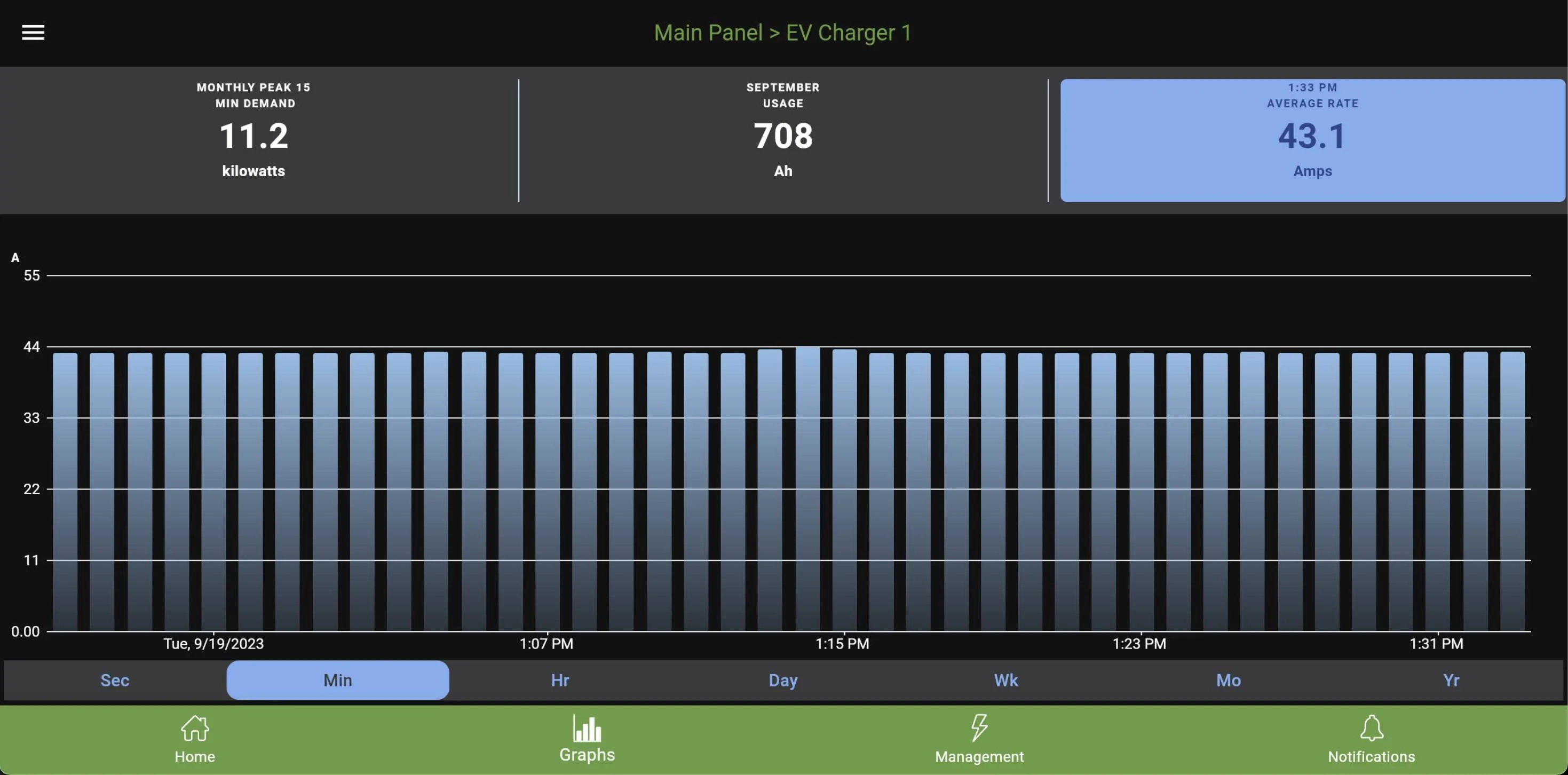

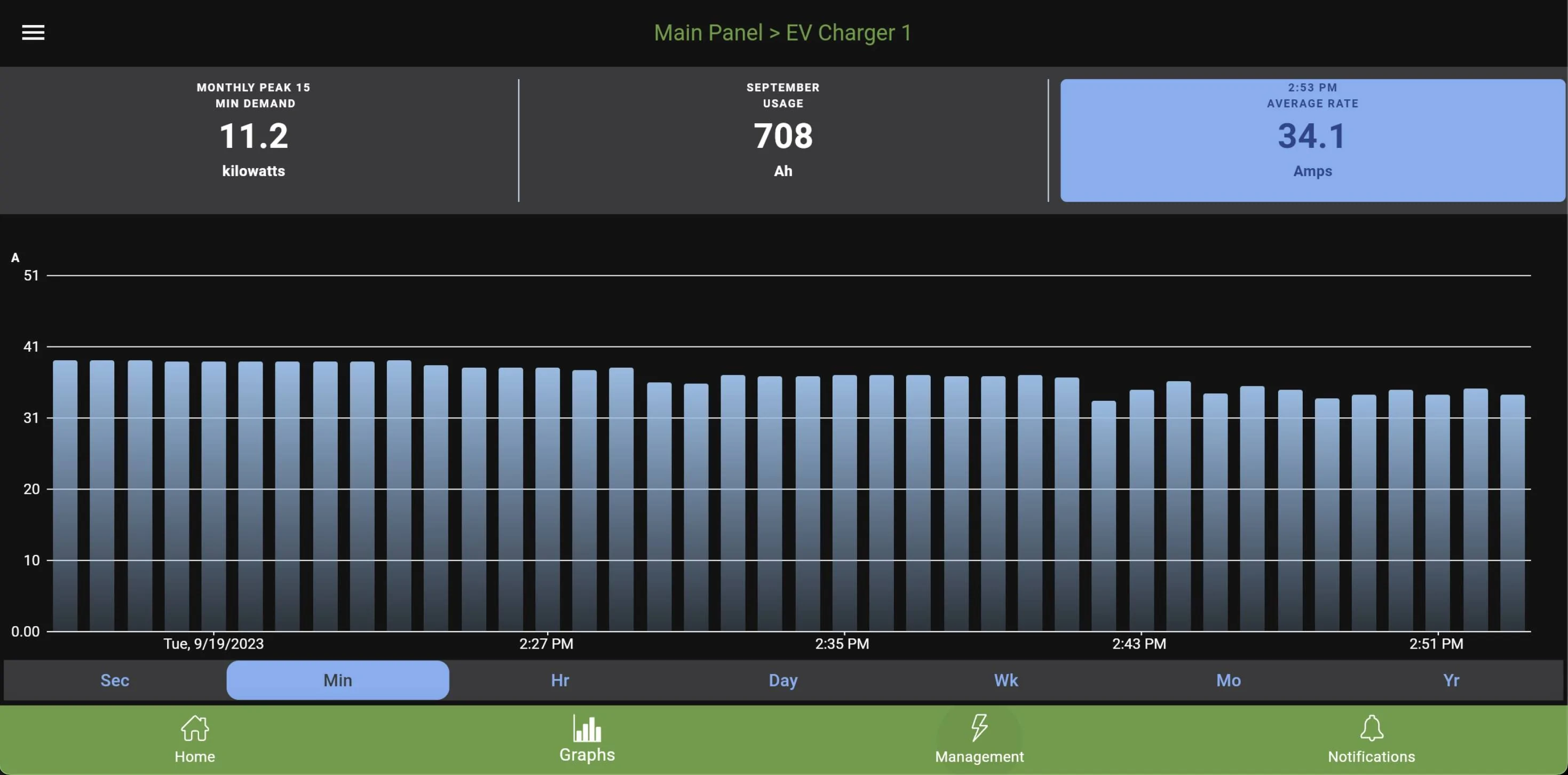

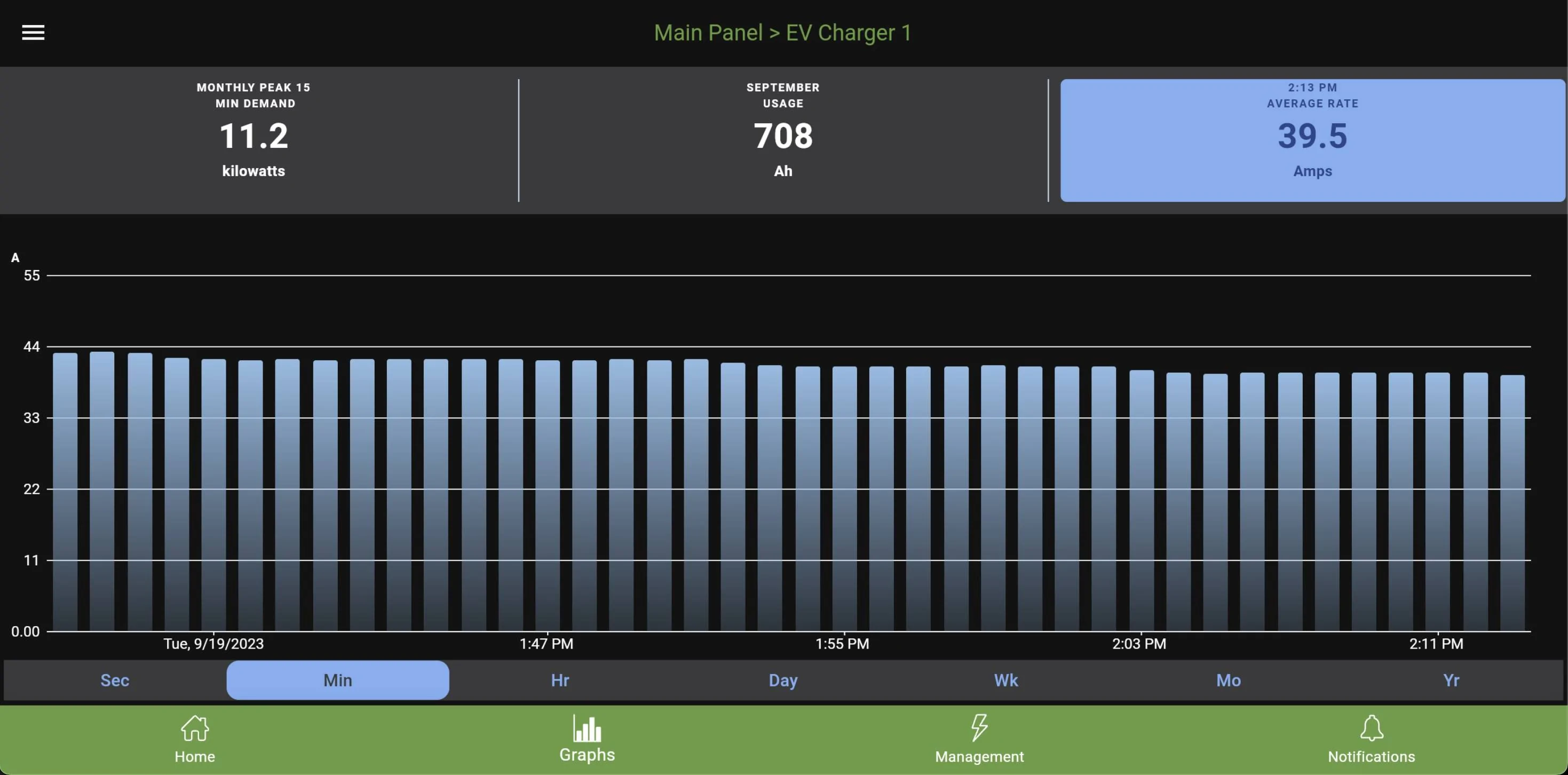

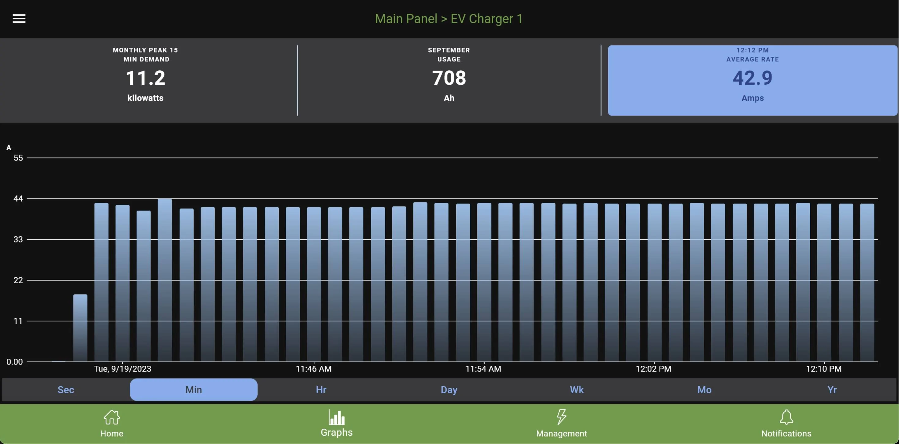

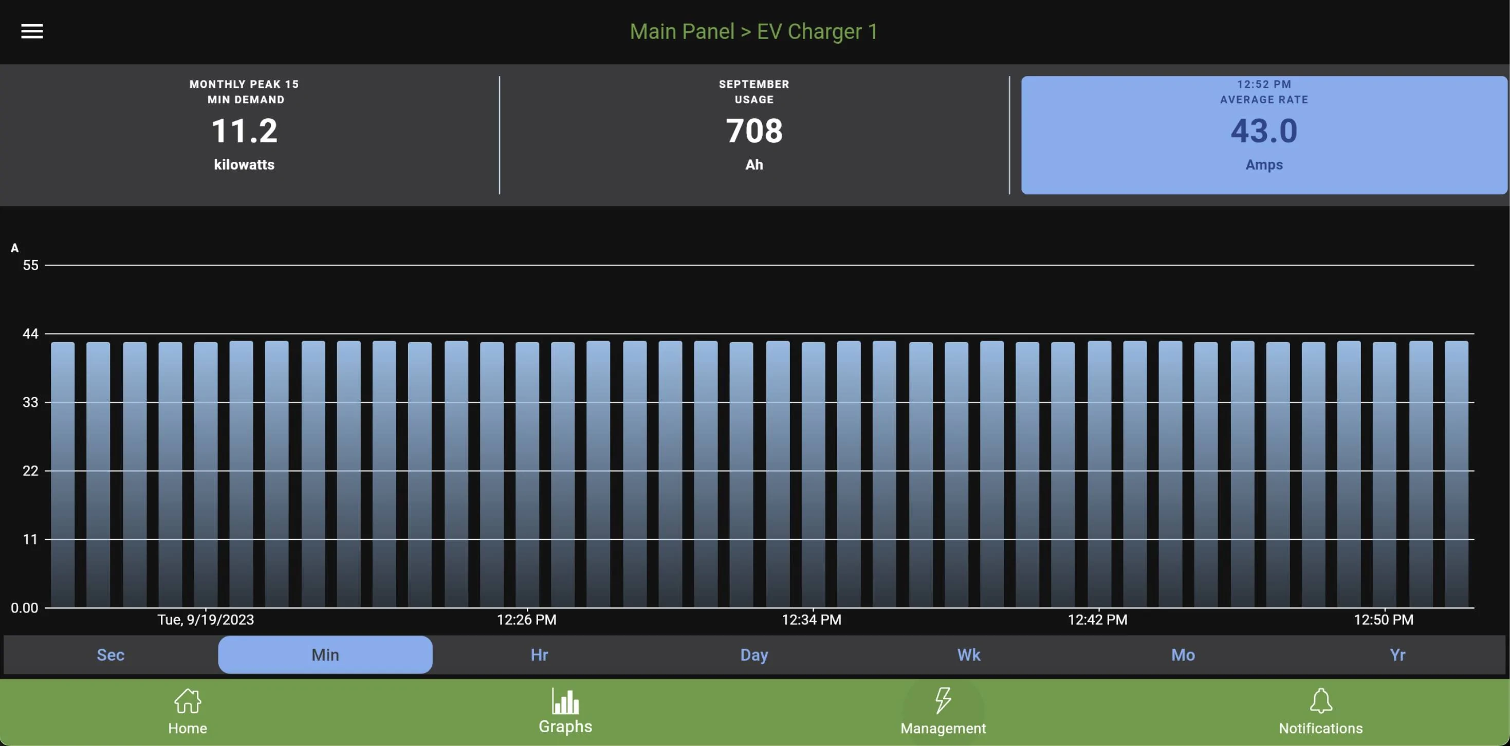

I'm confused about this charge throttling/speed reduction. I've read where some have it and some don't. I've read it might have to do with a defective sensor in the chart port? I've read that there was an update sent out OTA which lowered the charge speeds?
Back in June on the second and fifth pages of this long thread, I posted screenshots of my charging graphs with no fluctuations nor reduction in charing speed. I was told that I possibly didn't receive the update yet. Here we are three months later and I still don't see throttling nor reduction in speed during charging. I do all my own updates with FDRS.
I charge in my garage which is temperature controlled to never go above 80˚ in the summer, below 66˚ in the winter. I have my Emporia charger set to only charge on excess solar but every once in a while I need to charge from my batteries. The last time I had to do this was on the 19th of this month. Below are graphs of my 3 hr 55 min charging session. Each graph is a 40 minute period. I have my charger set to the maximum 48A and on that setting, the car always charges a solid 43 amps. I believe I was around 65% SOC when I started but don't remember. The car is set to charge to 100% so as the battery nears fully charged, the speed starts to drop which is normal but I never get a fluctuation.
09/19/23 11:35AM - 3:25PM
Ford Mustang Mach-E L2 charging speed recently dropped 33% Screenshot 2023-09-25 at 6.02.09 AM
