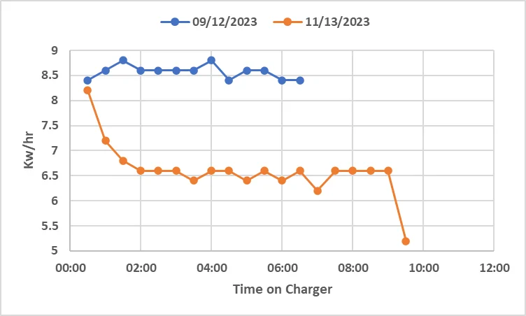

Well, the car finally finished charging just before midnight last night. It took 9.5 hours to charge from 17% to 90% using a 30 amp Grizzl-E Smart Charger.
I looked at the data from September 12, 2023 for comparison and plotted out the charge rate (Kw/hr) based on the "Energy Added" from the Ford Pass app for both charging sessions, Here is the plot:
Ford Mustang Mach-E L2 charging speed recently dropped 33% 1699978239134
It started out good but then dropped very quickly from 8.5 Kw/hr to 6.5 Kw/hr.
For the charge on 09/12/2023 it started at 25% and ended at 90% and took 6.5 hours. (before 23B50)
For the charge on 11/13/2023 it started at 17% and ended at 90% and took 9.5 hours (after 23B50).
I also looked back to a charge I did on 09/02/2023 which started at 18% and ended at 90% and it only took 7.25 hours to complete.
I think it is ridiculous for Ford to de-rate my charger from 8.5 Kw/hr to 6.5 Kw/hr. They need to FIX the problem and not just cut the charge rate.
Am I going to see a similar decrease if I use my AeroVironment 32 amp charger???????
Has anyone seen anything similar when using DCFC?
Very disappointed!!!!!!!!!!!!!!!!!!!!!!!!!!!!!!!!!!!!!!!!!!!!!!!!!!!!!!!!!!!
As I noted for 6 months now disappointed also. You would think if something is over heating operating at the specifications it was sold at it would be fixed not just the power lowered to the part that is over heating and is unsafe.
If we had a 48 amp charger it would be down to 6.5 Kw and a 33% decrease in charging speed as the title of this thread states. Since you and I use 40 amp we are seeing a 25% decrease.
It is now charging at 32 amp on your 40 amp so AeroVironment 32 amp charge should be similar 0.24 V x 32 amp x 0.85 efficiency = 6.5 KW
DCFC is good here still (tested a few times after installed) and therefore I think it has nothing to do with the pack, HVBJB etc. It is something with the L2 charging system before it gets to what is redundant between the 2 types of charging is my guess. Or crappy software that tries to monitor temps and falls.
Nothing was ever melted here for the first 2.5 years just this software is trying to tell me there could have been :confused:.
Edit: 0.24 KW changed to V
