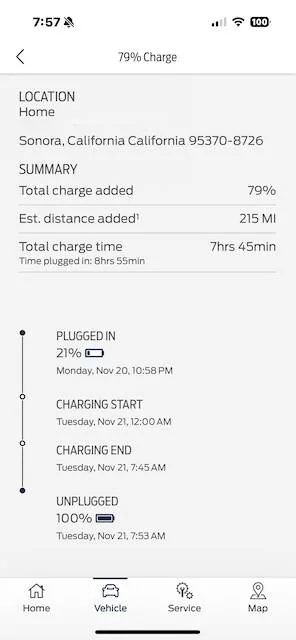

I charge my car mainly during the day on excess solar using my Emporia charger. I've posted graphs of my solid, non cycling charging stats and have been told because I only charge for a couple of hours that I will not get the up and down charge cycling that others get. Thought I would charge from the grid for an extended period of time to see if I get the cycling......
Last night after getting home from the airport I plugged in my car at around 11:00pm. I set the Emporia charger to start charging at midnight (12:00am) and the car is set to charge to 100%. The SOC when it started was 21%. By 6:30am this morning the car was at 90% and by 7:45am it was fully charged to 100%. At no time during the 6 1/2 hours from 21%-90% SOC did my charge drop below the average of 46.5A. I took screen shots of the Emporia graphs set to minutes. Each graph represents 40 minutes of time.
Not sure what you are saying with this one? You don't have the bug the rest of us are seeing?
From 21 to 90% is 69% in 6.5 hours or 0.69 x 88KW / 6.5hr is 9.3 KW/hr into the car. If you ball park efficiency at 85% that is 9.3/0.85 = 11 KW/hr or 11/0.24 KV = 46 amp. Pretty good sure does bet my 6.5 KW/hr. :(
His charge port is not overheating enough to cause his car to limit the charge rate. Mine takes two hours to get hot enough, yours much less. I think you need a new charge port, and mine probably needs to be cleaned.
This thread is about reduced charging speed and early on when this thread started I stated I had not seen this and was told by several members it was because maybe I only charge a few hours a day and I needed to charge for a longer period of time to see the issue. I rarely ever charge like I did last night as I would have normally just charged a couple of hours each day for the next few days on solar. I figured I would charge the car on grid power from a lower SOC up to 100% which would give me an enough time to see this issue. No matter what charge amperage I set my Emporia to, the car will charge at that and never fluctuate. I have the charge set to 48A and consistently get a solid average of 46.5A.

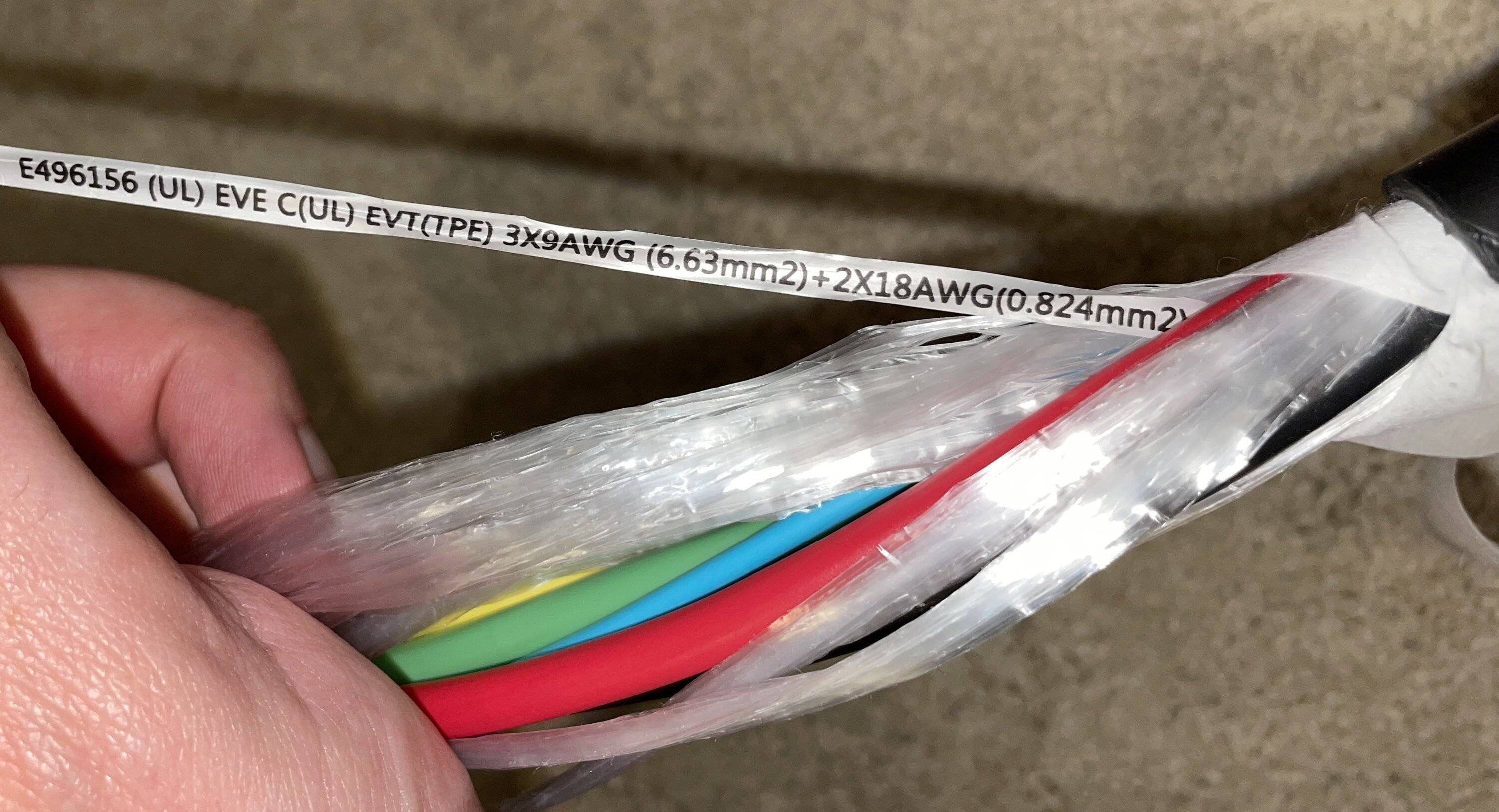

Ok, so then very recently changed. The cable I had on the ChargePoint charger was very thing and flexible compare to Emporia's but it also got more warm than the Emporia cable does so not sure if they are using thicker gauge wire or not.
ChargePoint does use slightly smaller wires (9 AWG) than other brands (8 AWG) to increase cable flexibility. As a result, the cable and J1772 connection run a little warmer, and would be more likely to induce charge port overheating than other cable brands. It's still a great cable IMO, rated for 105ºC.
There you go. Thanks for confirming that Lee.
