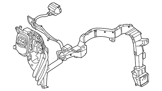

De-active High Voltage System with FDRS Removes Conductive False Fender, Removes CSI Box (Charge Indicator) Removes All Trims and AE Storage Compartment Under the Hood Removes the battery, and removes the battery holder removes the nuts that hold the filling with the protective plastic along the firewall and removes the charging port. Replaces charging port and irons all filtering and ect.. Everything goes back up, clears code, re-checks and everything is ok. Part LJ9Z-14A303-G
Appears they have gone from version D to G at least
Drive Motor Battery Pack Charging Port Assembly - Ford (LJ9Z-14A303-D)
2021-2023 Ford Mustang Mach-E - lj9z14a303d

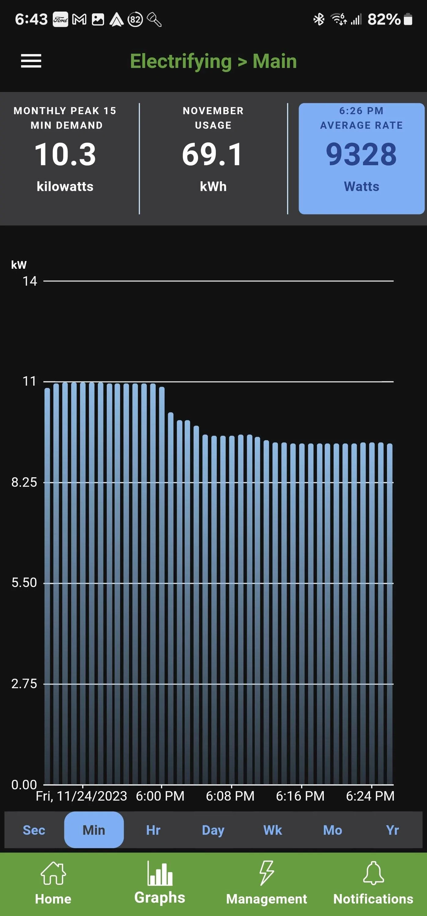

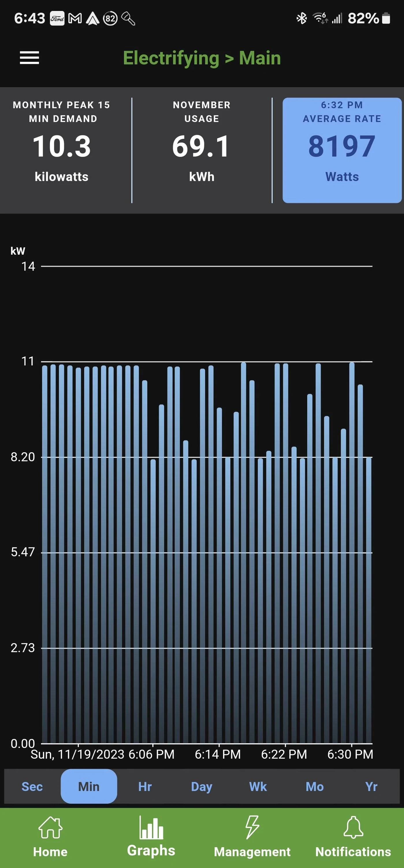

Got my car back after 23B50 update was done by the dealer. Tested charging and compared before and after the update.
Before update, it would bounce between 11kw and 8kw every 1-3 minutes. After 23B50 it doesn't bounce any more but gradually drops from 11kw down to about 9.3kwh. (I only tested a bit over an hour and it stayed at 9.3kwh for that whole duration.).
So it looks like 23B50 did something to the charge logic. Now I'm averaging about 9.x kwh instead of closer to 8.
Both started the charge at 11kwh for about 15 minutes before it started to derate.

That's interesting, instead of throttling the charge rate in ±12A steps it will adjust in finer steps until the maximum temperature is being maintained. Charge port is still overheating, it's just managing it more smoothly.

The average charge rate seems extremely similar between the two graphs.
Turning on the ignition interrupts the charging briefly, allowing the port to cool down, so then it will take a few minutes to heat up again and derate. I think it will happen again if you wait.

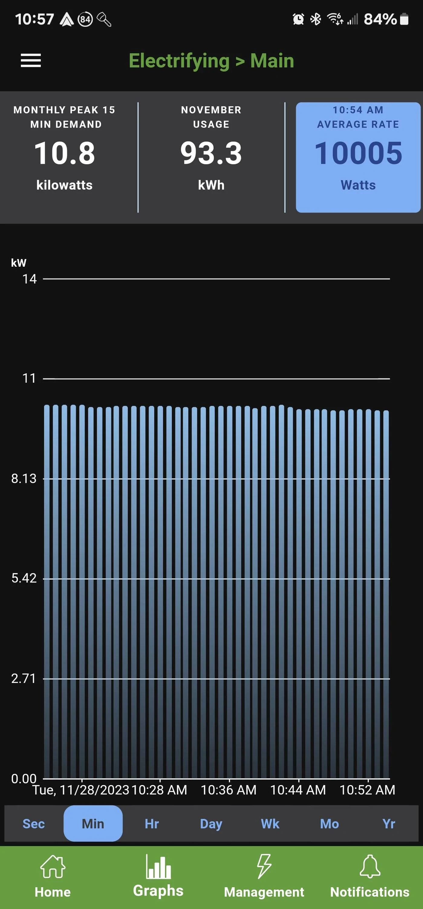

Did another experiment today. This time I left the ignition on, turned off headlights, hvac, radio etc.
It charged at 11kwh for about 45 minutes then slowly degraded and after 2.5 hours was still above 10kw.
So To summarize, with 23B50 it will charge at 11kwh for about 15 minutes then slowly degrade to about 9.3 and remain there. With ignition on, it will charge at 11kwh for about 45 minutes, then slowly degrade to 10kwh and stay there for the remainder of the charge.
Not sure why it degrades more when ignition is off.
Ford Mustang Mach-E L2 charging speed recently dropped 33% Screenshot_20231128_105700_Emporia Energy
