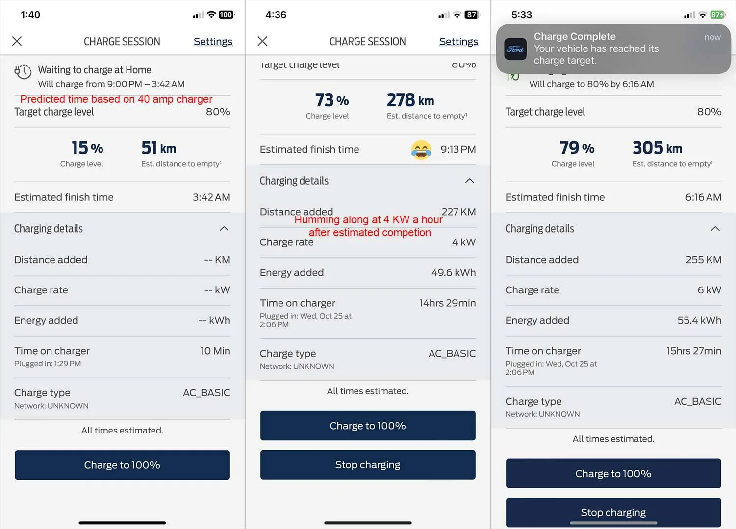

................ I need it confirmed or would love to see a steady 48 amp at your place as it would help in fixing it here. ...................
Along with this
Ford Mustang Mach-E L2 charging speed recently dropped 33% Untitled-1
Ignored. Not see myself running out to buy new chargers to test on my wiring as that does not get it fixed in an economic way. Was after a service update (same modules as power-up 6.6 and TSB charging cord stuck). Worked perfect till then.
