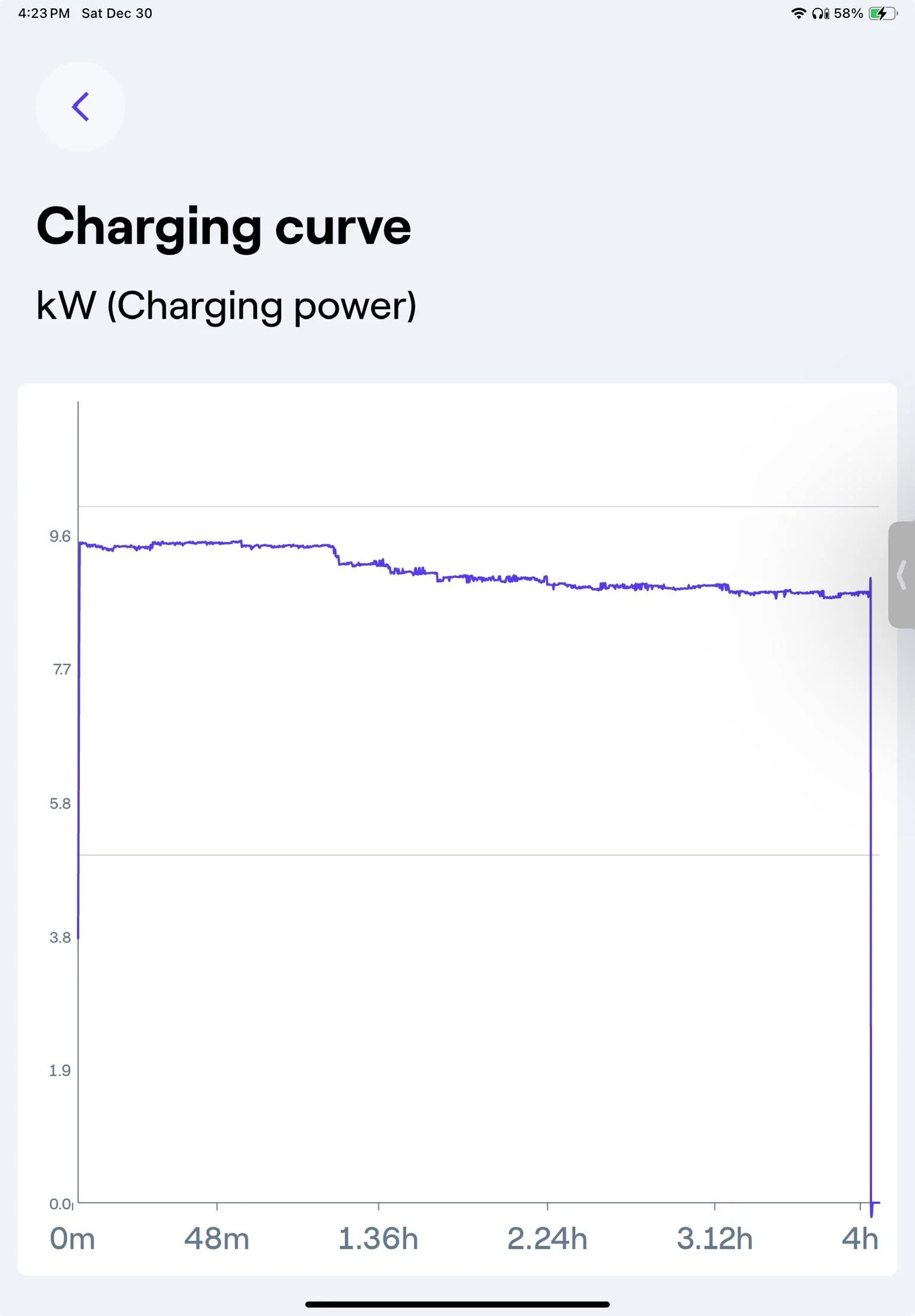

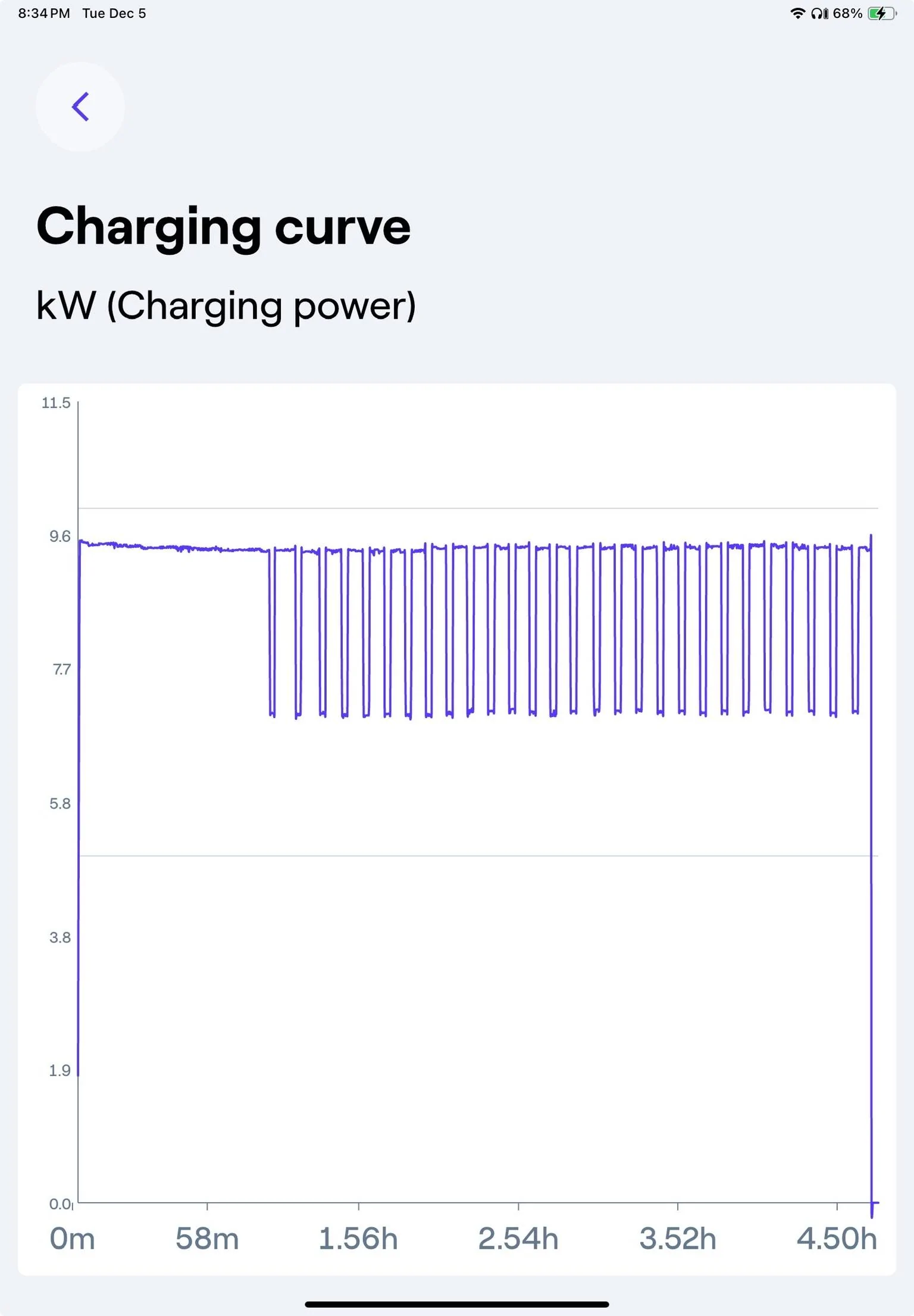

Update after PowerUp 6.6:
It appears that the update software changed the charge current derating from a sawtooth pattern to just an adjustment to a lower current or kw rate.In my case it dropped my kw rate from 9.45 to about 8.75. It's not what Ford advertised but it does not cause me issues that I can't live with.
Charge curve before update:
Ford Mustang Mach-E L2 charging speed recently dropped 33% 1703994951366
harge curve after update:
Ford Mustang Mach-E L2 charging speed recently dropped 33% 1703995066330
