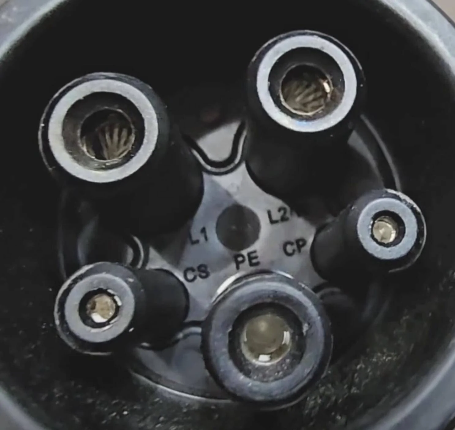

FYI this person replaced their JuiceBox charger with a new one, and it dropped their charge port temps by 15ÂşC/27ÂşF. The reason was because their J1772 connector had worn out contacts that were causing the charge port to overheat:
Ford Mustang Mach-E L2 charging speed recently dropped 33% Screenshot 2023-11-23 at 4.53.54 PM
See video, but the top two AC sockets are very dark/dirty/oxidized compared to the signal and ground sockets at the bottom, which still retain their normal shiny bright silver appearance. J1772 connectors do wear out over time and require periodic replacement. So you should consider your charging cable as a potential cause for the overheating in addition to the port itself.
