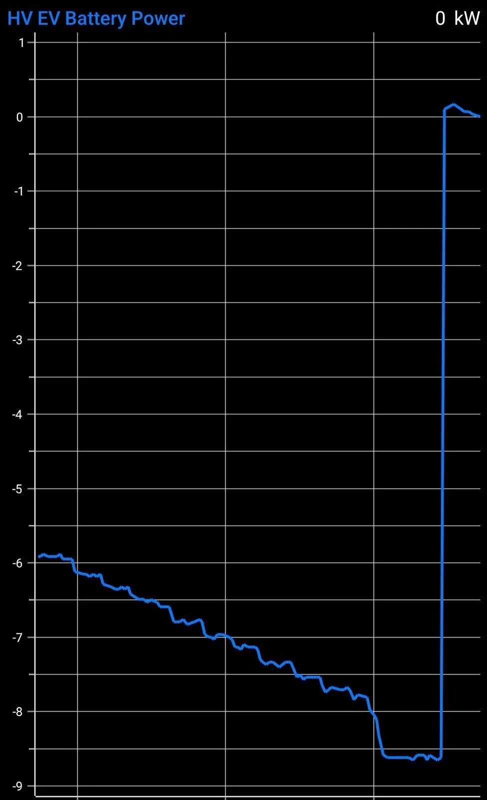

So my 40A charger, charges a Tesla just fine. Once I plug into the Mach-E, I get a charge fault and it wont even charge, unless I manually step it down to 32A. Tried explaining it to the dealer, but they want a $199 diagnostics fee to even look at it.
Did you ever get this resolved? I'm having the same issue, get the red ring at 40A, but charge ok at 32A. Using a Grizzl-E Duo shared with two other MachEs, no one else has a problem. It cuts off three times, then throws the red ring. Dealer wants to check the charger, which impacts the the other drivers who depend on it.
