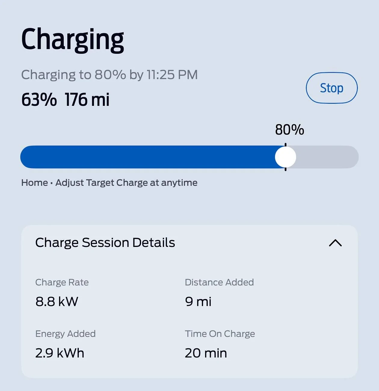

Ford Mustang Mach-E L2 charging speed recently dropped 33% IMG_1432
My EVSE is sending about 9.4kWh while the car is reporting 8.8kWh via FordPass. The difference is energy loss in the cars charging inverter. It’s not rounding.
Yes I'm sure. My fordpass app (both the old and the new 5.2) doesn't show any decimal places. The charge rate are always displayed in whole numbers and rounded down.
