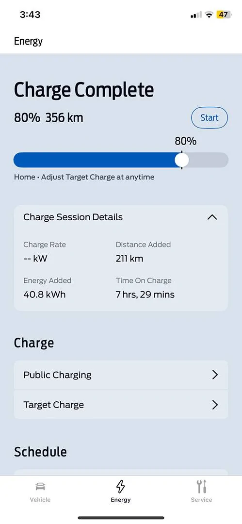

My dealer still refuses to acknowledge or address the slow charging on this vehicle. Indicates that there is a campaign right now and my car falls under it but it is on hold right now. Got that campaign in June 2023 that is when the problem started.
Charging last night. Do you think the app can not calculate 40.8/6.5 = 6.3 Kw/hr charging rate or is it just embarrassed and ashamed.

Still here with you Shayne. My car charges at the full rate on either grizzl-e. Wife’s car won’t charge above 6kwh on either. It’s a car problem. Not a charger problem. She never drives too far so she doesn’t really notice. But the car still doesn’t do what it is supposed to do. Complete BS on Ford’s part not even acknowledging this.

I completely agree with Rod (and anyone else) that it's a car problem and have mentioned this here several times before. I've posted my Emporia charge screens clearly showing that my Mach-E charges at the maximum 11.4 kWh while a couple of other Mach-E's that have been to my home, and I've had quite a few, will only charge at a maximum of 6.6 kWh or so. Very frustrating since sometimes they are only here for a few hours but have to stay longer just to get enough charge to get back home. Up until last month, we had no DCFC chargers in our town and the closest one was 40 min away in the opposite direction that most people would be coming from. We just got 8 V4 Superchargers so won't be a problem anymore when friends/members come here.

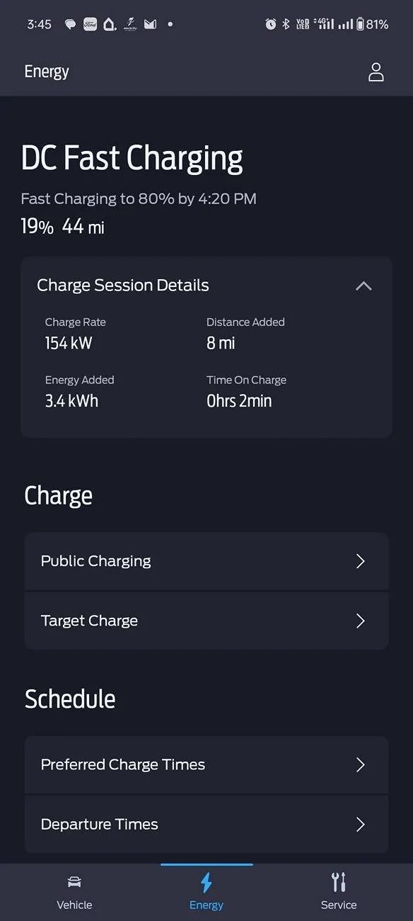

This issue affects my car too. It won't charge faster than 8 kW. Or at least that what the app shows it's possible the app is rounding down. I will test this via a code reader but have not had a chance to do so.
In good news it has no effect on DC fast charging. For reference that's EA is Scofield, WI set as destination in Ford navigation

The ford pass app rounds down. So if you're charging at 9.2kwh it'll show 8kwh in the app.
So if you're on a 40 amp 240v L2 charger, it should be providing around 9.6kw but the fordpass app will either show 9kwh or more likely 8kwh.
On my car when I charge at 43amps (it fails at anything higher), the EVSE is delivering 10.3kwh but the ford pass will show 9kwh.

I think it simply truncates. 9.2 KW would show 9, not 8. At least that’s been my experience.

Nope. If I use carscanner and monitor the charge, it's usually just a couple hundred watts lower than what my EVSE shows. So for example if the EVSE shows 9.5kw being delivered, carscanner will show 9.2 or 9.3 kwh going into battery. At the same time fordpass shows 8kw.

FordPass shows what’s going into the battery. A smart EVSE will show what’s going into the truck- it will be more than what FP shows.

Ok, I was getting only 7 barely are measured by EVSe, due to Mach E problems
