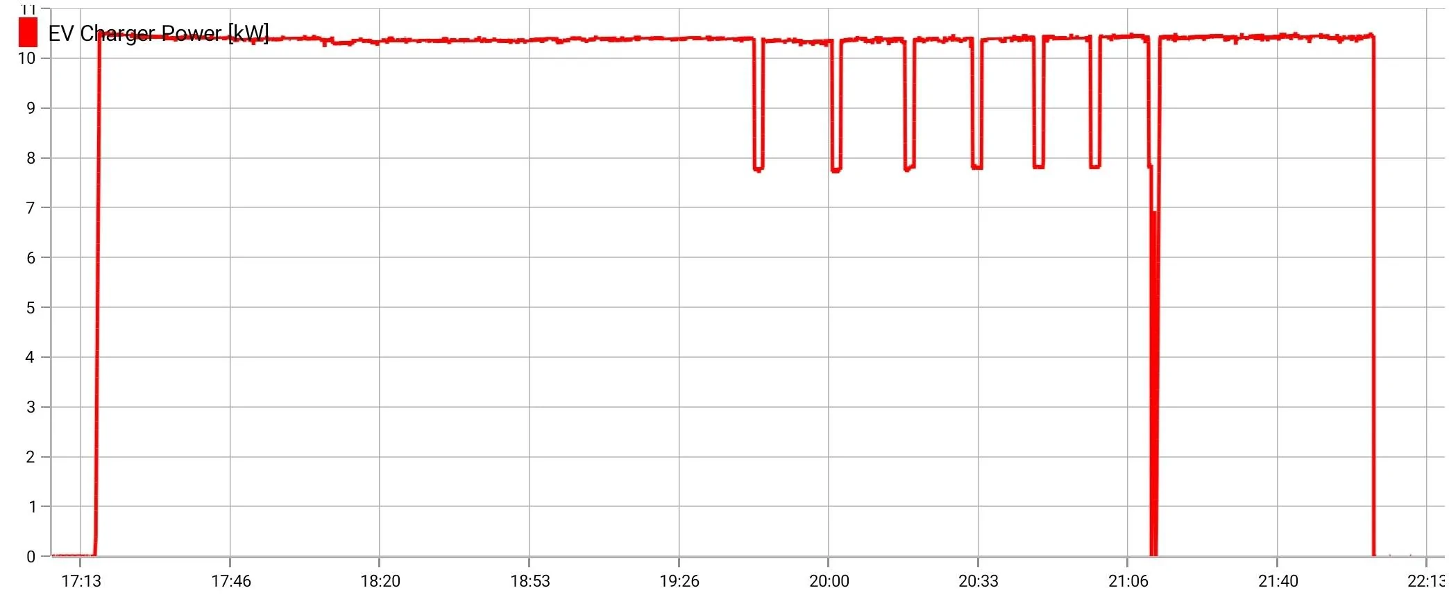

Lee, I did a test and I can't correlate the results to the theory you presented above, which I agree with by the way.
A while ago I noticed that the derating stopped when I turned the car on and off during the charge cycle. I thought that was strange, and I was able to do a test a couple days ago to confirm that is exactly what is happening.
As shown below, the charge goes at full power for a couple of hours, and then it starts derating in a very consistent 15 minute cycle. But then I got in the car and turned on accessory power (not main power).
Ford Mustang Mach-E L2 charging speed recently dropped 33% Screenshot_20231024-075938
You can see the big drop in charge rate for two seconds when I turn on/off accessory power. And you can see that the charge finished without any derating. It seems like if it really were just a temperature issue, the derating would have started again, repeating the 15 minute cycle that was occurring previously.
Do you have any ideas why this may be happening? It is hard to believe less than a second of no charge reduced the heat enough to allow the charge to finish normally. But I guess that could be the reason.

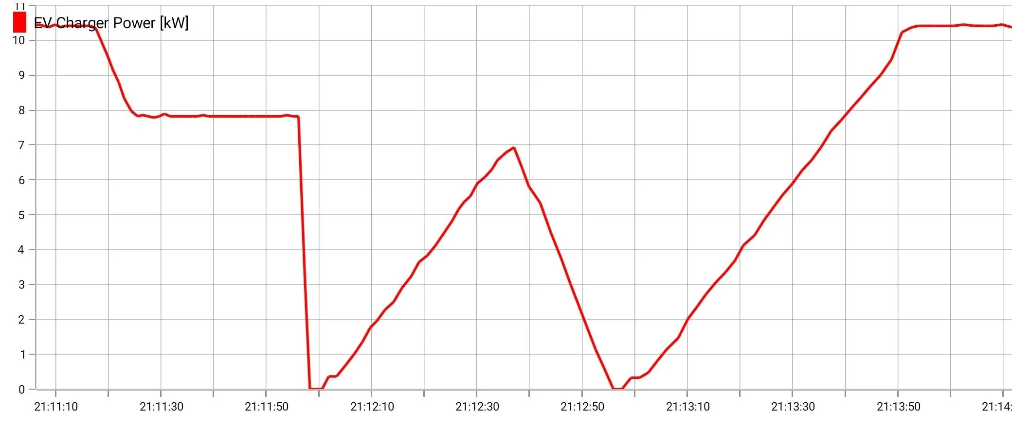

Here is a zoom in of the what happened to the charge rate when I turned the accessory power on and off. The interruption in the charge was very, very short.

Mike, it could still be a thermal issue with that data. Essentially what I see is yours is just barely at the point of overheating. From studying charge port temp data, what happens is it heats up quickly at first, and then much more slowly past about 30 minutes. The temp rise is asymptotic in nature (see graphs in video). So temp can still be rising very slowly after an hour. When they are marginal like yours, it can take an hour, sometimes longer for the port temp to reach derate threshold.
What I've also observed is the temp drop when charging stops is extremely rapid due to the kinetics of thermal dissipation (Newton's Law of heating/cooling). Stopping the charge for only a couple seconds can cause the port temp to go down 5-10ºC. And it can take an hour+ for the temp to warm back up that amount. A lot of people don't realize how fast the pins cool off, and how long they take to warm back up again. So in your case after that interruption, I'm fairly confident the port would have started derating again given enough time to warm back up, probably within 90 minutes after the restart. The temp threshold for accessory mode is not any different.
As an analogy, the charge port temp kinetics is similar to an airplane trying to reach maximum altitude, or a car reaching drag-limited top speed. It takes a very long time to reach the maximum value, but if the plane loses altitude or the car slows down, you're back a square one and it takes a surprisingly long time to regain what you lost.
This rapid cooldown is also why the derate strategy is so effective at controlling charge port temps.
People with worse damaged charge ports that overheat in 30 minutes or less will see the derating start again much sooner after a charging interruption. It's just hard to see in your case when it takes several hours of charging to warm up enough, the car is likely to finish charging before you see it again.

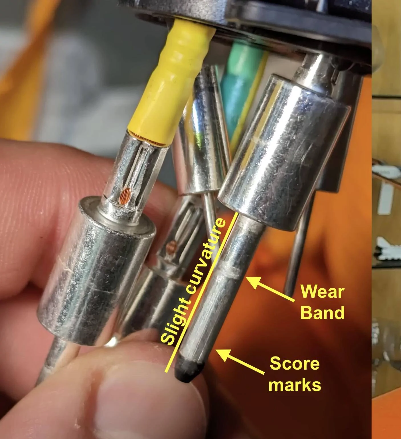

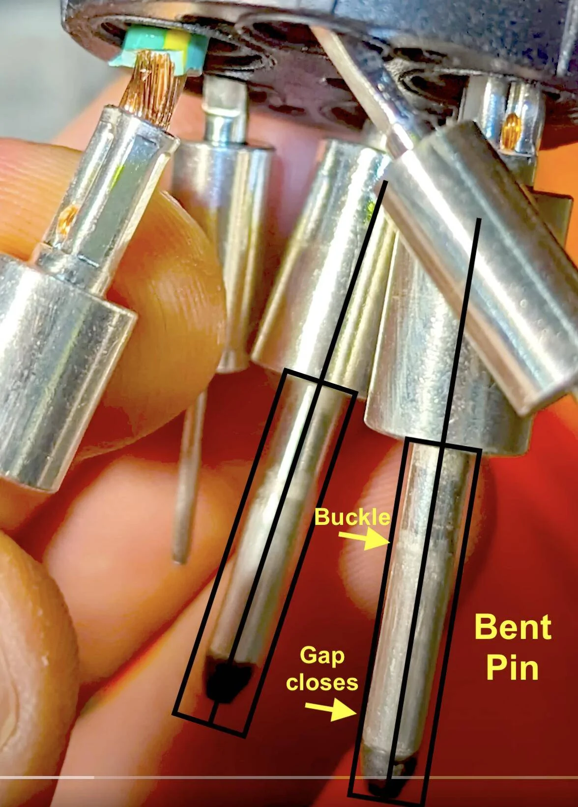

One thing I observed is his AC pins were bent ever so slightly. One pin is bent worse than the other, and you can see a slight buckle at the crux of the bend. There are also score marks on one of the pins.

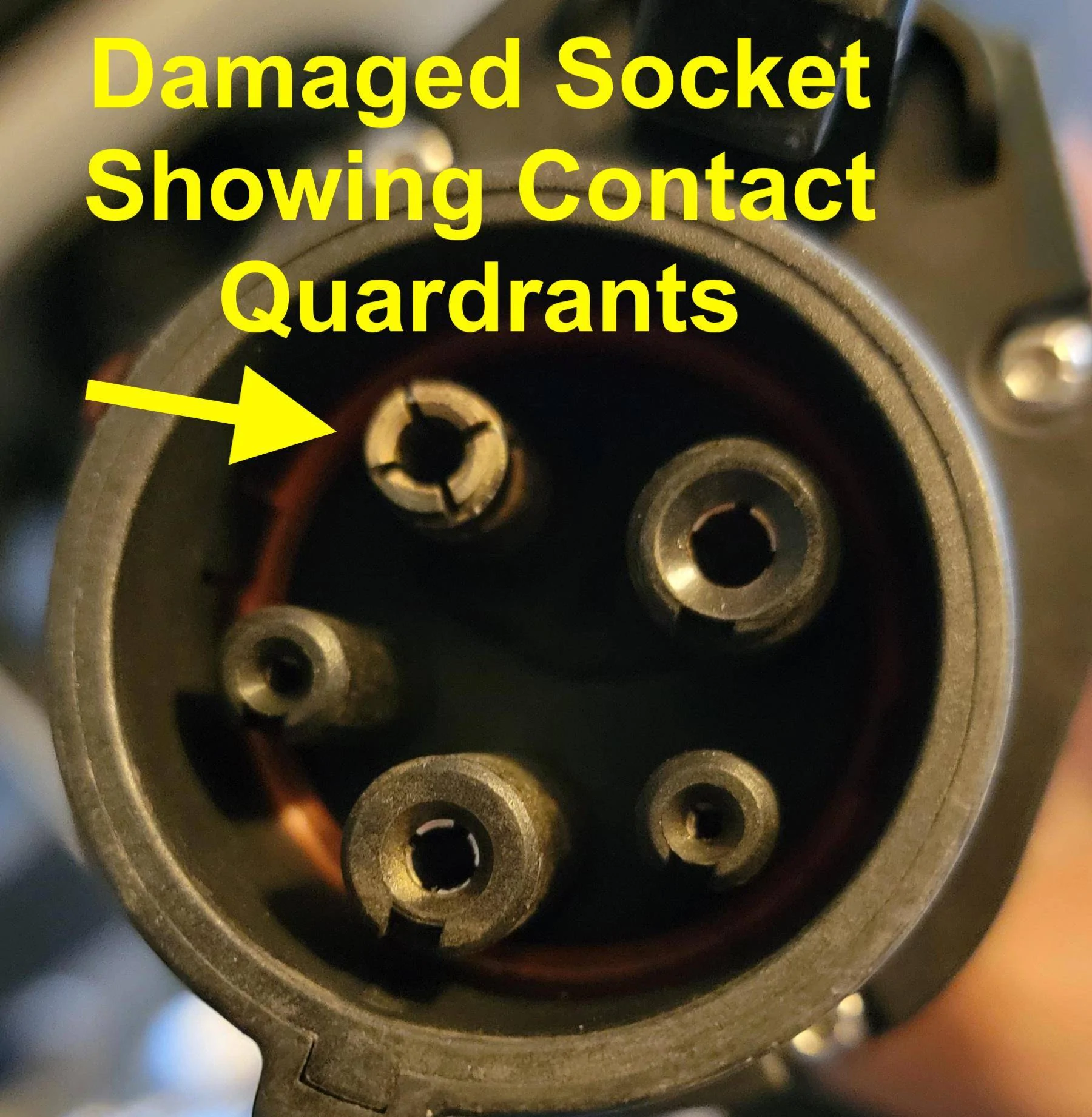

It is possible that bent pins could cause a poor quality connection (due to side load) that overheats. J1772 pins should be perfectly concentric so that there is equal socket tension on all four sides or quadrants of the female pin. A bent pin could reduce the surface area of contact (perhaps not touching one or more quadrants entirely), which could cause an overheat. The pins should be perfectly straight, smooth, clean, and free of oxidation for a perfect connection.
