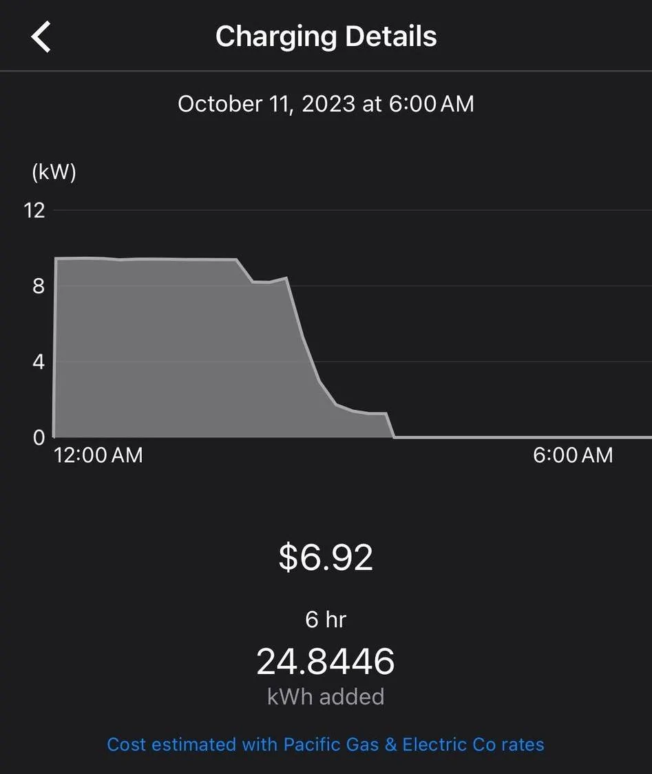

The charger was not slower over all, it just fluctuated. This was my last charge...
Ford Mustang Mach-E L2 charging speed recently dropped 33% Charg
It may not have charged long enough to get hot so its hard to say if the charger will fluctuate when we do a longer charge. It has been cooler but our garage is climate controlled so heat is never a big issue for us.

I take % charged x 88 KW / time in hours and it averages low 6 KW/hr. If it fluctuates I am not sure as I do not have fancy graphs just need for when I plug it in it charges as spec'd. Bugs me it did for 2.5 years but not anymore.
11,373
25,044
That is normal taper if you charged to 100%.
