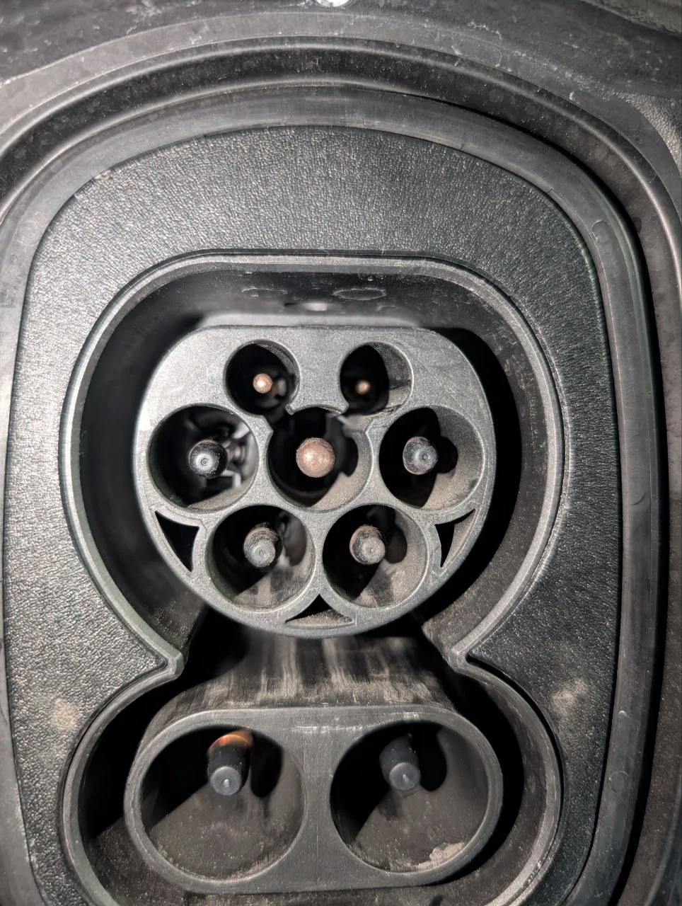

Hello! I'm having an issue with fast charging, would appreciate any help.
Ford Mustang Mach-E 2021 AWD Long Range
Problem
  • L3 (DC) fast charging stopped working
  • L2 (AC) charging works without any issues
  • When connecting the DC charging cable, the cable locks in the port mechanically
  • After the charging process starts, the indicator near the port doesn't turn blue, it simply goes off
  • The charging station shows an error indicating the cable was not connected to the vehicle
Additional details:
  • Two days ago I was still able to charge successfully on a road trip
  • Yesterday the charging stopped working
  • Tried several different DC stations, including one where I definitely charged before
  • I checked the connector - it looks clean and without any foreign objects. The only thing is that one of the upper pins is shorter than the other.
Software version: SYNC 23095 / Revision 807
Has anyone had a similar problem and how did you solve it? Is this a software or hardware issue?
Thanks in advance for your help!

If Mach-Lee's suggestions don't work, the whole charging port may have gone bad. I had the reverse of your problem with my 23 MME - it would charge on L3, but not L2. The dealership had to replace the port under warranty.

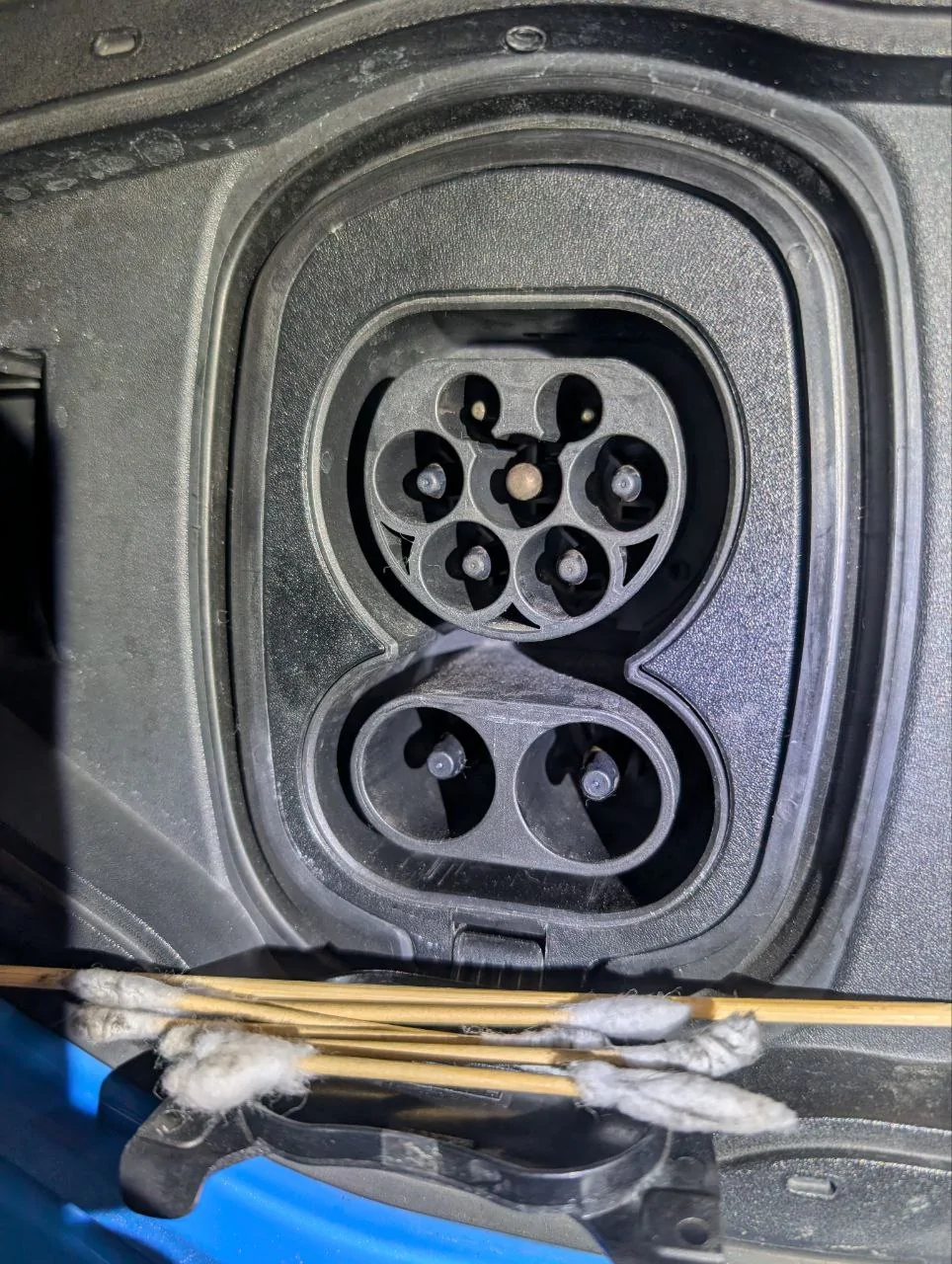

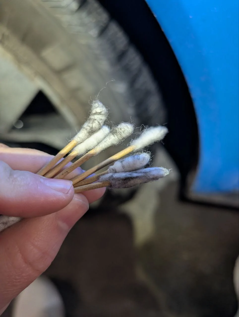

Hi. Thank you for your response.
I tried turning off the car between charging sessions - it didn't help.
Honestly, I didn't believe in cleaning the charging port because it looked quite clean visually.
Yesterday I quickly cleaned it and went to a station and the charging started.
Today I cleaned the port more thoroughly and went to another station and the charging successfully started again.
I don't know what helped, but it looks like the DC charging is working.
