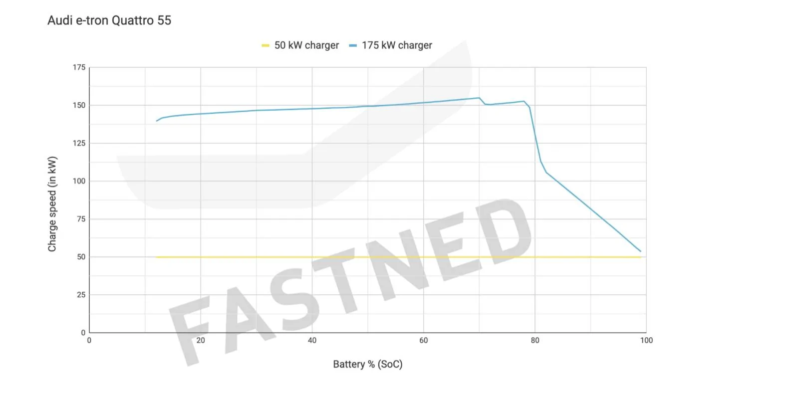

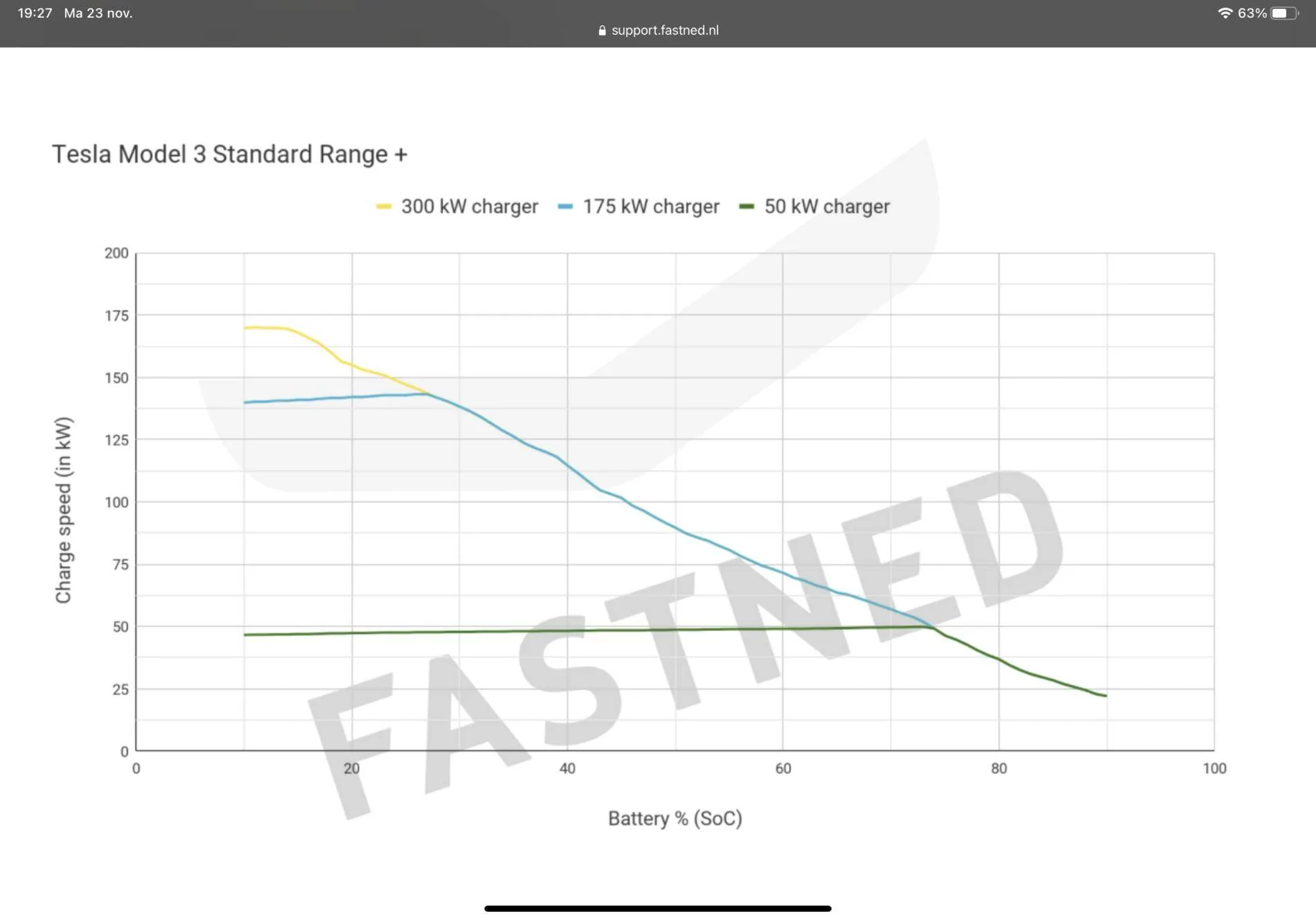

It is NOT about peak power but about average...
That graph really bothered me, It just didn't make sense. So I did a little research. Look closely at Audi's battery warranty. Just about every other manufacturer warranties the battery for the same time and mileage, but they also include a performance warranty. The warranty for most everyone else covers the battery if it drops below 70% capacity. The Audi warranty makes no such claim. If the battery fails completely, you get a new one. If it drops to 25% capacity, too bad so sad. IMHO, that's precisely why they can implement a charging curve like that; they aren't on the hook financially when that charge curve massively degrades your battery. There is a reason everyone else tapers the charge, and it's a good reason.
Where did you find Audi's HV battery warranty details? I've been looking but can't find it. But this guy at Roadshow claims it covers at least 70% capacity for 8 years, 100,000 miles.
Hyundai tapers charge, but does not indicate a performance threshold in its warranty as far as I can tell.
They just state that when there is a failure warranting repair at their cost, they will install replacement parts that provide at least 70% of the vehicle's original capacity. That's not a very strong warranty.
It might be incorrectly worded... I see some grammatical issues in the same paragraph or just above it.
I Just picked the Audi graph because it is a big difference, but there are more who have a more of less lineair graph until 80%, the BMW I3, Mercedes EQC, Mini electrick. A court in the EU would not defend Audi if the battery was down to 50% and they would not replace your battery under warranty.
Tesla starts very high (they advertise with these values) then starts tapering immediatly, so what i claim is that it's average that you want to know instead of peak power.

Here's an article, scroll about halfway down:
Audi review
Other than that, Audi's website doesn't mention a performance warranty anywhere. I can't find the fine print, so I'm trusting that article. But if Audi doesn't explicitly give a percentage of capacity left, then the only thing they're covering is that the battery works. That gybes with the charge curve, because that charge curve is going to degrade your battery. It's very nice for owners who sell their car in two years, but the next owner is going to be in for a rude awakening.
You're absolutely correct. Higher average charge power should result in shorter charge times. IMHO, It will also be more expensive because charging will be less efficient due to more waste heat being produced. Time will tell how well the batteries hold up, perhaps they have a revolutionary battery chemistry. Myself, I wouldn't buy one. But that's just me.
