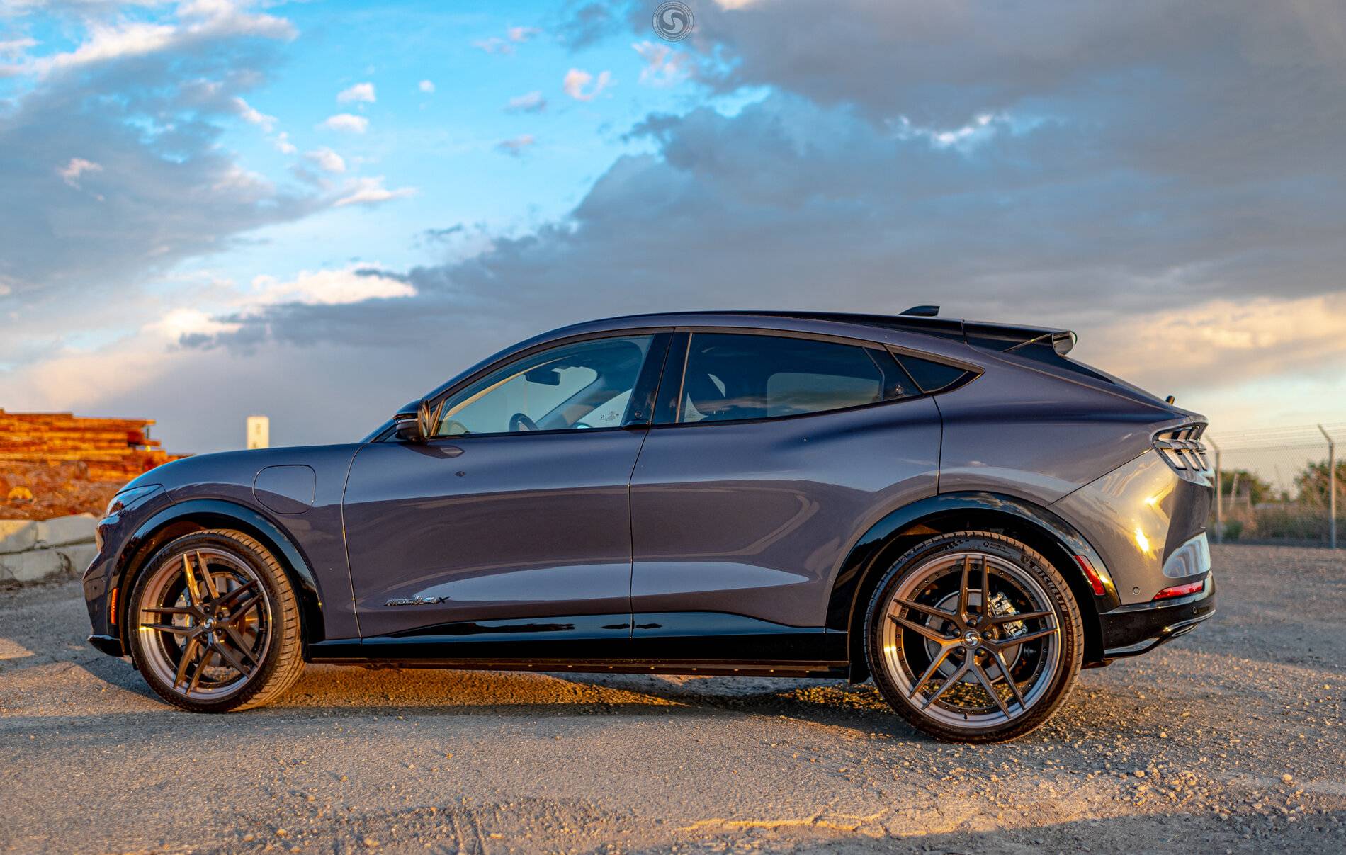

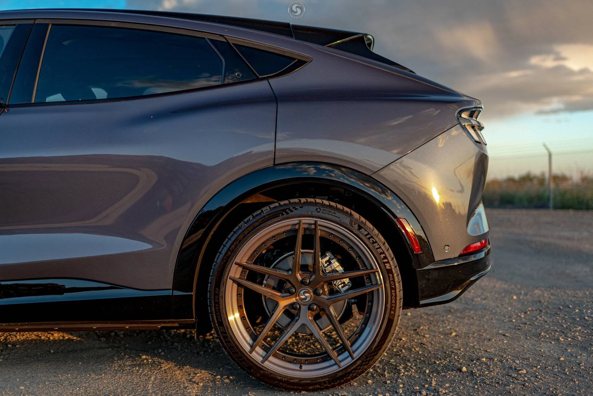

In the process of developing a lowering spring for the Mach-E. Needed to get my wheels on first to see the overall change. I Currently have the OEM springs being tested and need to settle on a ride height and rate change.
I have found the Premium AWD Extended Range springs to be fairly firm for the street, but needs a little more for the track. Spring rates appear different across models.
Big question is how much of a height reduction do you think it needs? And would you want them any stiffer? Let me know your model and thoughts.

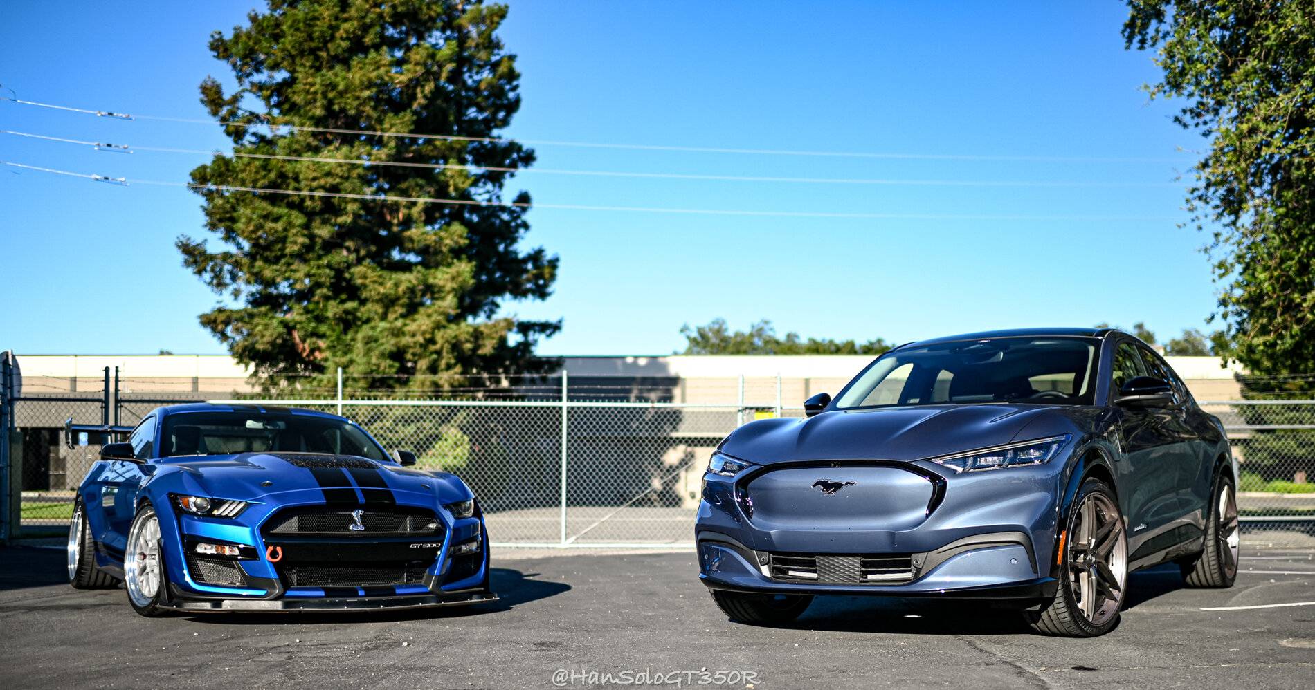

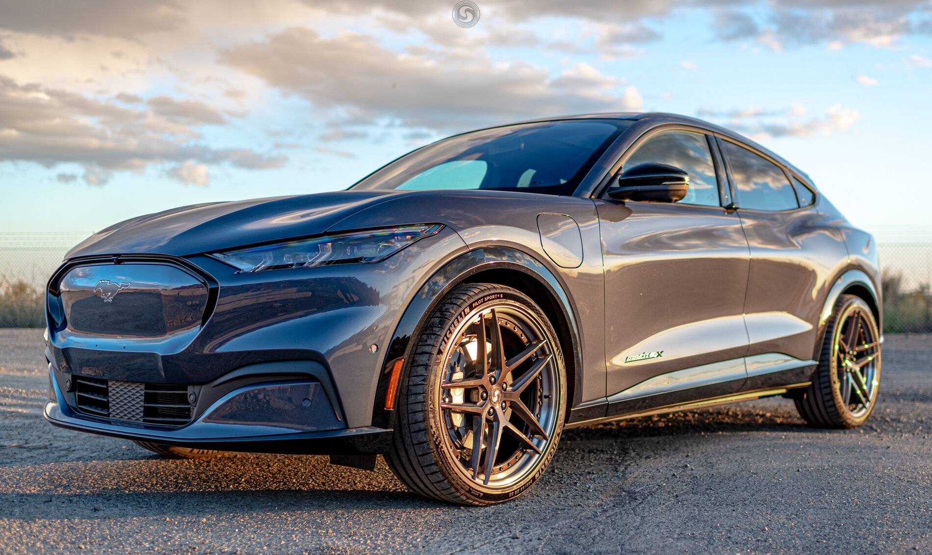

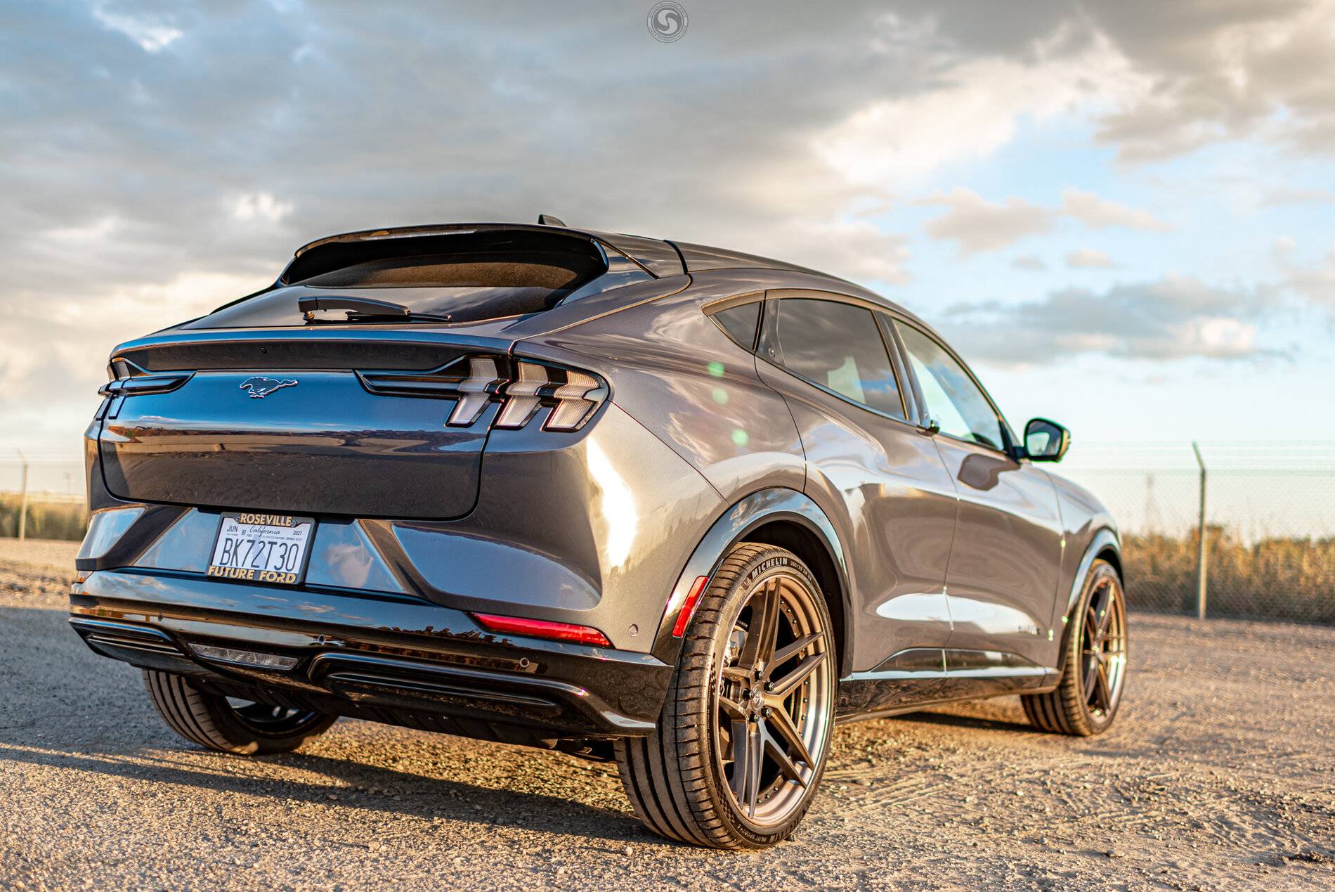

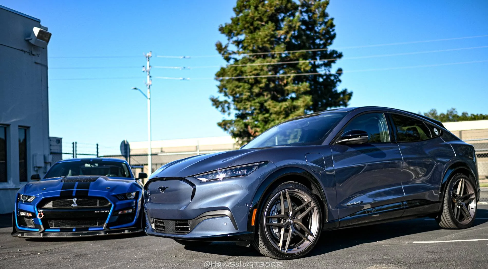

I know a few had mentioned a fear of lowering their Mach-E. I got both my cars together today and snapped a couple pics. At least some of you will understand why lowering my Mach-E leaves me without any fear after driving the GT500 around for 10k miles.
Ford Mustang Mach-E Mach-E Lowering Spring Development 8F9ACF4F-F62A-4F9C-8DD6-E0EA1F8D2252
Ford Mustang Mach-E Mach-E Lowering Spring Development D0A61E8A-D7F2-485B-A8CC-B48C52B32B55
Ford Mustang Mach-E Mach-E Lowering Spring Development 9B0AFB38-99B5-4F6F-AF33-7DA5F7DABB9C
