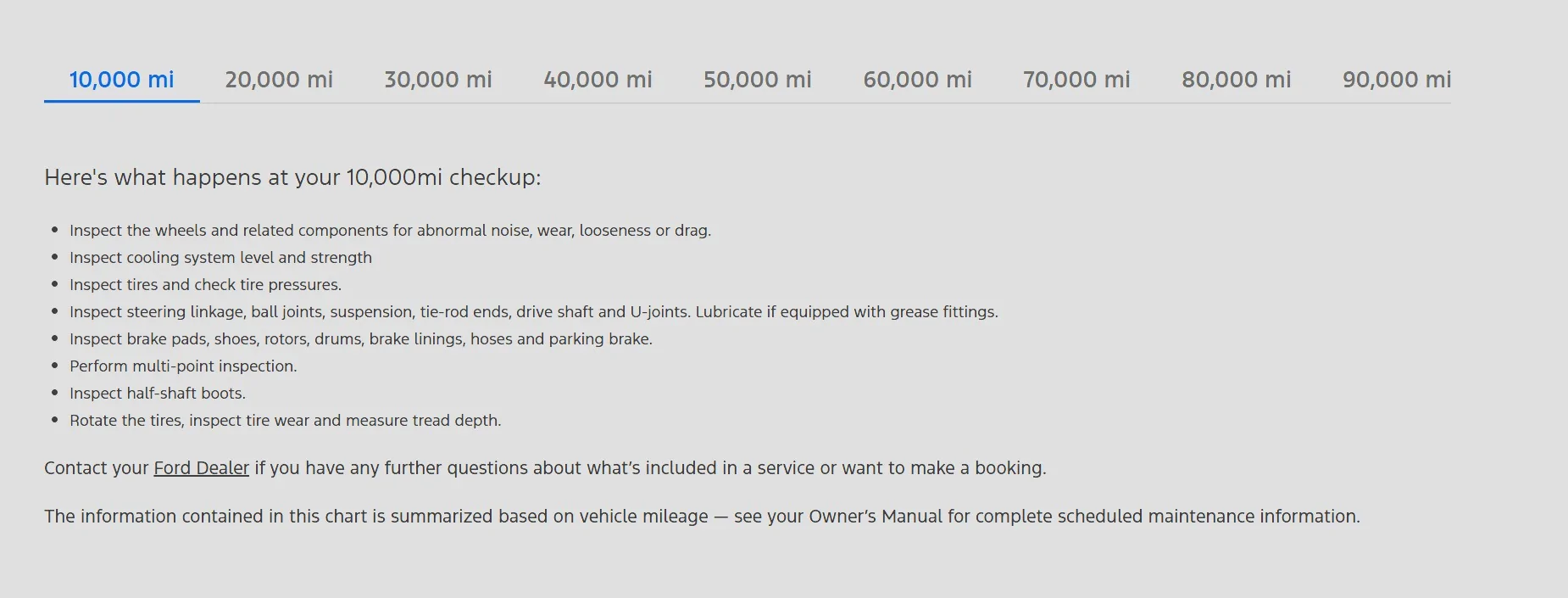

Hi, yes, you’re right. I just haven’t been able to find the exact maintenance interval in the owner’s manual. What I understand is that it’s every 10,000 miles or once a year, but I’m not sure exactly what is included in each maintenance service.
In the Ford app, they do recommend tire rotation, but they don’t necessarily recommend wheel alignment and balancing as part of the regular maintenance.
Regarding the price I paid, I did complain to the service advisor, and I also mentioned in the service survey that I felt the price was very high for just the tire rotation, alignment, and balancing. I also complained about the additional services they quoted me for.
Could someone please share the section of the owner’s manual that explains the recommended maintenance schedule and what is included in each service?

Always remember that dealerships are going to charge you way more for services. $100 - $125 for an alignment is common. Like others have said, you can get a cabin filter for cheap. At 30,000, looks like brake fluid needs to be changed, that will be around $150 - $250.

So, can the majority of 20k items be done at home?
  • Rotation- if equipped at home, sure.
  • Inspect half-shaft boots.: probably not.
  • Inspect cooling system level and strength: probably not.
  • Inspect steering linkage, ball joints, suspension, tie-rod ends, drive shaft and U-joints. Lubricate if equipped with grease fittings: nope, not at home.
  • Replace cabin air filter, if equipped: for sure at home.

Engineer (retired)
