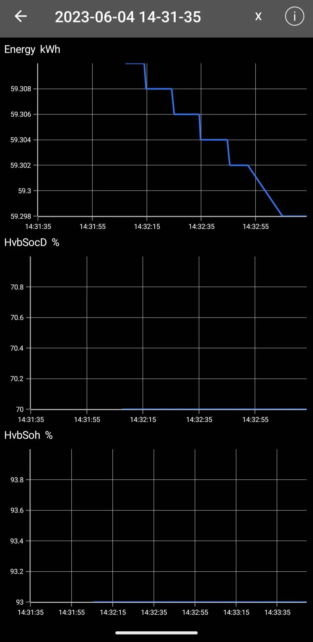

Those numbers look about right and would be in line with most of the people on this forum. If they are both charged to 100% right now that would be the best time to do the math again because the car is full, and won't accept any more electrons. Then it's just a matter of seeing what is reported as energy to empty vs what a new pack is and divide the two. (i.e. 89/91).
Like I said in another post, there were a lot of people saying that the SOH was bugged in car scanner and showing 100% regardless. It didn't appear to be for everyone so maybe it was adapter based, I'm not sure (I'm using VeePeak). Doing the long hand math isn't perfect either, but it's as close as we can get. In my case, car scanner showed 93% SOH and the long hand way validated the same number.

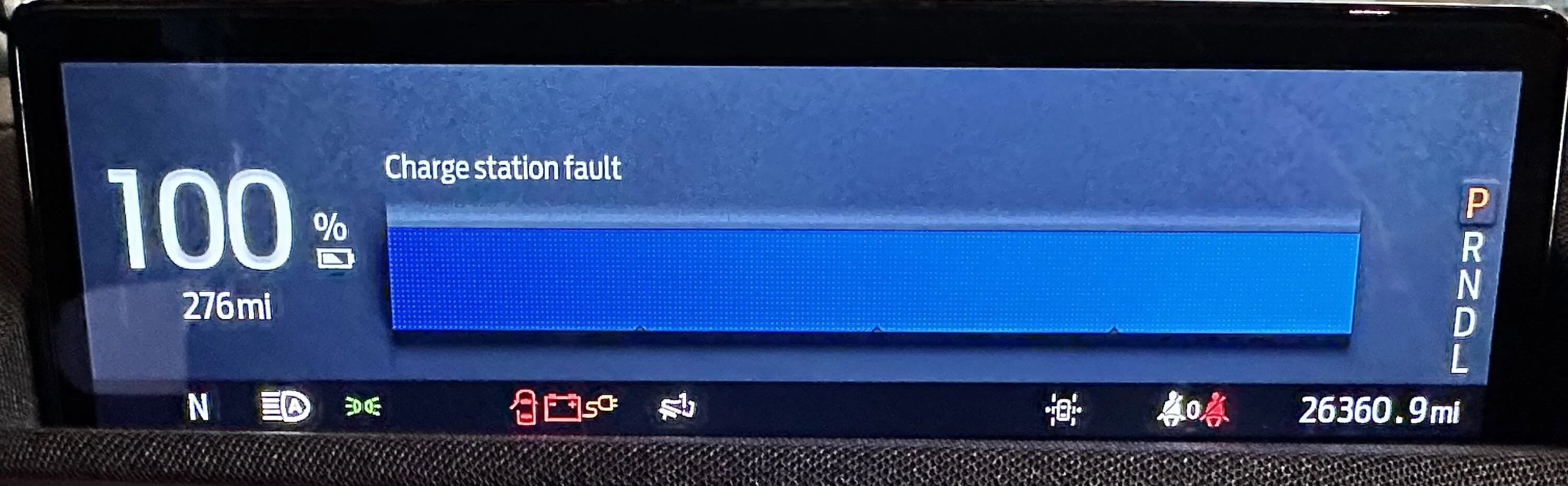

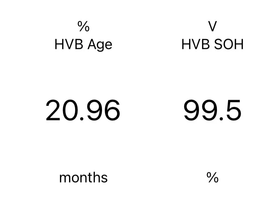

26000 miles and 99.5%
