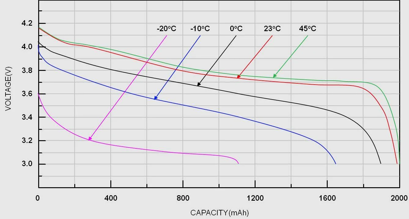

I do not know if I follow you here. Yes the battery capacity may be somewhat reduced (when the battery is extremely cold and not actively heated, but the battery is heated by the climate system when driving to make sure it has ample capacity most of the time. If you plug in and precondition, before departing, keeping it warm, I dare say you have 88 KWh to start or close most of the time. I did a test (while sick in bed from my Booster shot, Yuk). It was 55 degrees when I felt great and I left my Mach E at 75% unplugged for 36 hours. It cooled to 30 degrees the next day and last night/this AM was 24 degrees. This AM I still had the same range and the same 75% battery capacity. If the GOM was taking into account the ambient temps adjusting for battery capacity loss, I would assume it would have lost range.I'm afraid GOM's calculations are closer to reality than yours.
The efficiency (2.4mi/kWh) is measured based on real miles and real power consumption, not the battery capacity. The battery capacity in low temps is significantly lower than the nominal 88kWh, according to GOM it's about 68kWh.
There is only way to know the exact range is to drive from full to empty.
I still do not trust the GOM at all in cold weather yet and it seems very pessimistic, I believe, to protect the driver from ending up stranded. But I did some more calculations to verify below.
Some real numbers from that 18F Trip which was at an average speed of 60.5 MPH and interior climate at 70F. What I have determined is the GOM is about 5-10% off from reality. I drove 113.4 miles starting at 93% (81.8 KWh, preconditioned) battery and ending at 29% (25.5 Kwh). So I used 56.3 KW for the trip and overall real mi/kWh of 2.01. The efficiency calculation in the car reported 2.3 Mi/kW. When I departed, the GOM reported 161 Miles of range @93%, which would be 173 at 100%. In reality from this trip, it was actually 2.01*88=177 Miles, so a 4% GOM error. (but that was actually based on past driving , not this trip) At the end, (29%) the GOM reported 46 miles of Range, which in reality was 2.01*25.5 kWh=51.3 miles (10% GOM error). Now 93% can be 92.5% to 93.4% and 29% can be 28.5% to 29.4%. So assuming the best, that could be 55.5 KWh or 2.04 mi/kWh a range of 2.04*88=180 miles at 18F, highway speed of 60.5 MPH.
So we can assume the car was either off by 0.3Mi/kWh in efficiency calculations reported OR the battery capacity was reduced due to the cold weather by 11 kWh (12.6% capacity loss, 2.01/2.3) at 18F.
