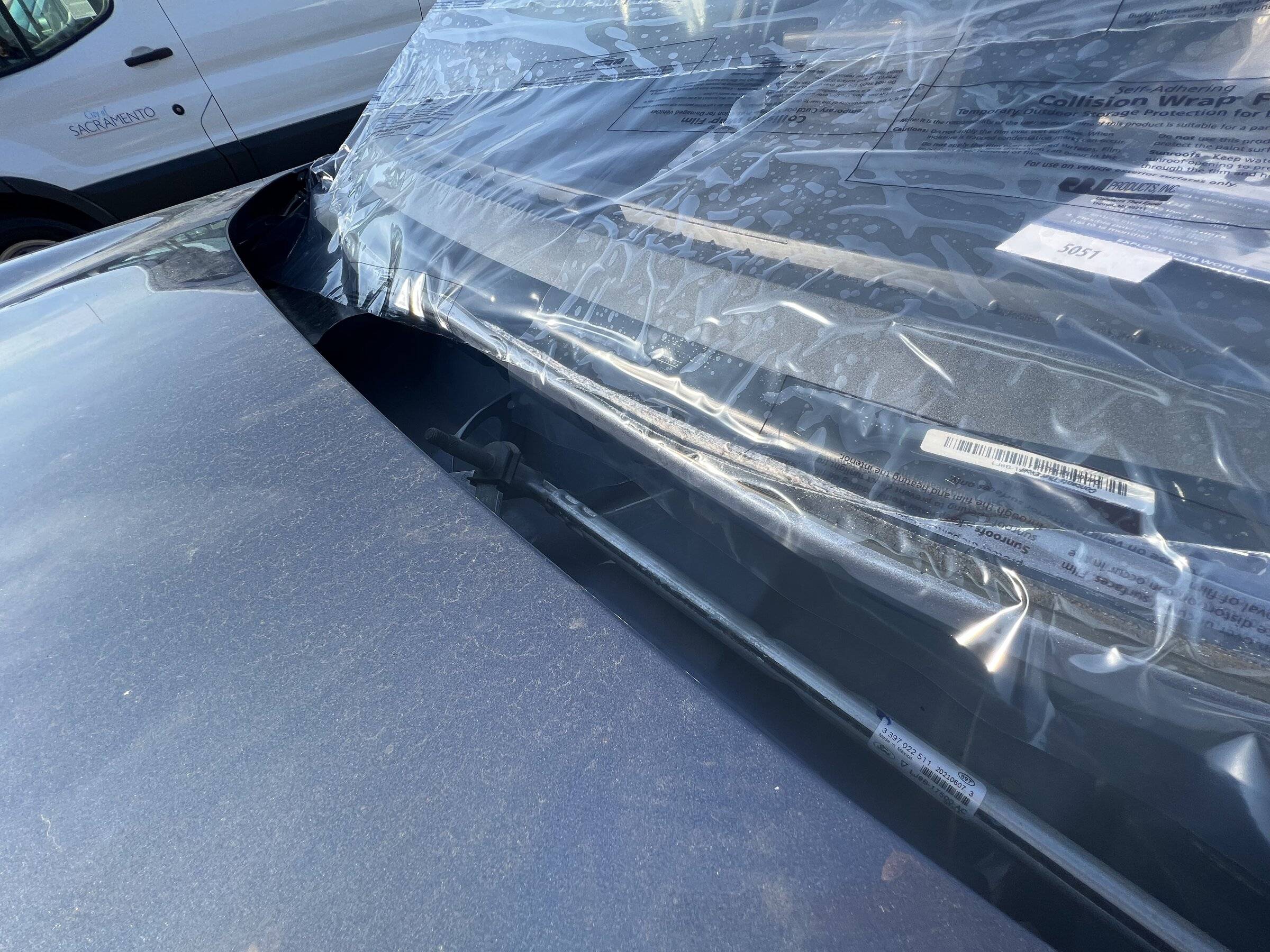

Careful with the glass update… when they did mine, the glass removal machine malfunctioned cutting into the metal of the car. That added another week to the update.
Ooooh, that would suck so much
