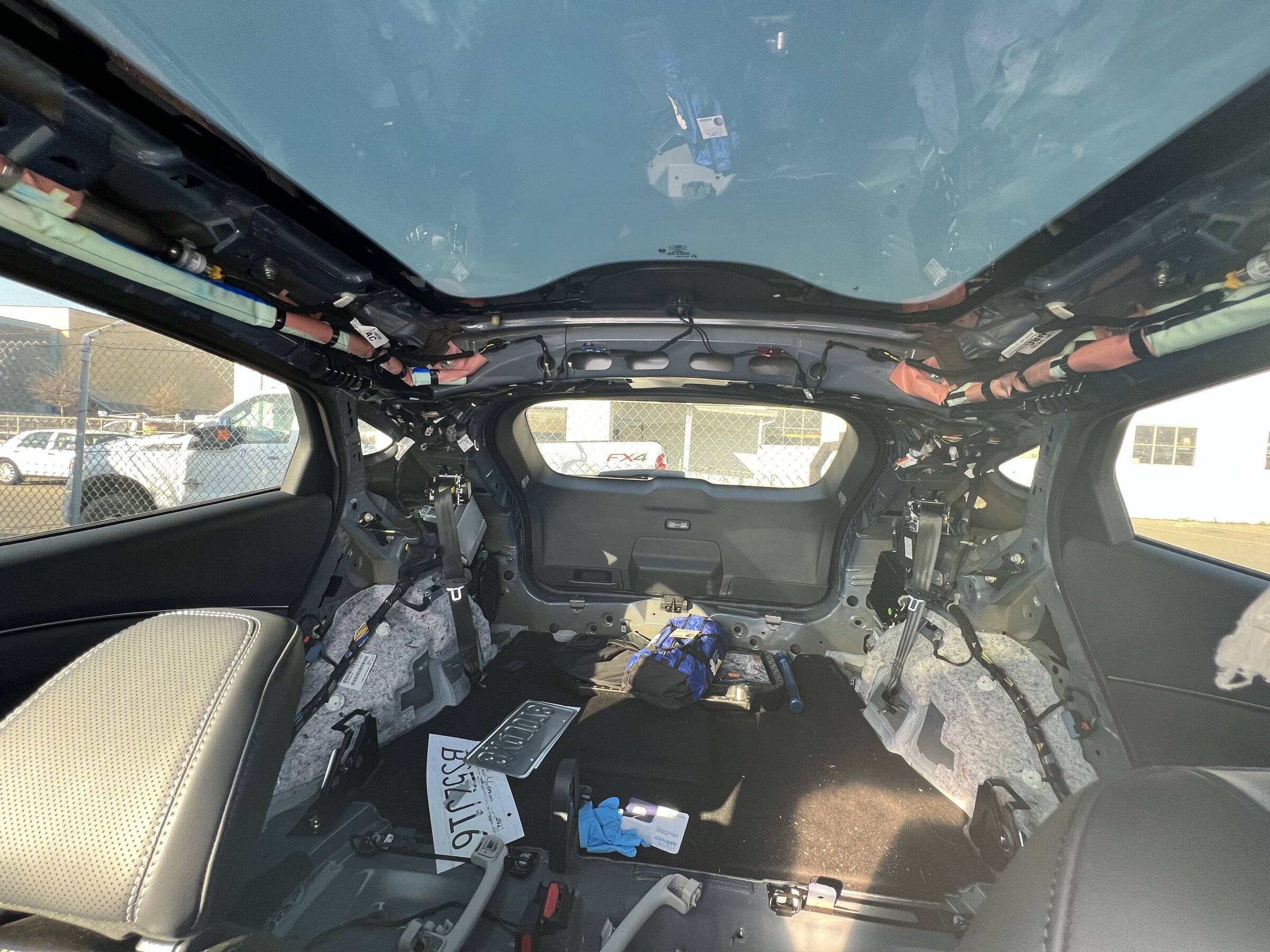

Careful with the glass update… when they did mine, the glass removal machine malfunctioned cutting into the metal of the car. That added another week to the update.
Why is the entire inside of your car removed? Even if they removed the windshield improperly, cutting through some metal, that would not justify removing all the interior panels and carpeting.

Wiring affected? Either way, pretty cool to see the interior with all of the bits removed.

I know they have to remove the headliner for the glass roof if it’s needs to be replaced, maybe they saw an issue or maybe they don’t know what they are doing

That's way more than the headliner.

I saw one at my dealership ready to go out to glass (after mine was already complete). I'm thinking many places are removing more then needed... Not sure why...

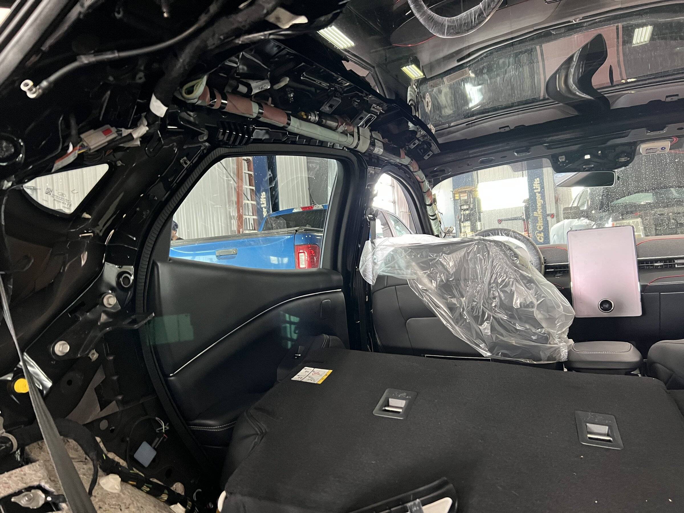

The photo with the headliner removed looks correct. In order to get the headliner down and out, all is the trim on the a, b, and c pillars must be removed. In order to get the trim off the b-pillars the scuff plates have to be removed. And in order to get the trim off the c-pillars, the rear seat backs have to be removed. Because of the way the trim pieces overlap you’ve got to remove a serious amount of the interior to get the headliner out without breaking it. And you don’t want them resealing them roof with the headliner still inside. That would not go well.
This was my car when it was in for the roof reseal:
