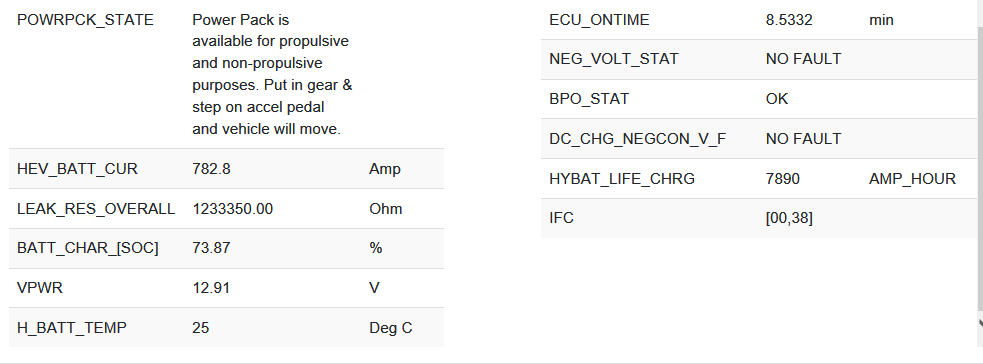

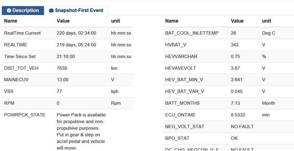

This is the snapshot from when the failure happened, if anyone is curious.
Ford Mustang Mach-E POST Recall Software HVBJB Failure 1657233530466
Ford Mustang Mach-E POST Recall Software HVBJB Failure 1657233562656

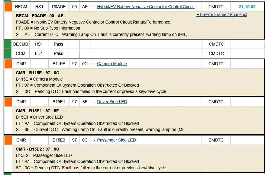

I am a bit concerned they now won't even replace my HVBJB. They had a few DTCs when they hooked the car up. They did a Self Test and cleared them all, they all cleared as @scoopman also noted. They still went ahead and updated the CMR, CCM, IPMA, PSCM, GWM and reset SYNC a billion times... even though my car is already fully updated.
Self Test is passing... I certainly hope they aren't about to call and say it is ready for pick up because the DTCs went away!!
Ford Mustang Mach-E POST Recall Software HVBJB Failure 1657233588735

Well, this is a cluster of fuck shit. The shop foreman called me and insisted the car is perfect. He drove it for a few miles and the DTC didn't come back. Thanks to @Mach-Lee I read for him what the workshop manual states for the DTC that was present, P0ADE, and that he has to drop the pack and check. He was clearly taking offense, just like @scoopman is experiencing, and saying the "owner's manual" is a lot different and doesn't tell you everything and he's just going by the book... I kept saying this is the explicit workshop/service manual he has access to. Put in my DTC and you'll see. "Well, it's gone now, if it comes back when you drive it some more, then I can do that. I'm just trying to protect the dealer and make sure we get paid. If I just drop the pack, Ford won't reimburse us a dime." I explain again, no dice. He says he'll try and drive aggressively tomorrow on the 73 to try and trigger it himself.
What the ever living hell. I told them to call the hotline when I dropped the car off and told him to again this time. He said they're closed now, but he'll call tomorrow and only if the DTC comes back will he call them.
Talked to the service manager, he said he'll look into it but has to go by what the shop foreman says, he knows the car better than anyone else.
The instructions for P0ADE clearly state that when you get that DTC, you must replace the HVBJB.
See here, make your dealer look at their Service Manual, it was just updated.
