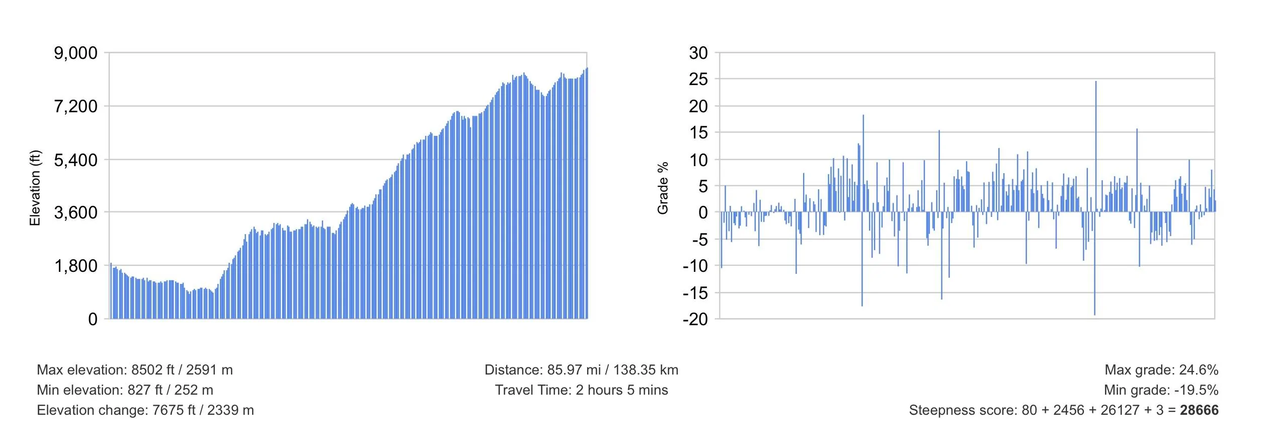

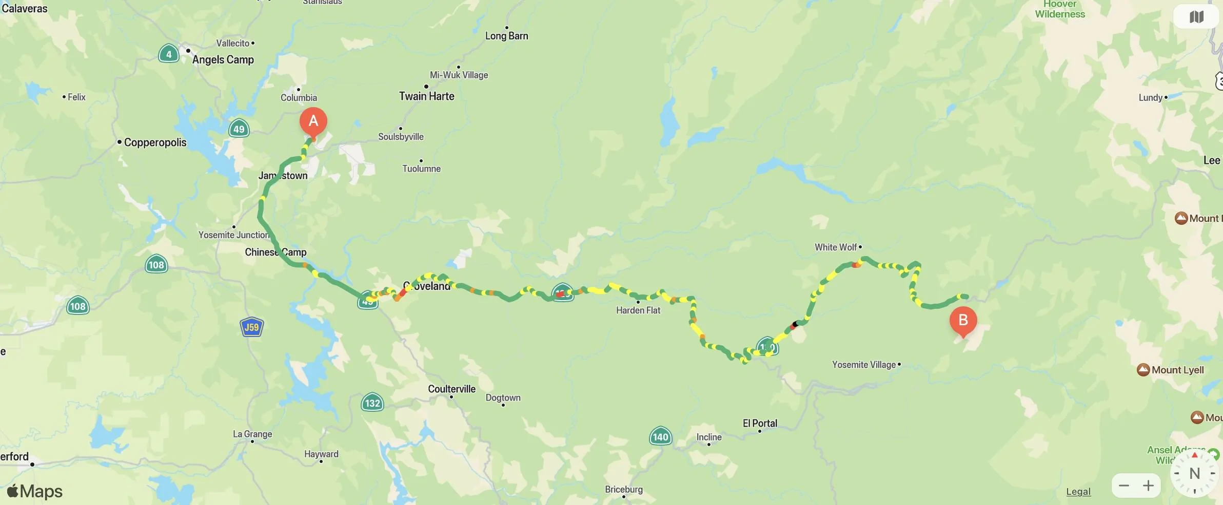

I drive these 3 routes every week. I can almost guarantee that if I flash this software I'll get failure if it's based on elevation changes:
Altamont Pass:
Pachecho Pass:
Echo Summit:
This is my route up Tioga Pass Road to Tuolumne Meadows. I hike out to upper Yosemite falls starting at the Yosemite Creek Campground. Tioga Pass is only open during the summer and I have been up here twice so far this year (both last month). I just had the software update done last week and will be driving out there again at the end of next week. I will certainly report back if I have any issues.
