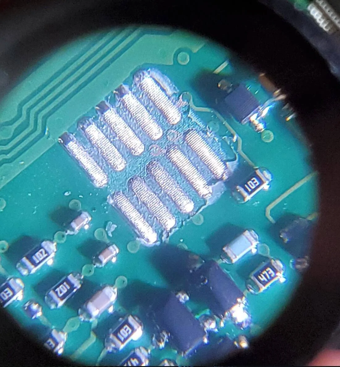

Simple, pull your IPMA out, open up, zap the LIN chip pads with a fiber laser to remove the corrosion protection coating, drop some solder paste and the LIN chip on, hit with heat gun. Done and done.
Here's the lasering of a TCCM with similar coating for reference
And the result -- ready to solder

LIN is a low speed type of bus. There's quite a few of them in the vehicle. Ambient lighting? LIN, ultrasonic sensors? LIN. The APA that's missing is simply a single LIN bus chip in the IPMA. You can buy the little chip and solder it to the board and like magic the 4 corner side firing ultra sonic sensors are alive. I wouldn't suggest to do it if it hasn't already been done.
All of the APA deletes across the sync 4 platform is simply a ~3$ LIN chip missing from the board.

Yes, it's a single chip that's missing from the board. I could find the actual part if someone wanted to do this. The fix is confirmed to work. Everything else is present, ford just left one little bus chip off of the board probably due to constraints with china covid shutdown. The toughest part for the person that did the mod was getting through the corrosion coating. I have a fiber laser and it blasted right through it. Well to be clear, it vaporized the metal below the coating blasting the coating into dust. Light tends to pass through most clear things with ease. This is also a likely cause of ambient lighting vanishing too as every single ambient LED listens on a LIN bus.
Given sync's use of this company's products, it wouldn't surprise me to hear this is the chip
https://www.nxp.com/docs/en/data-sheet/TJA1020.pdf
More info on LIN. No need for the ultrasonics to be on the can or ethernet busses in the vehicle. LIN is used for very low speed coms and talks directly to the IPMA instead of being on an HS or MS bus like the radars and similar features.
Other places where LIN is used is between mirrors and DDM, the window control buttons and the DDM, and any button assembly in the vehicle not shown as a module on a can bus. Think headlight switch, etc....

Not sure if it's the same as was on that TCCM -- that was some kind of silicone like substance it was dipped into. Jesse said he couldn't scrape it off without damaging it and sent it to louis rossman to have the chip installed. I understand not everyone has a $5k fiber laser to zap it with. I had it at its minimum power level to do that. At full power it will just vaporize copper traces.
I'm sure a slow steady hand could do it, might be too tedious for some.
