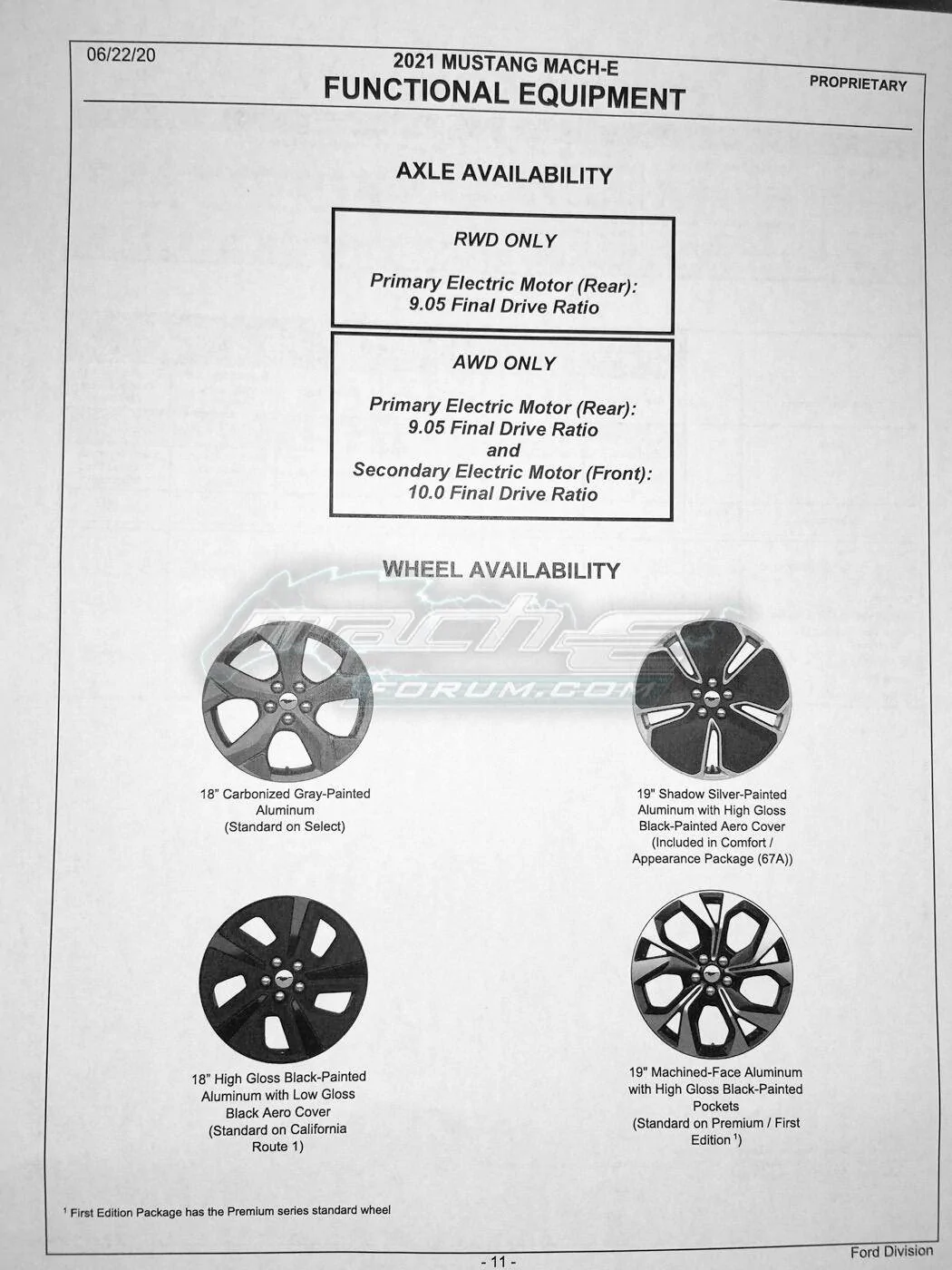

Does anyone else think that Ford might be using a different final gear ratio for highway efficiency? It would make sense that they are sacrificing low end for highway cruising speed. It would be cool if the front and rear motors are geared differently so Ford can switch them for maximum range. It'll be like the Taycan 2 speed.
Each motor/differential is a fixed gear ratio, but yes, with AWD the front is geared different than the rear. Hopefully the computer shifts more of the power to the front during high speed cruising.
Thanks for the info. Isn't a higher final drive better for low speeds and not high speeds?
Tesla's drive ratios...
Model 3 - 9.00f / 9.00r
Model Y - 9.00f / 9.00r
Model S - 9.34f / 9.71r
so it looks like the rear motor between the Mach-E and Model 3/Y are geared the same. Mach-E front motor is geared differently, but is a PMM instead of Induction.
You're probably right. I'm not well-practiced in gear ratios. I was thinking higher gear as in like 4th gear vs 3rd, but I guess it's the opposite of that, that a higher gear = lower ratio?
Meaning the front motor on the MME would provide more of an acceleration boost, while the rear better for cruising efficiency?
That's the opposite of what I would think would make more sense trying to combat efficiency loss at high speed. And since that translates to range, I'd think they'd favor that more than acceleration. (If I'm understanding it all correctly from my novice viewpoint.)
haha i think easiest way to imagine it is like 9 to 1. motor spins 9 times to spin the wheels once. if it's 1 to 1 the motor spins the same speed as the wheels which is very very fast. Think of it as a bicycle, the largest gear in the back is for lowest speed.
From what I recall, the front motor for the Mach-E is smaller than the rear motor, therefore the larger final drive will help compensate it's size. But it'll top out faster. So it looks like it's really only for accelerating or for added traction.
Pretty disappointing. I was hoping for more range from the awd. It was previously targetted for 280 miles but now it's 270 miles. This makes the decision between RWD and AWD more difficult.
Agree for the same rpm the larger rear gear will not turn the wheel as many times. However, not lowest speed but the easiest on the motor (your legs and the front crank). The speed is dependent on motor rpm (how fast those legs pump). One can beat someone who is in a lower gear if they pedal faster and it will be easier for them to pedal. The balance is to pick the gear that turns the wheel as many times as it can with the least energy expended by the peddler (easiest on the motor). Appears that is close to the 9th gear for a bev.
