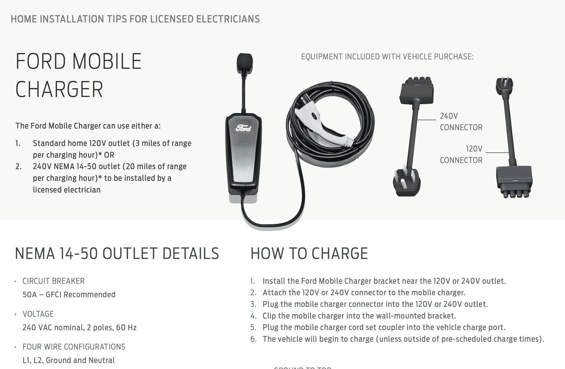

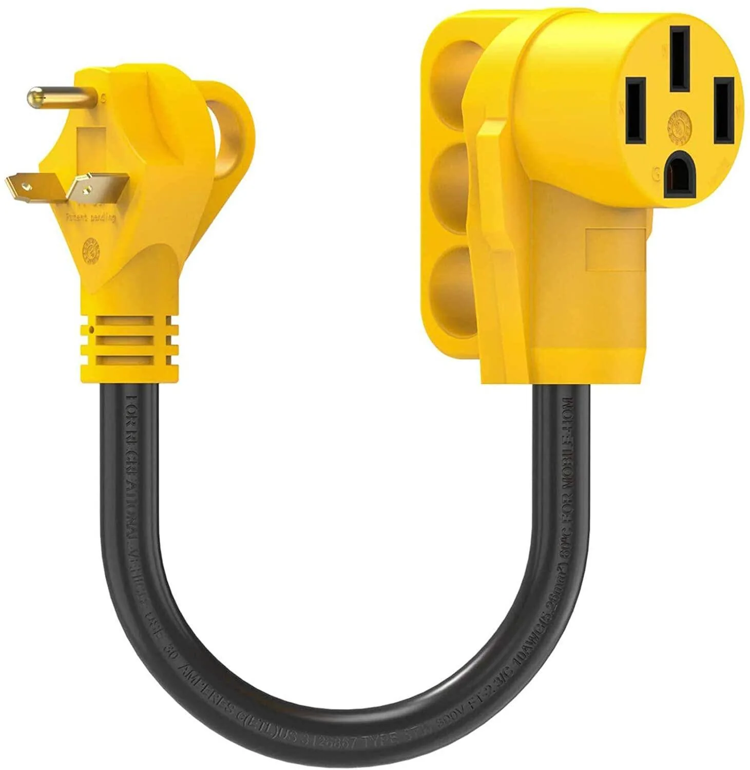

That's what the Leaf has for a portable charger....We just plugged right in.I think it's the other way around. The Ford Mobile Charger (that comes with the Mach-E) has a 14-50 plug on it, so if the campground has a 14-50 outlet you can just plug right in. You'd need an adapter if the campground outlet isn't 14-50 though.
https://www.ford.com/ntzlibs/conten...-sheet/Home_Install_Spec_Sheet_0831_FINAL.pdf
