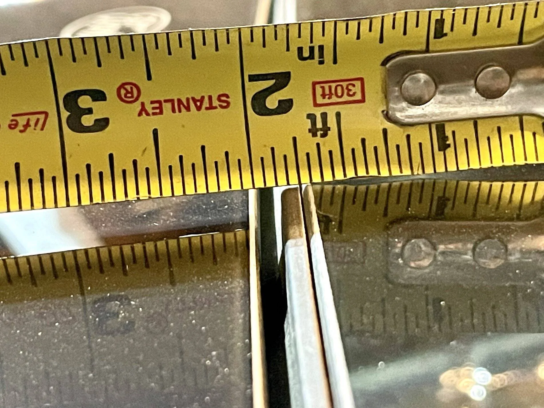

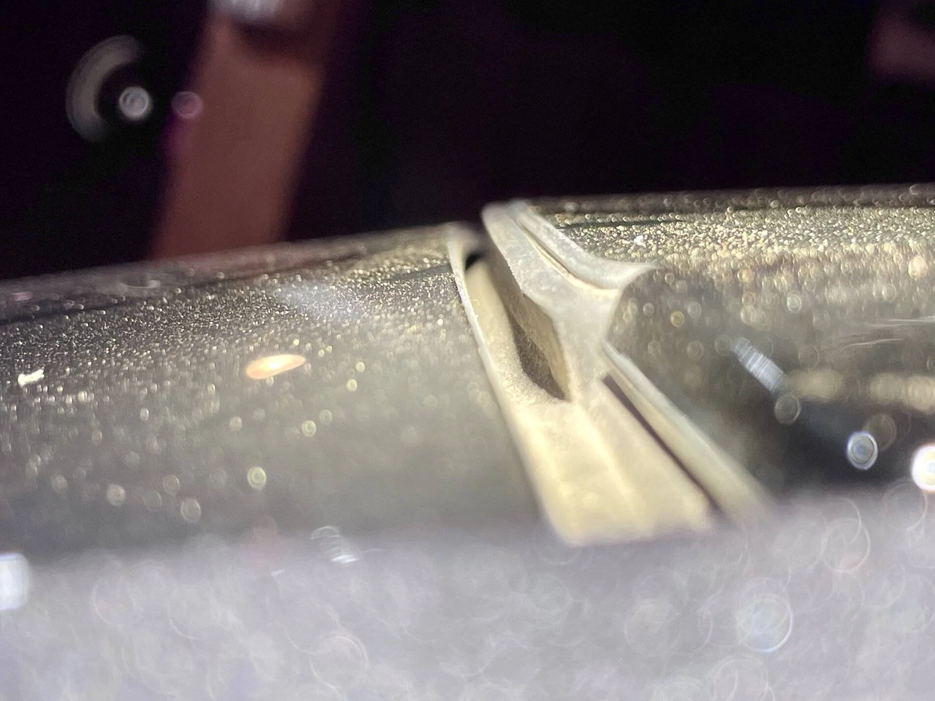

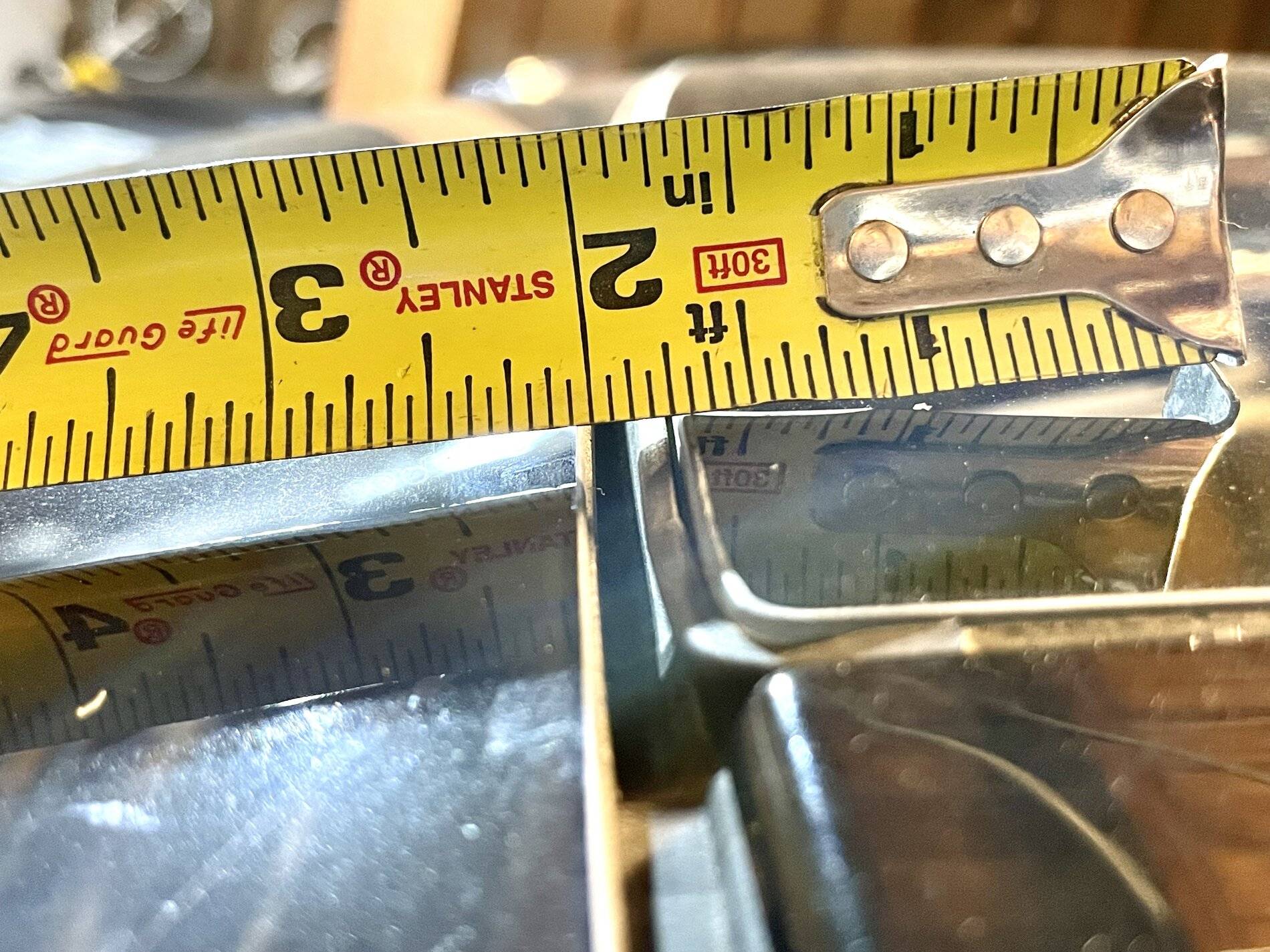

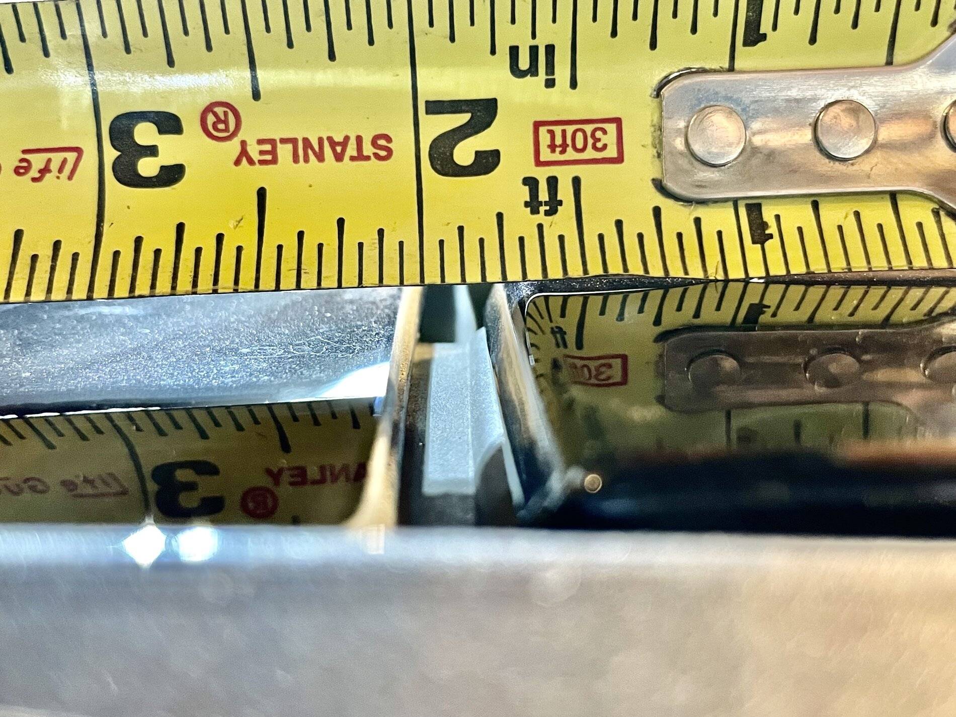

Here are the measurements of the gap between windshield and sunroof on mine, fyi... I hear wind noise starting around 30-35mph; definitely gets louder on fwy.
1) @ midway point - ~1/8"

2) On the driver side edge : ~1/8"

3) The gap gets larger when you measure between the windshield and the black trim (seen above and here, where it's ~3/16" - 1/4"

4) The depth of the gap - definitely a lot of room there. There's a small channel below the top lip of the windshield on the left.
