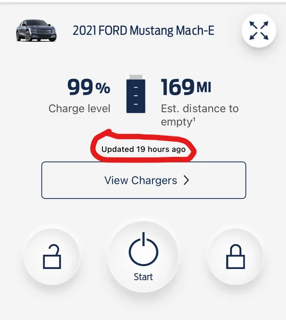

@tonesto7 , thank you for doing this, it really is fantastic! I asked in one of the previous pages, but I think it may have gotten buried. Is it possible to add a "Last Updated" field in the widget that displays how long ago the car updated its data? This is very helpful in FordPass so that we know if the data is 5 minutes old or 15 hours old. This wouldn't be an issue if the car would update its data more regularly, but I guess Ford's not there yet.

That will just force the script to refresh whatever data is available from the Ford servers, which is not what I'm after. I'm looking to have the widget display the time since the car last updated its data to the Ford servers, so we know how stale the displayed info is.
This is the field in FordPass:

That's a reasonable request!
Let me see if the timestamp is in the data. I know each status type has a timestamp just not sure about all the data.

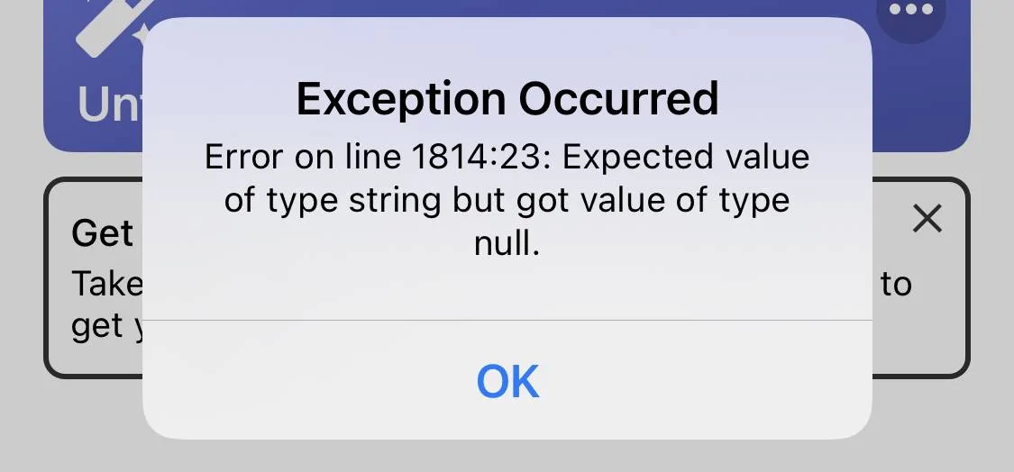

Thanks for all the great improvements, but it is not working for me when I try to update to v1.2.3.
Ford Mustang Mach-E ? Scriptable FordPass Widget (iOS, iPad, MacOS) IMG_0891
TEXT:
2021-12-17 11:28:30: Script Update Available: false
2021-12-17 11:28:30: missing: fpDeviceLanguage,fpLanguage,fpTz,fpPressureUnits,fpSpeedUnits
2021-12-17 11:28:37: (Config Menu) Done was pressed
2021-12-17 11:28:38: Error on line 1814:23: Expected value of type string but got value of type null.
I saw this same issue was posted to GitHub a few hours ago. Am I doing something wrong?
TEXT:
I got the same thing the first time. Reran it and the error went away.

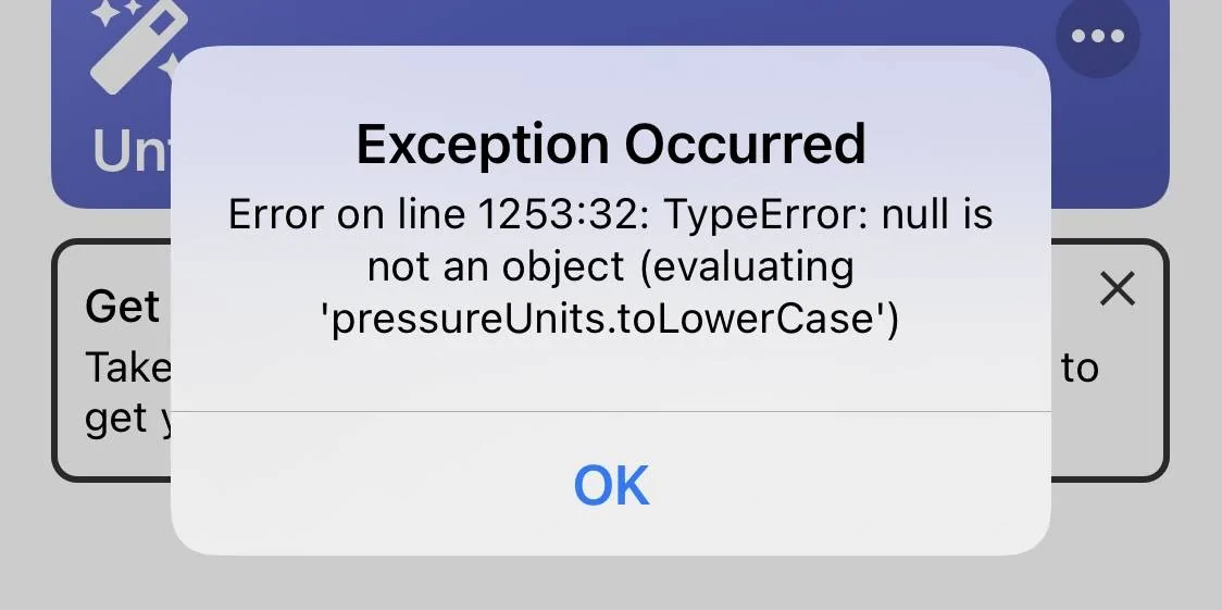

Reran it a number of times, delete app, delete data, reload, same result, except sometimes I get this error first, which, after selecting OK and running again, is followed by the 1814:23 error.
Ford Mustang Mach-E ? Scriptable FordPass Widget (iOS, iPad, MacOS) IMG_0892

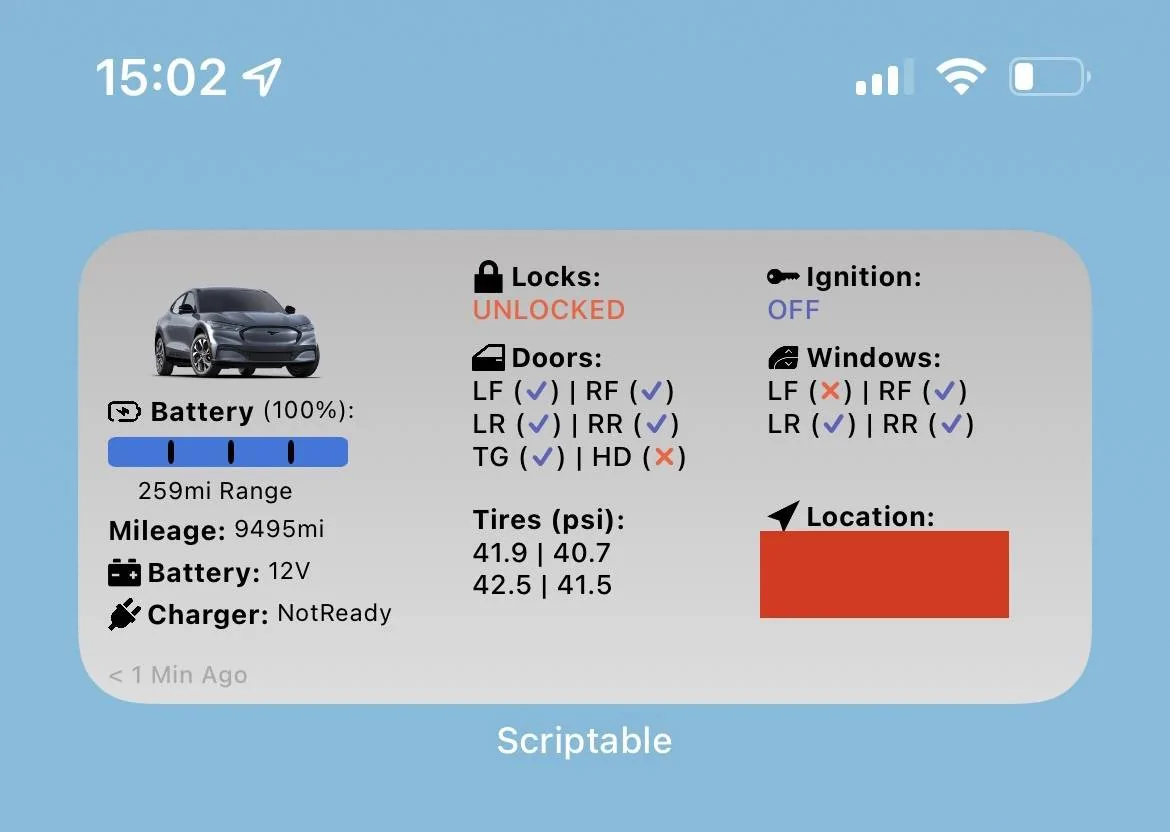

Added the status of the frunk and submitted a PR for it. Probably not as useful as the others but doesn't hurt to have.
Ford Mustang Mach-E ? Scriptable FordPass Widget (iOS, iPad, MacOS) 1639771433198
