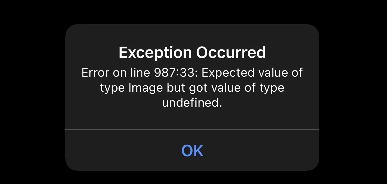

Copied the last code, put my credentials and vin in it and got the error
"Error on line 984:33 Expected value of type image but got value of type undefined."
I think 984 is the line and 33 the first character.
But in vs code the line is empty

Release v1.2.3
  • Added in a placeholder image for vehicles that don't have an image.
  • Fixed a bug for using psi tire pressure and metric units.
  • Automatically determine measurement units like distance, pressure, and locale from your Ford account. This should allow support for users outside North America.
  • Added Light/Dark mode to OTA and vehicle data pages.
  • Many more bug fixes and optimizations.
https://raw.githubusercontent.com/tonesto7/fordpass-scriptable/main/Fordpass Widget.js
