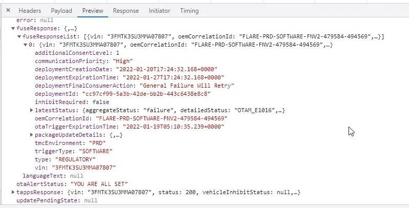

Data from website. Release notes say 2.3.0 (when I download them), but on the car it says update unsuccessful and shows last update as 2.1.
  1. {displayOTAStatusReport: "UserAllowed", ccsStatus: {ccsConnectivity: "On", ccsVehicleData: "On"},…}
    1. ccsStatus: {ccsConnectivity: "On", ccsVehicleData: "On"}
      1. ccsConnectivity: "On"
      2. ccsVehicleData: "On"
    2. displayOTAStatusReport: "UserAllowed"
    3. error: null
    4. fuseResponse: {,…}
      1. fuseResponseList: [{vin: "", oemCorrelationId: "FLARE-PRD-SOFTWARE-FNV2-479584-497824",…}]
        1. 0: {vin: "", oemCorrelationId: "FLARE-PRD-SOFTWARE-FNV2-479584-497824",…}
          1. additionalConsentLevel: 1
          2. communicationPriority: "High"
          3. deploymentCreationDate: "2022-01-24T17:48:51.110+0000"
          4. deploymentExpirationTime: "2022-01-31T17:48:51.110+0000"
          5. deploymentFinalConsumerAction: "General Failure Will Retry"
          6. deploymentId: "73cd5d7c-eb7b-4921-b39d-9aee7c71e598"
          7. inhibitRequired: false
          8. latestStatus: {aggregateStatus: "failure", detailedStatus: "OTAM_E1016",…}
            1. aggregateStatus: "failure"
            2. dateTimestamp: "2022-01-25T19:54:15.297+0000"
            3. detailedStatus: "OTAM_E1016"
          9. oemCorrelationId: "FLARE-PRD-SOFTWARE-FNV2-479584-497824"
          10. otaTriggerExpirationTime: "2022-01-19T05:10:35.239+0000"
          11. packageUpdateDetails: {,…}
            1. cdnreleaseNotesUrl: null
            2. failedOnResponse: "none"
            3. packagePriority: 1
            4. releaseNotesUrl: "https://mmota.autonomic.ai/1/bytest...90617339-6d97bb15-9027-468d-96d1-0d3569cb933c"
            5. updateDisplayTime: 0
            6. wifiRequired: false
          12. tmcEnvironment: "PRD"
          13. triggerType: "SOFTWARE"
          14. type: "REGULATORY"
          15. vin: ""
      2. languageText: null
    5. otaAlertStatus: "UPDATE UNSUCCESSFUL"
    6. tappsResponse: {vin: "", status: 200, vehicleInhibitStatus: null,…}
      1. asuActivationSchedule: {scheduleType: "", dayOfWeekAndTime: null, activationScheduleDaysOfWeek: [],…}
        1. activationScheduleDaysOfWeek: []
        2. activationScheduleTimeOfDay: null
        3. dayOfWeekAndTime: null
        4. oemCorrelationId: ""
        5. scheduleType: ""
        6. tappsDateTime: ""
        7. vehicleDateTime: ""
      2. asuSettingsStatus: {asuSettingsState: "ON", notificationSettingsState: "ON", oemCorrelationId: "2587",…}
        1. asuSettingsState: "ON"
        2. notificationSettingsState: "ON"
        3. oemCorrelationId: "2587"
        4. tappsDateTime: "2021-11-11T13:39:36.906Z"
        5. vehicleDateTime: "2021-11-11T08:39:32Z"
      3. lifeCycleModeStatus: {lifeCycleMode: "NORMAL", oemCorrelationId: "0", vehicleDateTime: "2022-01-04T18:36:02Z",…}
        1. lifeCycleMode: "NORMAL"
        2. oemCorrelationId: "0"
        3. tappsDateTime: "2022-01-04T23:36:24.058Z"
        4. vehicleDateTime: "2022-01-04T18:36:02Z"
      4. status: 200
      5. vehicleInhibitStatus: null
      6. version: "2.0.0"
      7. vin: ""
    7. updatePendingState: null
