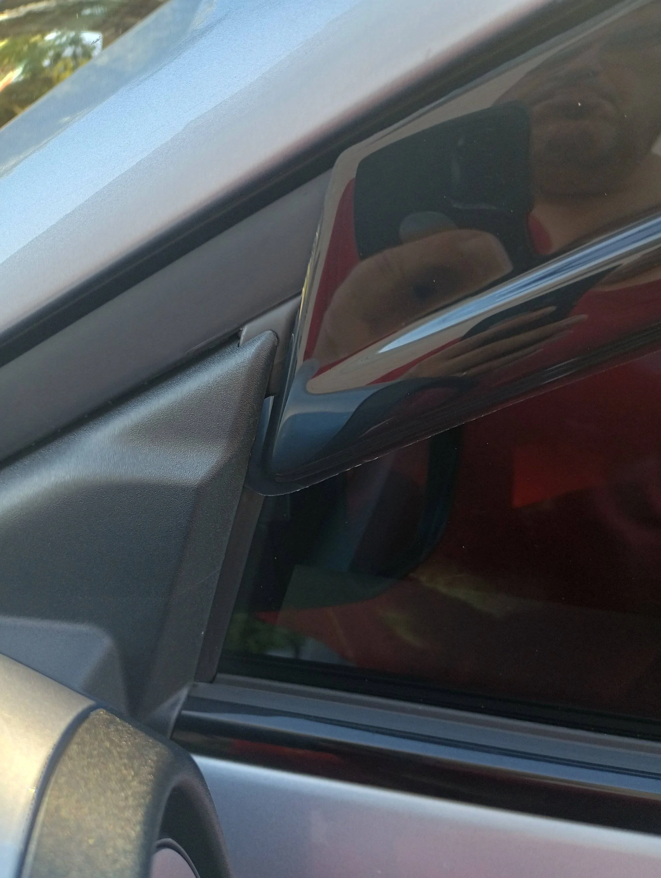

Had some wind noise on our 22. More so than our 21 in this area, We attributed it to the glass but just last month I used my points to get free Ford window visors, they tuck into the rear of the side mirror trim with a small tab, I believe this caused the front edge to be leveraged in to seat a bit lighter and now I have less wind noise in the car at highway speeds. Go figure, since I was thinking the window visors would cause more wind noise not less.

Thanks. Pics please.

Ford Mustang Mach-E Side Mirror Wind Noise Fix IMG_20230806_083453285_HDR
Tab visible here.

Wow I have to give that a try.
