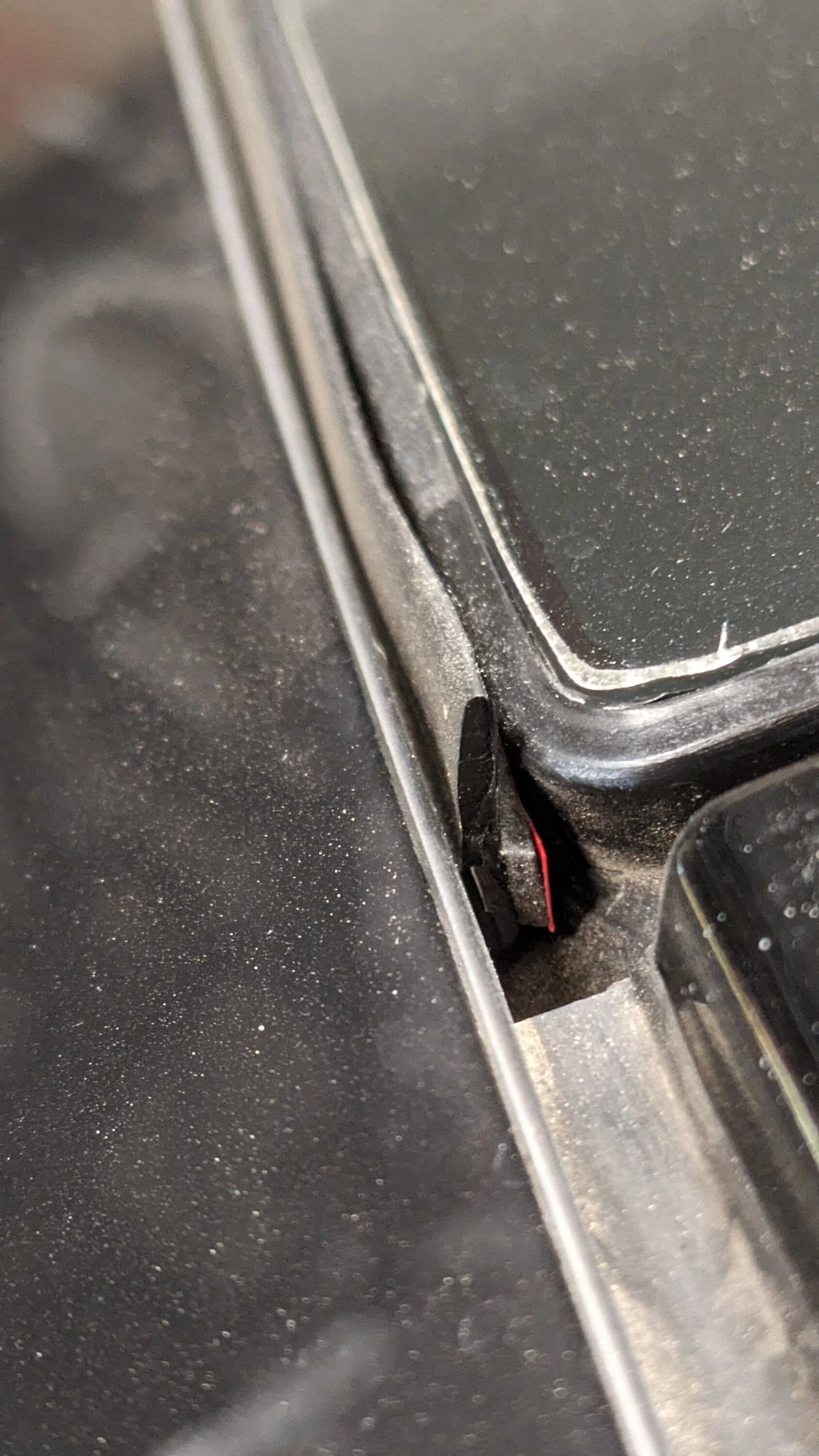

I did the RTV on the mirrors and ran the Ford weatherstrip between the windshield and glass roof. The weathership has an adhesive strip on it that I did not expose so that I could slide it from the side of the glass roof and through a push/pull get it all the way across. I did both the mirrors and the weatherstrip at the same time so I don't know which might have made the bigger difference. But, the wind noise reduction is significant (no dB test). My wife even commented on the car being quieter without knowing that I had done anything.
