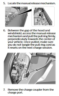

If the button doesn't work it's not likely that the screen release would work either. If neither work there's a manual release procedure that's documented in the owners manual:

Interesting!

Interesting!
I believe in that same article from the manual about DC fast charging it also has this in the notes.
Note: You cannot unlock the charge coupler handle unless the vehicle remote is near the vehicle.
