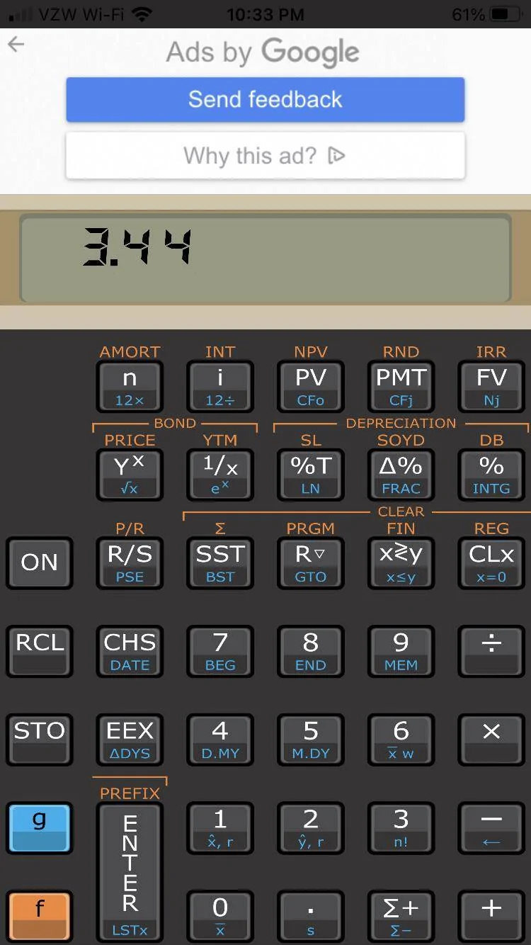

Actually, my solar was absolutely an investment for me. All depends on how you want to view it. Is it a depreciating "asset" or does it generate cash flow to your bank account? Since it generates a significant cash flow savings, it was certainly not an "expense". I would have had to find a tax-free investment instrument yielding 7% to have the same affect on my personal cash flow.
Interesting what you can do with numbers. Don't know what you are basing either 10 years or 20 years or 40 years on: could you explain those out of thin air numbers? While they may be mathematically correct, what do they have to do with saving $7000 on utility bills given your example of a solar system costing $100,000 that still produces savings beyond year 25? If you have gotten a "return of" your $100,000 at less than 15 years, what is your rate of return "on" between year 15 and year 25? Infinite perhaps? What is $7,000 as a "return on" 0$ for year 15? The savings don't disappear when you have completed your "return of" original cost. They keep going like the Energizer bunny!
OK, let's take another look. $7000 that I save that first year can either be considered a "return of" and can be reinvested in other financial instruments pending the arrival of that "payback date", or can be considered a "return on" and can be reinvested in other instruments as long as the savings continue. Either way, the savings each year is tax-free since it is a savings of cash flow that I would have needed to pay with after-tax dollars if I did not have the solar. Let's use your original "cost" of $100,000 to make it easy. Since this is a cash flow exercise, I don't consider depreciation. So, assuming an increase in utility bills of about 5% per year and a drop in solar efficiency of 1% per year for an increase in utility savings each year of 4%, and assuming a paltry 2% after-tax return on my savings invested each year (from year 1 on to year 25), at the "end" of 11 years, I have my $100,000 back. However, at year 25, I am still saving $18,700 during that 25th year and I have a balance of over $360,000 by year 25. Certainly a "return of" my original $100,000 more than 3 times. Regardless of whether you call it "return of" or "return on", you still come out in pretty good shape! If the panels are generating a savings almost $19k in year 25, what is the value of that income stream at that time to either yourself or to a home buyer? I leave that to the student. Of course, there may be some states where electricity costs are not doubling every 8 to 10 years or so, but they have been in California where I live.
I tried to explain the math multiple ways.
We can use whatever numbers you like, but none of the numbers equate to a 10%, 7% nor anything close.
I used the exact numbers given in this thread.
If you’re curious how to calculate “rate of return,” just Google it.
The inputs are this:
PV (present value) = initial investment (a negative number)
FV (future value) = whatever the investment is worth at the end. I was using zero assuming the panels eventually need to be replaced. But you can plug in whatever number you like.
N = periods (number of years)
PMT (payment) = how much the investment pays per period. In this case it’s the energy savings.
I (interest). Solve for I.
I’ll just leave it saying this. I calculate this stuff as part of my job.
Here is the answer to your $7k per yr on $100,000. This is for 20 yrs in this example.
Ford Mustang Mach-E Solar payoff....worth it? 3D8A5E39-9ED1-4AFC-BA40-2965F4E54644

How can they become worthless if they continue to generate savings in utility bills? How long to reach 75% of original efficiency? 25 years? I would probably replace them or add more if output dropped to 75% or so... Worthless? Why? Only if they stop producing completely...
What is a 25 to 40 year old solar system worth? I’m assuming zero.
If you want to plug in a value at the end, I can run the numbers that way if you’re curious.
It’s just a math formula.

Don't savings continue after the 10 years? They don't magically stop just because you have "recovered" your cost. Now I see what you are leaving out!
I’m definitely not leaving it out. Just showing you points in time to help explain the math more simply.
In that example
10 years? you break even
20- you double your money (this equals 3% return over 20 yrs)
30- you would get back 3x, etc….. still equals a 3% return.
And 3%? Basically equals inflation. Your after inflation return is zero.
Bottom line? If you don’t move and live there long enough, it CAN pay for itself.
But is absolutely is NOT a high rate of return investment as you have pitched it.

Are these absolutes? Because if my system is paying itself off in 4 years ROI, that means within 25 years, I've returned my investment 5 times over...
but do go on.
Now, your math is fine and good, but where are you accounting for the money that you continue to spend on power since your diversion of that investment means savings are not realized and money is spent?
Not absolutes at all.
I was just correcting the math.
If your system pays for itself in 4 years (instead of 11-15 like the other people), clearly your return is significantly higher!
Individual results may vary.
My post is not for nor against solar. It was just clearing up how to calculate the return so people can make their own “is it worth it” decision.
For me, here in Florida? The return is terrible. Systems are expensive, they require a new roof, and every 10 yrs your insurance company makes you get a new roof, which means taking the panels off and reinstalling.
The break even point is easier measured in decades than years for me.
