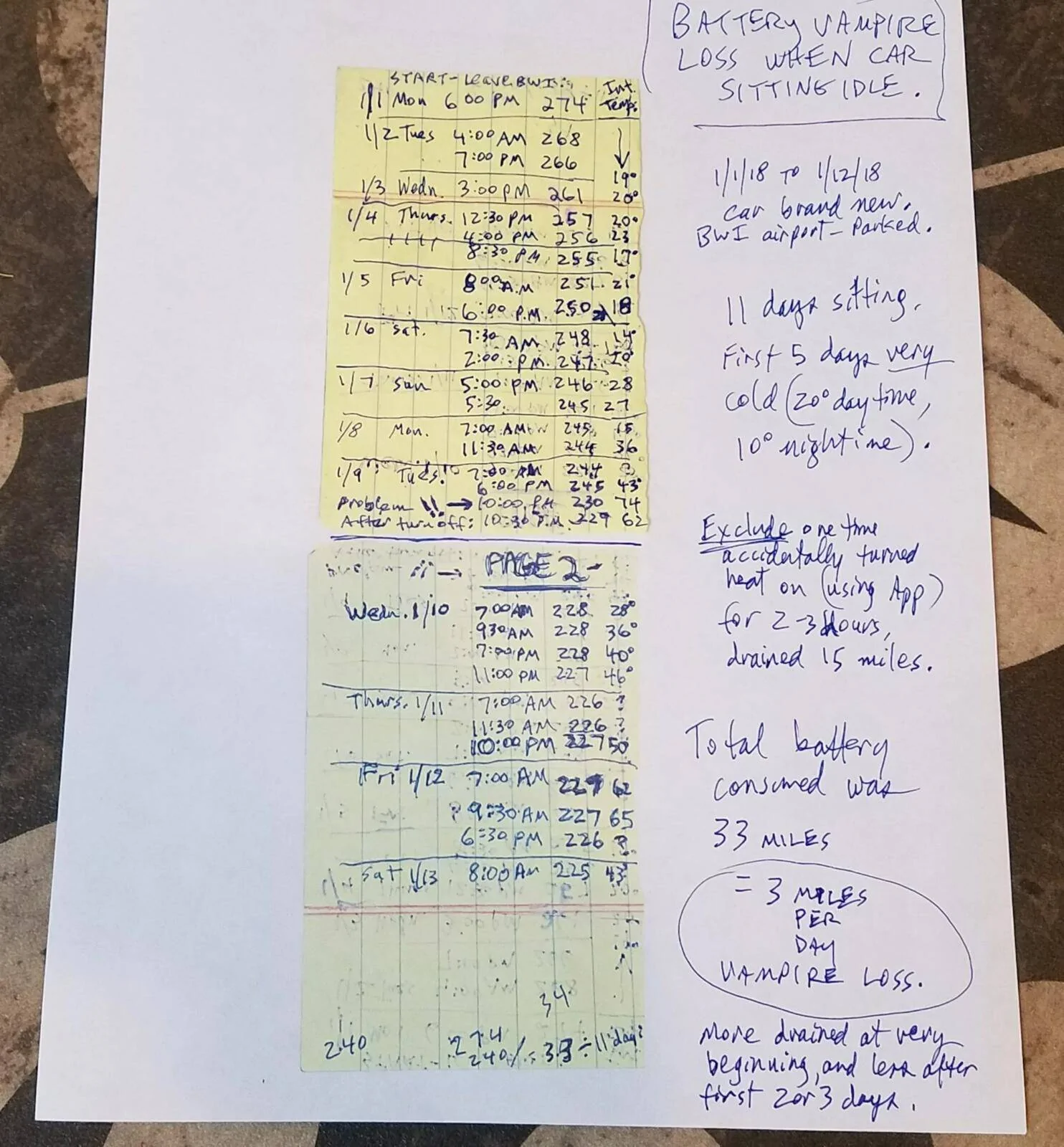

Another dumb question - let's say I park at an airport outdoor for a week in the middle of winter. Any idea how much charge I'd lose having it just sit there?

First off, another not dumb question. Secondly, thank you @trutolife27! Personally this was one of my biggest concerns also reading through several Tesla forums. Pre-COVID, I flew for work all the time and coming home to a dead car would be a deal breaker.
I think Tesla mismanaged their standby loads not taking this into consideration because they have too many "features" running in the background. So happy to see this exact scenario was thought out by Ford, and further evidence the MME was the right choice.
