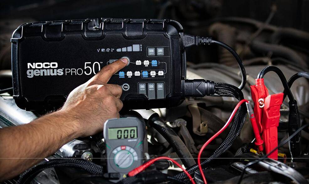

No 6.1.0 yet for my car. In other news this is looking like a promising power supply. Much smaller ff and more portable than the popular PL6100.
It’s pricey but 33% off. What do you guys think?
https://www.amazon.com/dp/B08Q2Y2M7R
After 33% off it's still substantially more expensive then the PL6100. I don't think I've heard anyone complain about the size of the PL6100, just the price. So this certainly won't help with that. This also doesn't look like it has a screen, so I'm not sure you can set it for more than 12V of supply (you'd also have to use a separate multimeter to measure votlage). And I'm not sure it's as small as some may think:

Additionally, this is a charger, not a regulated supply. Ford states that a regulated supply is needed for flashing vehicle software. ??
It looks like it does have a supply mode, but I'm not seeing anything that's better than the PL6100 to justify spending more.
Oh, I missed that. ??
Yes, I don’t see anything there that makes it worth a few hundred dollars more than a PL6100. ??
