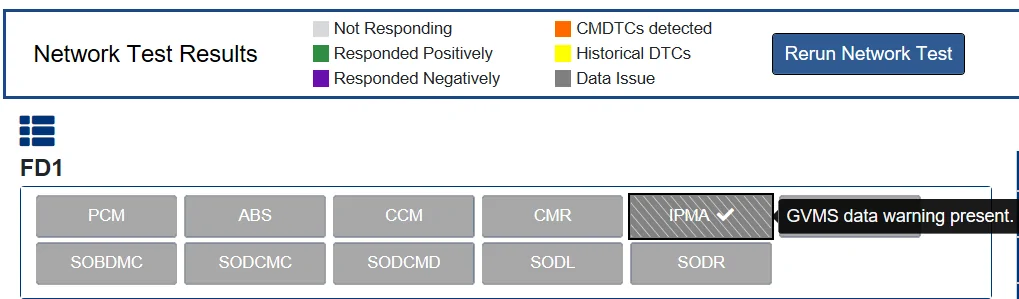

I do get an warning, does anyone know what to do with it ?
The explanation: "
A GVMS Warning exists which may result in FDRS not offering necessary apps. To remove the warning associated to the module you are working on, select the module to open a case. Status can be viewed on the PTS "As Built Assistance Request Status" page. "
It means Ford is blocking your ability to update your IPMA right now...whether or not you have an actual IPMA update available or not. I had the same thing on my GWM...but didn't have a GWM update showing to program anyway. The GVMS block on my GWM has now been lifted...but I still don't have a GWM update available to program.....so it's a moot point.
As if i want to flash ipma right now ! That module takes forever. Ok thanks for the headsup

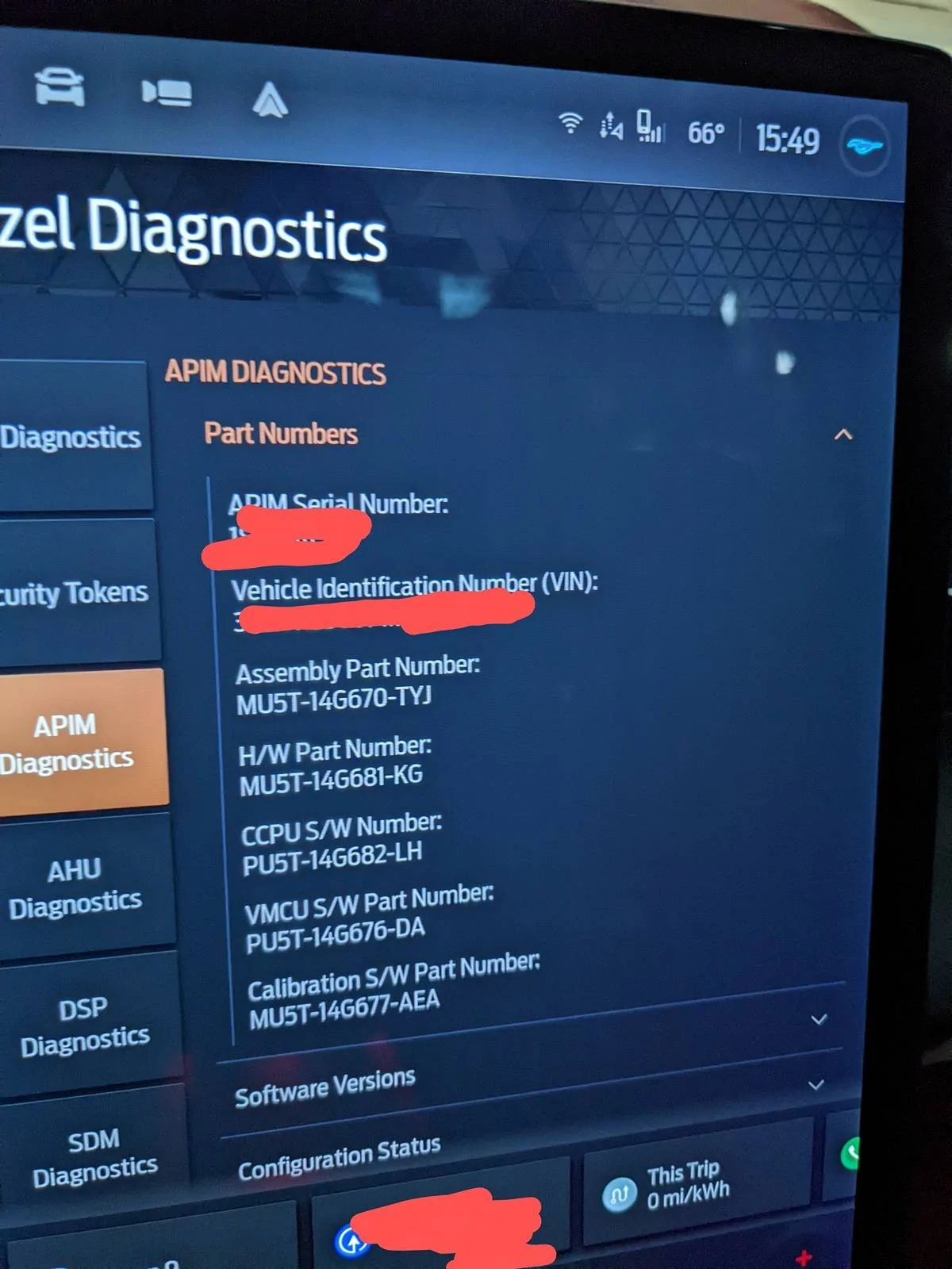

How did you pull up this diagnostic page?
It is almost the same procedure as resetting the sync screen. But now you use the volume up I believe
Is the block for technical reasons?
Mike G
Mar 27, 2022
6,449
5,289
N. AL, USA
Well that's a reasonable suspicion.
The fact that I had a GVMS block a few days ago...and now I don't....but now that the block is gone I don't have an available GWM update anyway...who knows?
