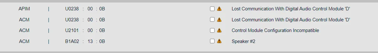

QQ: I don’t have the B&O amp installed anymore. In the DTC’s, it says no communication with Audio Control Module “D. I want to make sure that is referring to the B&O amp, and conform that the installers did not disconnect the ACM itself. Does anyone know?

Well it's my understanding the ACM is the actual radio module. So does the radio work?

ACM is the Audio Control Module for the radio and it also has a three channel amp for the center speaker and the two dash tweeters. The DSP is the B&O amp powering the rest of the speakers.

Thanks. I totally understand that. I don’t use the ACM to power the front speakers. The question was about the reference to “Audio Control Module D” in the FDRS DTCs. Is it a reference to the ACM or the DSP/amp?

What was the DTC? Was it U0238? I am pretty sure it is in reference to the ACM but it could be stating the ACM no longer has communication with the DSP.

These are the codes. You can ignore them. It is going to report them forever since you went with aftermarket goodies. The car is saying the ACM can't talk to the APIM or the DSP.
