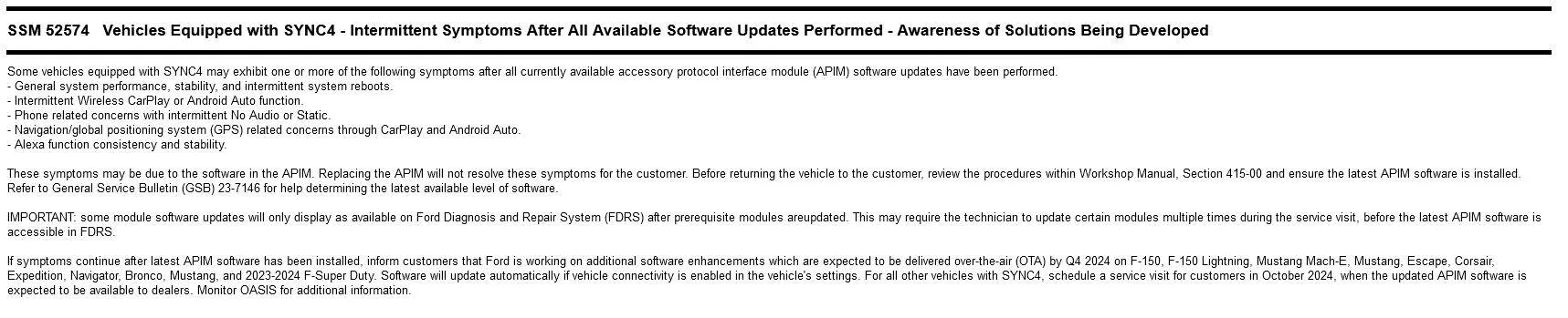

Ford Mustang Mach-E THIS SOFTWARE SUCKS CarPlay
I came across this yesterday regarding software issues.
