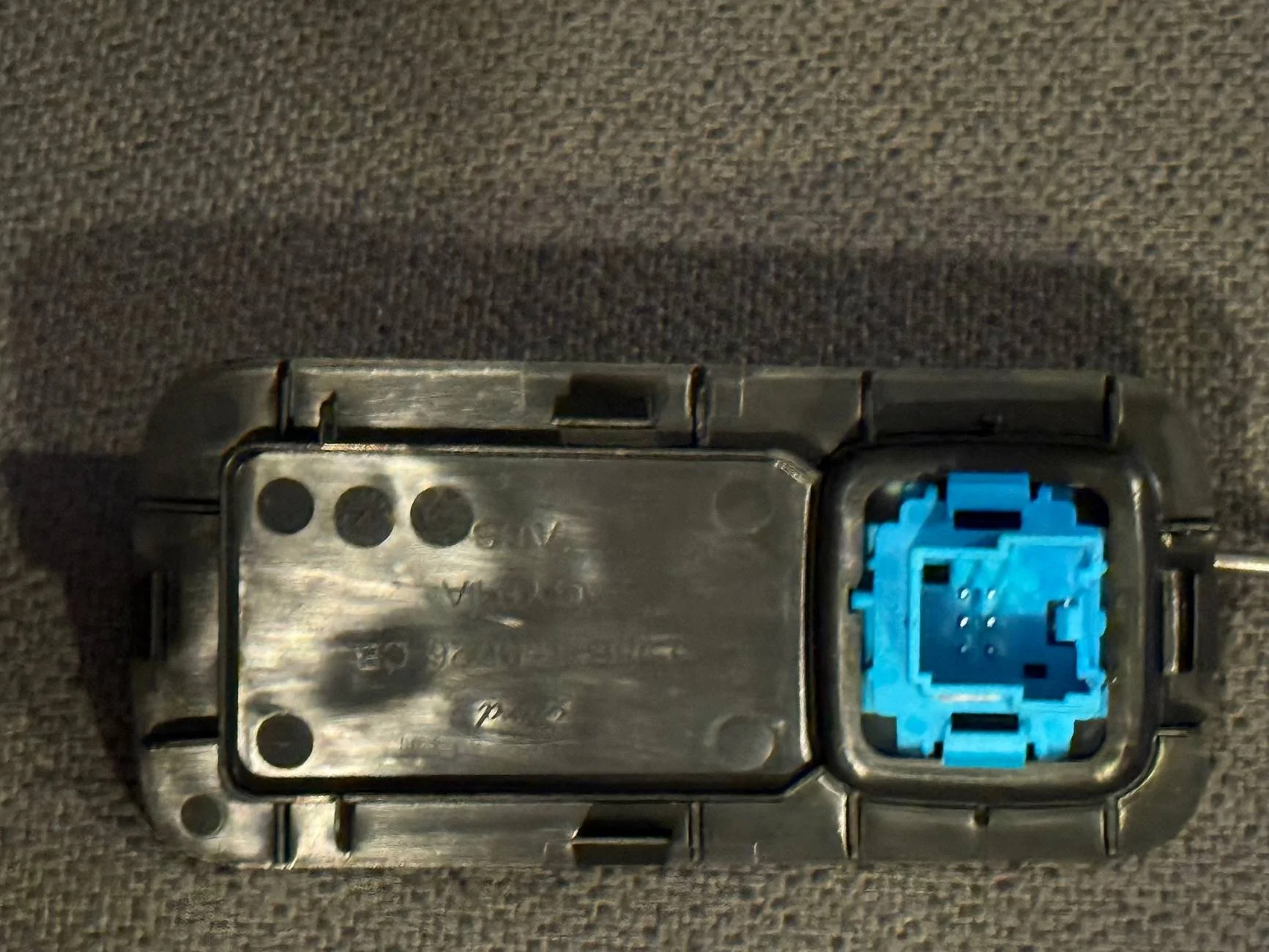

I got my switch and escutcheon today. I am going to use a 2x3 socket housing to keep things tidy and I am color coding the wiring since I’m weird that way. ??
Installing this weekend. ??

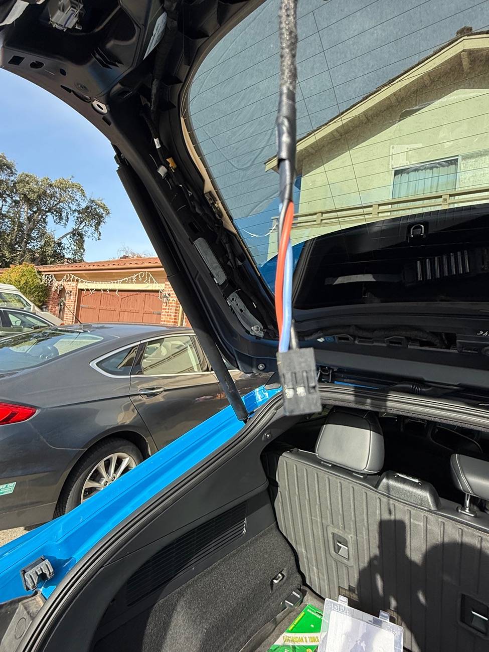

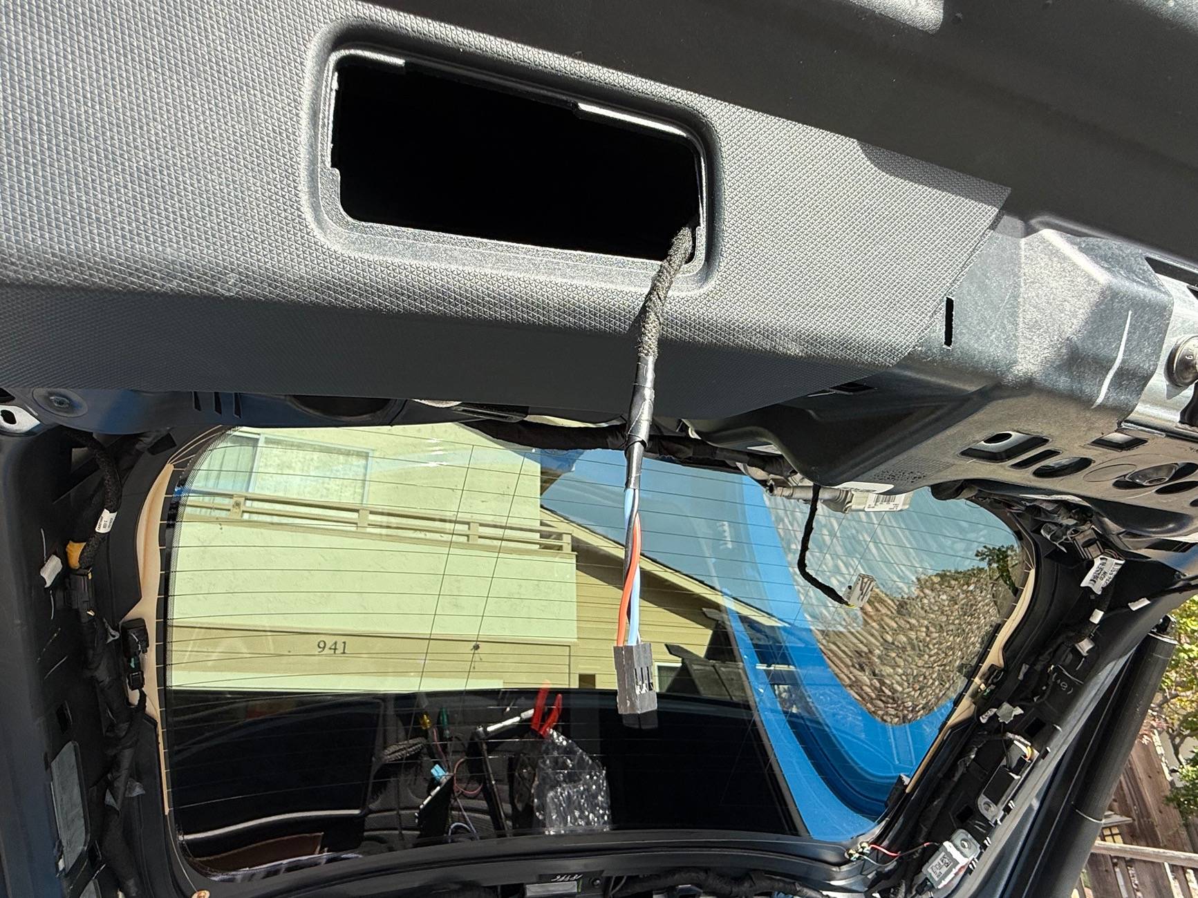

Got the wiring and switch install done. I routed the new wiring along the driver’s side license plate light branch then to the switch area. I installed 0.1” pitch female pin connectors on the wires (brown, black, and blue because I am weird) and inserted them into a 3x2 housing. There seems to be enough friction to keep the connector on the switch’s pins using 3 in that housing. I might do some sort of positive retention mod in the future but for now it’s just friction. ??

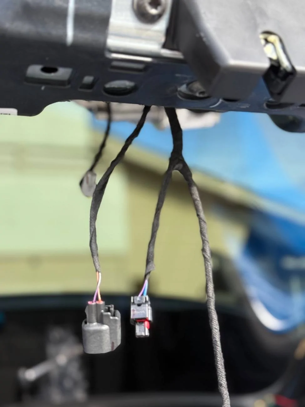

The center liftgate release wiring and the left side license plate light wiring are part of the same trunk system, so I just removed some tape from above the branch where they separate and stripped the three wires so that I could tap into them. Left to right: Center liftgate switch connector, left side license plate light connector, and the pigtail that extends to the new left side liftgate release wiring branch. Note that the main branch was re-wrapped in a similar cloth tape to what Ford uses and that the extension branch to the new switch is also wrapped in the same tape. ??

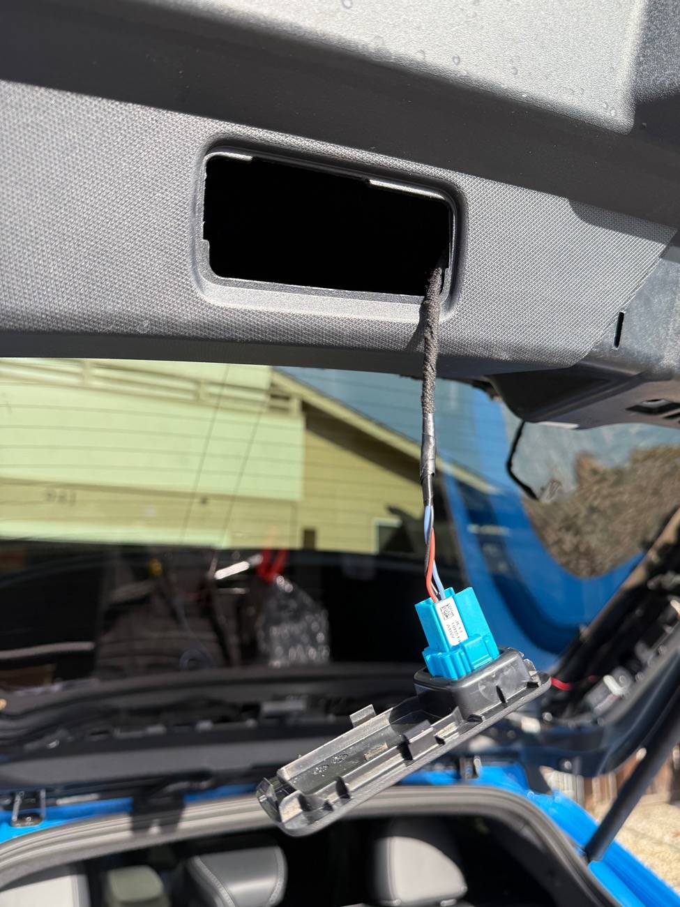

This is how much excess wiring I planned for the switch hole. ??
Ford Mustang Mach-E Trunk button(s) IMG_5095
And the switch hanging from the connector just before insertion into the liftgate. ??

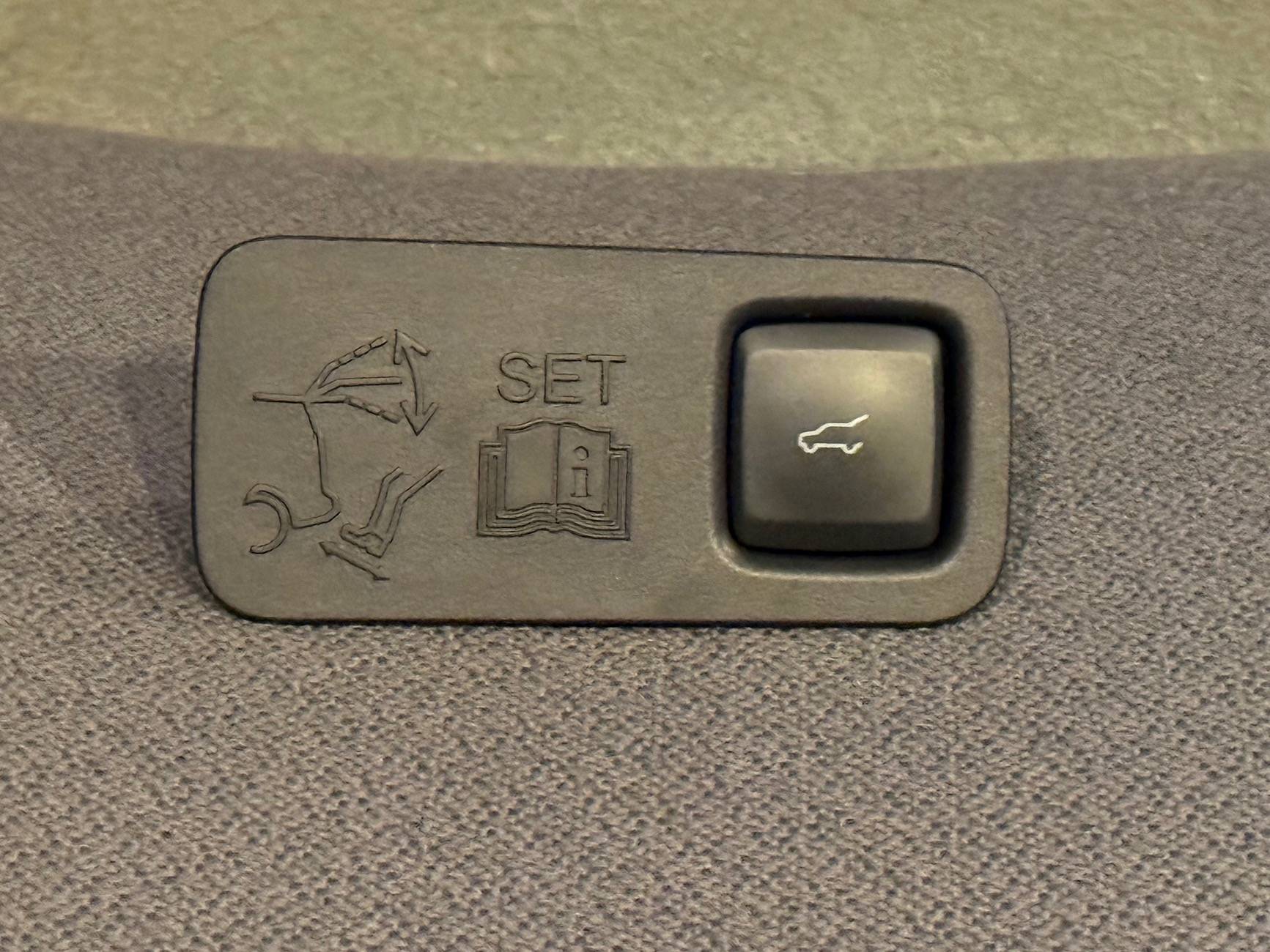

And the boring final product. ??

Yeah. 6 clears through FDRS, plus a couple from my OBD-2 unit and CarScanner. I am guessing it’s the liquid electrical tape I used. First time I have ever used that stuff. Gonna unwrap the harness today and tape up the splices instead. ??
