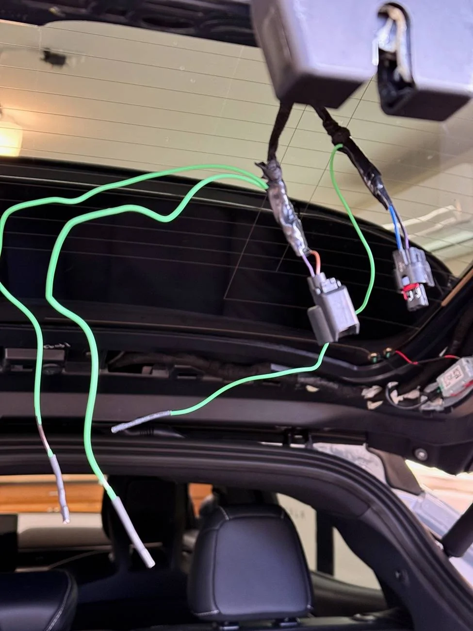

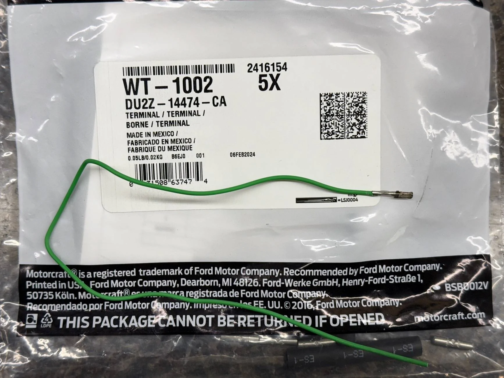

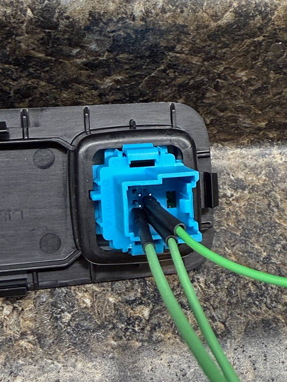

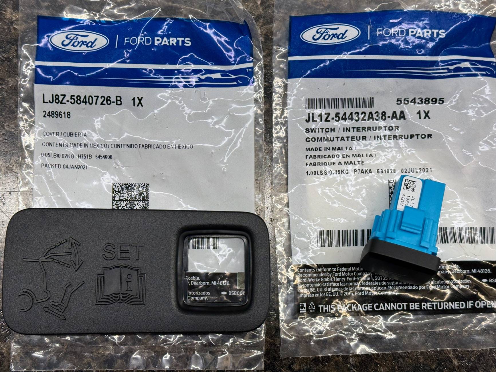

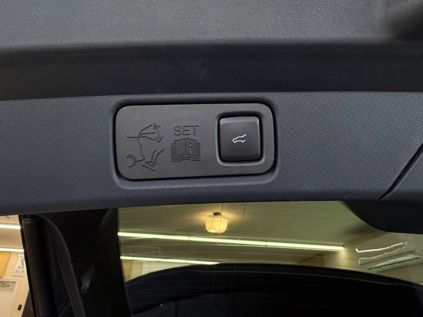

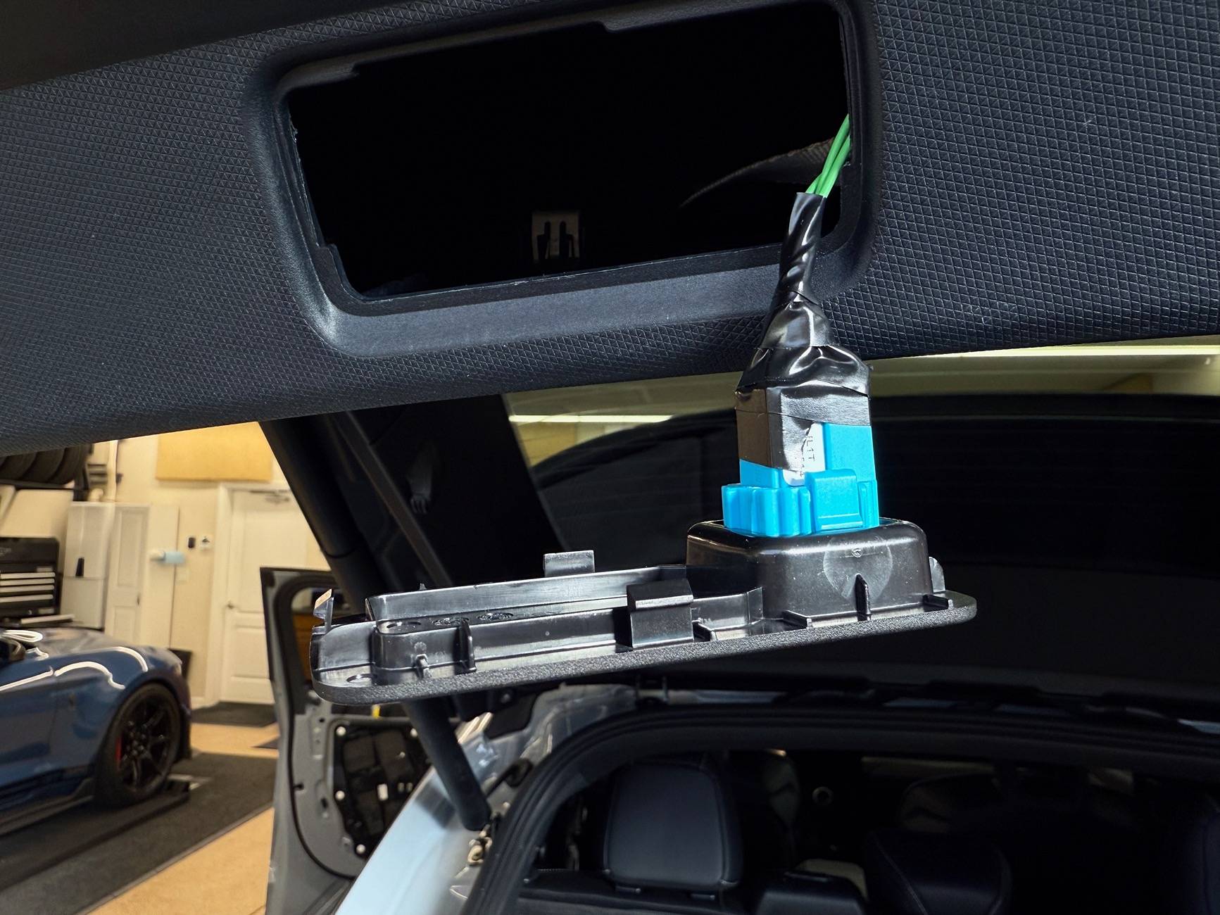

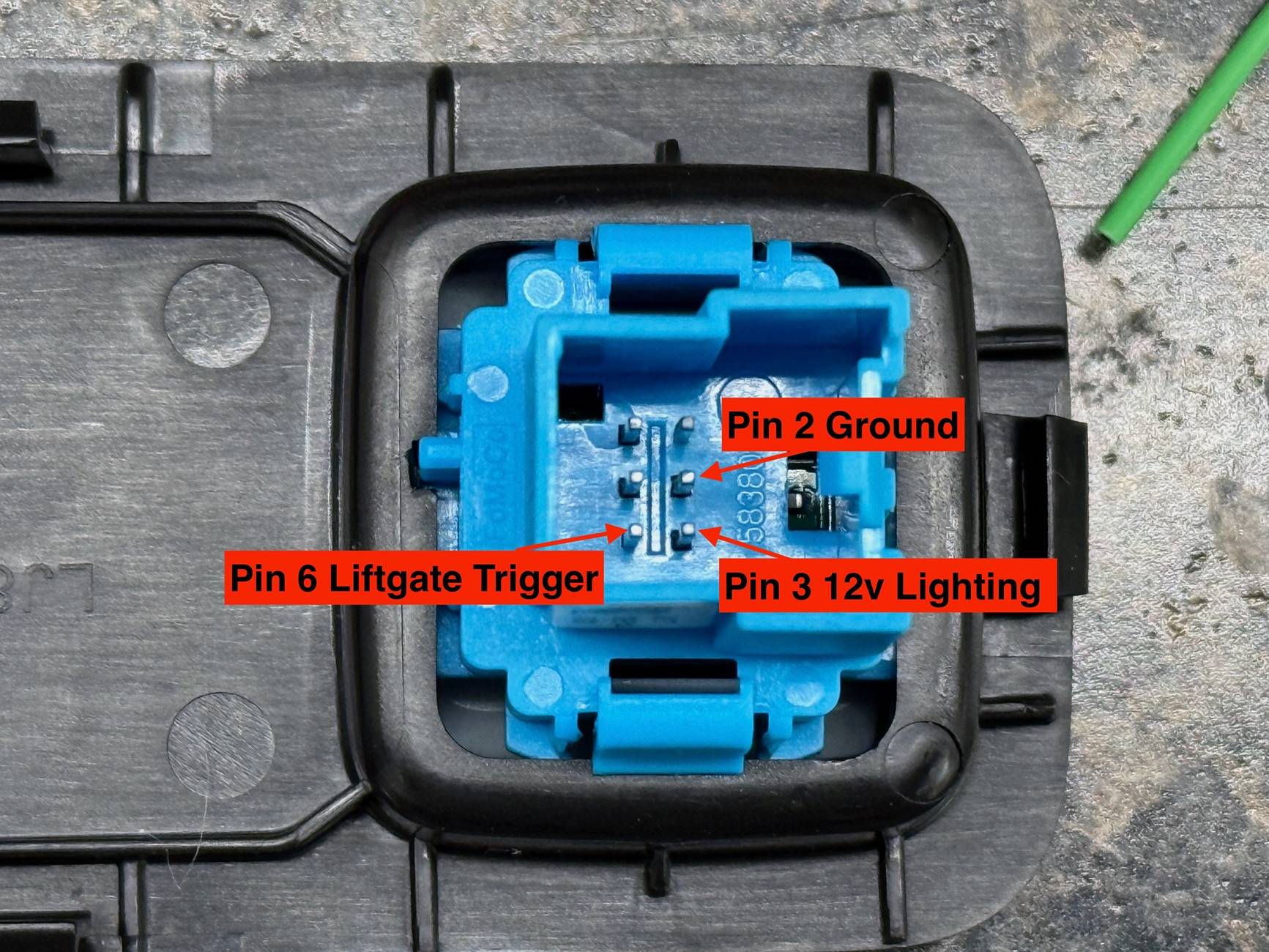

Hey Mick, yesterday I installed the recently ('24 MY) deleted lighted liftgate switch. I did not have much time and only took a few photos. I purchased the switch, cover (plate switch fits into) and 3 terminal/wires. I could have bought the prewired plug/connector that fits into the switch but Ford wants $55 for it and I just used three prewired pin terminals.
Switch part# JL1Z-54432A38-AA $20
Cover part# LJ8Z-5840726-B $16
Terminal/wire part# DU2Z-14474-CA $6 each (need 3)
I removed all the interior liftgate trim (everything unsnaps, no screws). Removed the plug/connectors going to the rubber exterior liftgate switch and to the license plate light. Both are within a few inches of each other. You need to make three connections. On the plug for the rubber liftgate switch, tap into both the wires coming off of it. The black/violet wire is ground and the brown wire is the liftgate motor trigger. On the plug for the license plate light, tap into the Blue/gray wire which is 12+ for when the lights are on.
Once I tapped into those wires on the plugs, I taped them up and reconnected to the liftgate switch and license plate light. The wires on the terminal/wire the I got are long enough to go right over to the hole where the lighted switch will be installed. I put heat shrink tubing on the ends of the terminals so when I attached them to the pins inside the switch, they would not contact each other.
The ground wire attaches to pin 2, 12+ (lighting) to pin 3 and the liftgate motor trigger to pin 6. I then taped up the wires together and to the body of the switch so that they would not vibrate out even though the terminals fit snug onto the pins. The switch works just like the rubber one does (opens/closes liftgate) and it also will set the height of the liftgate just like the original one did. AND it is illuminated so much easier to see in the dark.
I didn't have more than an hour or so to work on this and took the photos quickly so not the best.
Ford Mustang Mach-E Trunk button(s) IMG_3283
Ford Mustang Mach-E Trunk button(s) IMG_3284
Ford Mustang Mach-E Trunk button(s) IMG_3287
Ford Mustang Mach-E Trunk button(s) IMG_3286
Ford Mustang Mach-E Trunk button(s) IMG_3295
Ford Mustang Mach-E Trunk button(s) IMG_3288
Ford Mustang Mach-E Trunk button(s) IMG_3289
The ground wire attaches to pin 2, 12+ (lighting) to pin 3 and the liftgate motor trigger to pin 6. I then taped up the wires together and to the body of the switch so that they would not vibrate out even though the terminals fit snug onto the pins. The switch works just like the rubber one does and it also will set the height of the liftgate just like the original one did. AND it is illuminated so much easier to see in the dark.
This is great!
thank you so much for the walkthrough!
Thanks for the detailed information and photos. Much appreciated!
