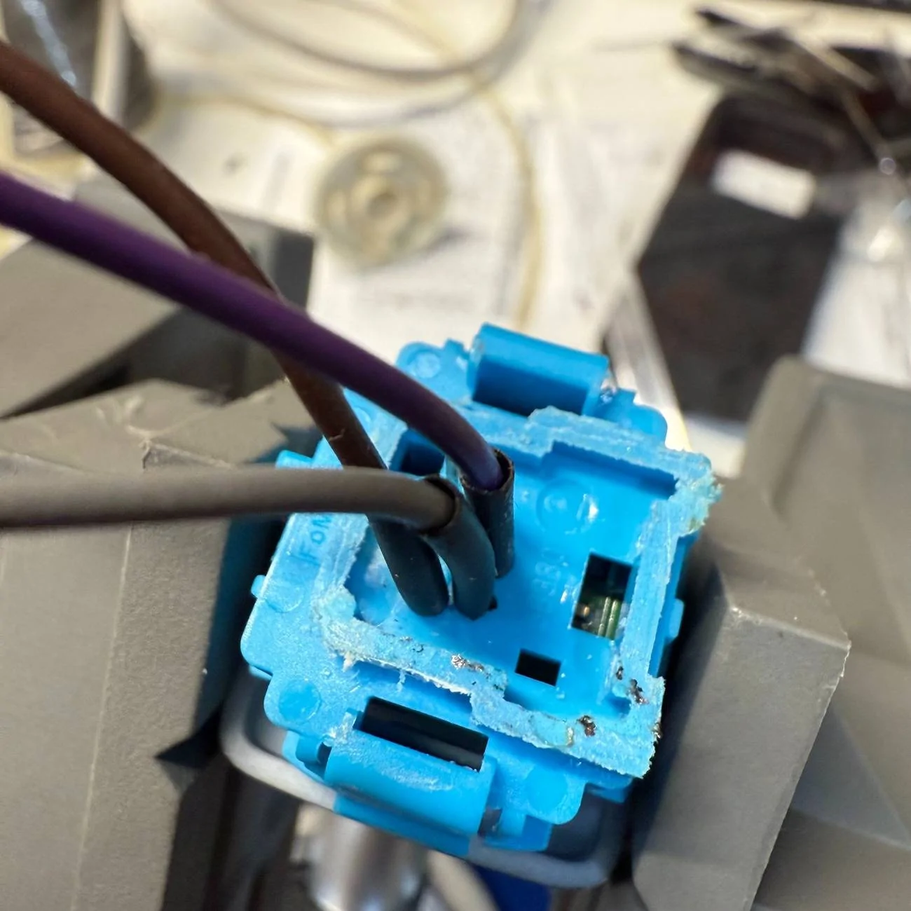

Last week, I finally got around to installing the parts I ordered back in December. You know, waiting for good weather, etc.
The parts place of course rips you off by selling a pack of connectors that says right on it, 5 pieces, return if opened. But only one wire in the opened and taped package. I didn't use it anyway.
What I did was cut down the switch connector to better expose the terminals using a razor saw. Then I soldered wires directly to them, covered in shrink tubing. Then I used some vampire taps I had for, oh, 40 years, to connect to the appropriate existing wires.
