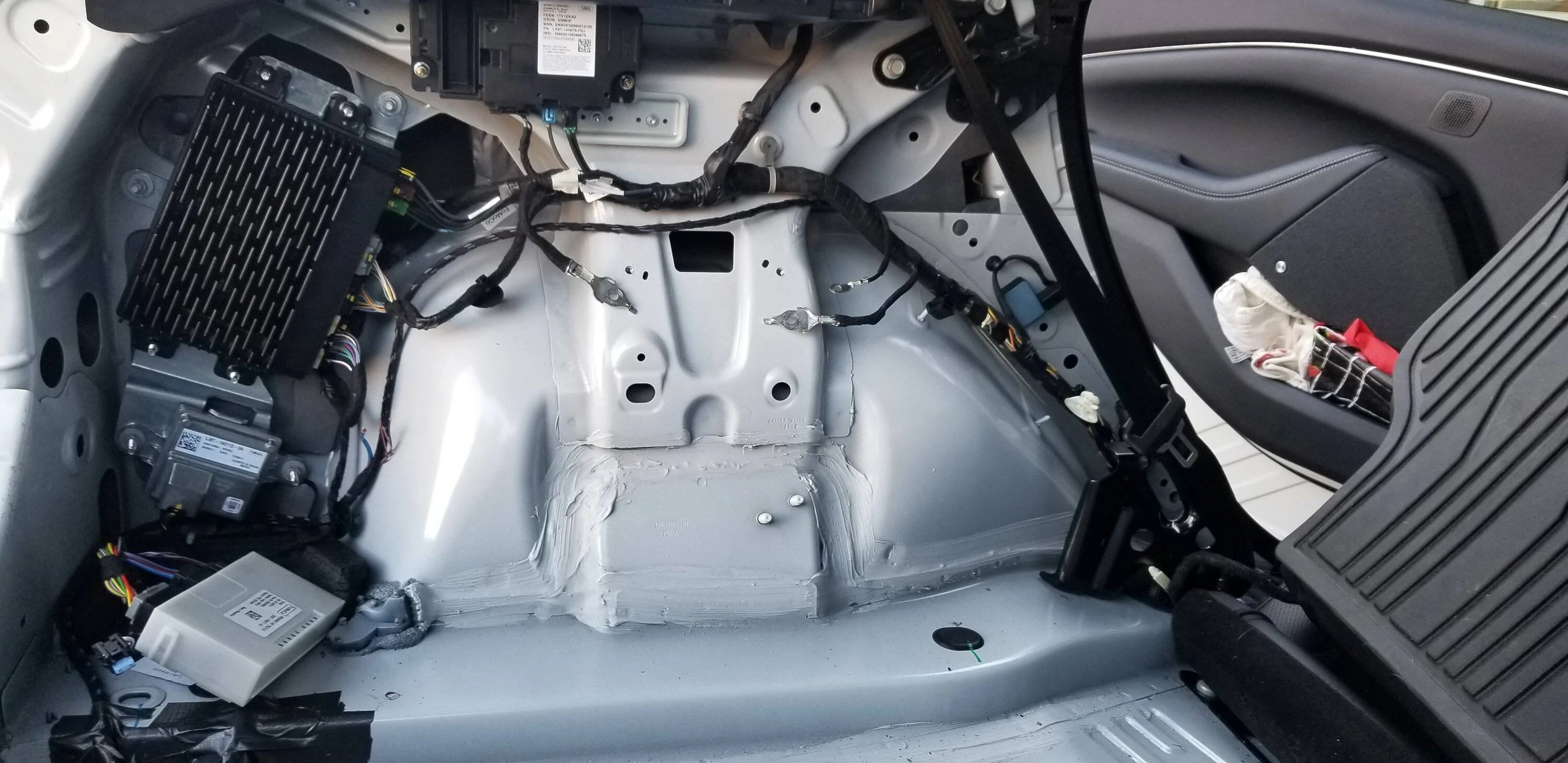

They appear welded to small angled plates which are in turn bolted to two hefty in-wall bolts... bolts which are present on our North American cars. See the attached pic.
This is the left cargo wall. The two bolts are on its lower right.
I have the part numbers for these Euro plates... TBC. If this works I'll pay a DIY thread.
I never got the entire interior trim part out. I thought the mount points for the forward loops was farther forward than those two studs. I hope your parts work out. I hate the fact that we don’t have those forward anchors. ??

Now that is very interesting. We just need to find a part number now!
I'm thinking taking the trim off can be avoided by simply cutting out the liner where the dimples are, no?
I have the two part numbers. The parts are coming... Then we shall investigate further ;)
I thought so as well until I yanked the whole wall trim panel out to finish installing my Euro Ford tow wiring kit and control module.
Then I said "Hey wait a minute... Just what are these two strong bolts doing here all by their lonesome?" One thing led to another and fellow member Su+mach-e in Germany did some research to help out...
We'll see if the drawings and part numbers he dug up are indeed what we both think they are. And yes I already checked - Those part numbers are unavailable from Ford North America.
