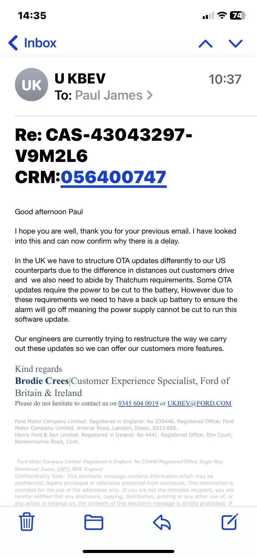

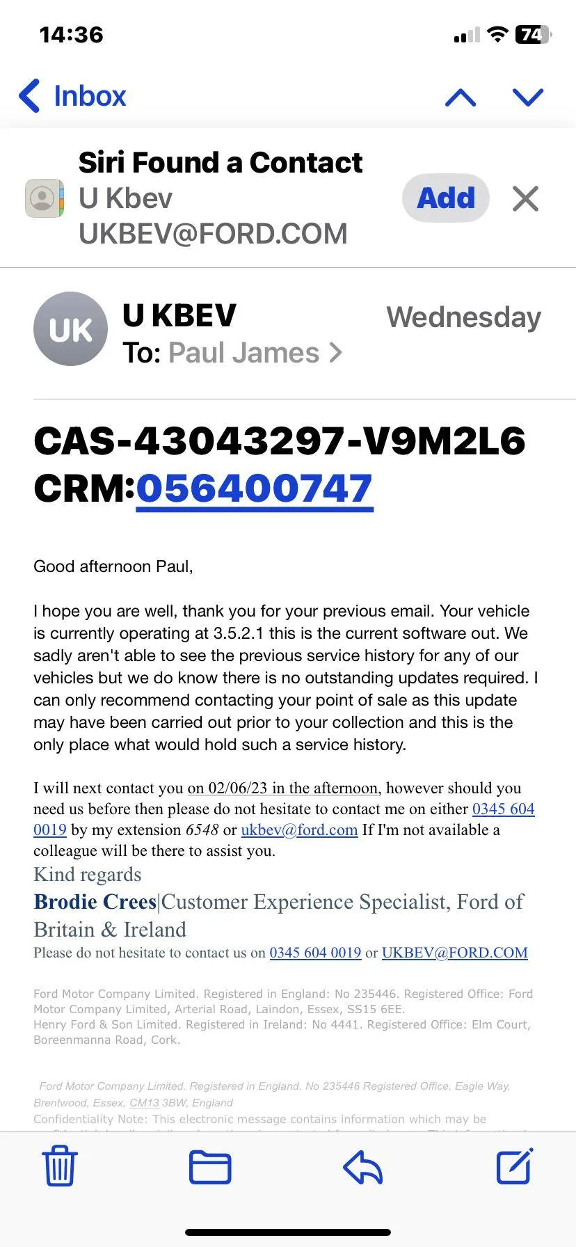

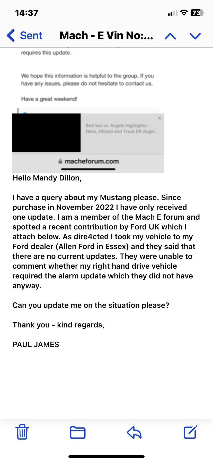

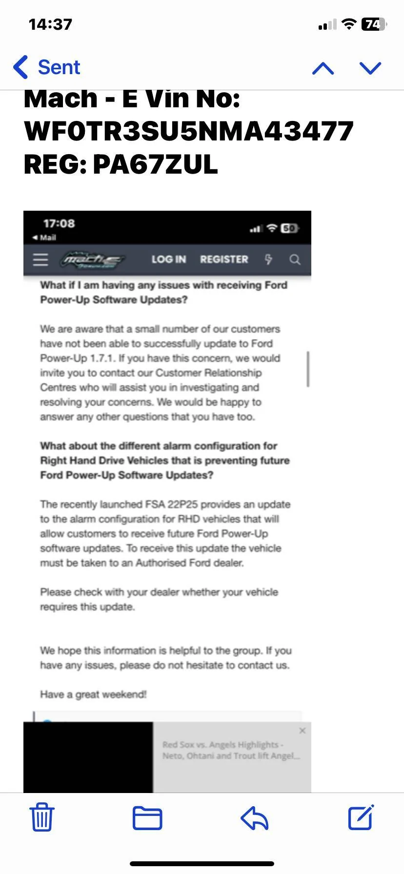

I recently contacted Ford Customer Service about the lack of updates here and you might be interested in the response I received.
You’d think somebody who could spell and is literate would be put forward to provide official responses??‍♂

It’s a pretty hard email trail to make any sense of, and it’s littered with the same factually incorrect responses from Ford that we have gotten so used to ? (how do they manage to get it so wrong?)
@Oldlawman - you left your vehicle VIN number on the email screenshot so I took the liberty of doing what Ford customer services are incapable of doing and looked up to see what dealership software updates have been applied to your vehicle since it was built - the answer is none. The good(ish) news is you are running on a relatively new factory build and are running SYNC Version 22082 right now.
If you want to delve deeper feel free to send me a direct message and I’ll do what I can to help.
Cheers mate. I received one over the air update months ago - the first half of the Alexa installation. God knows where t’other half is! What I’m really after (like everyone else) is the volume knob update to allow easier heater control etc.
