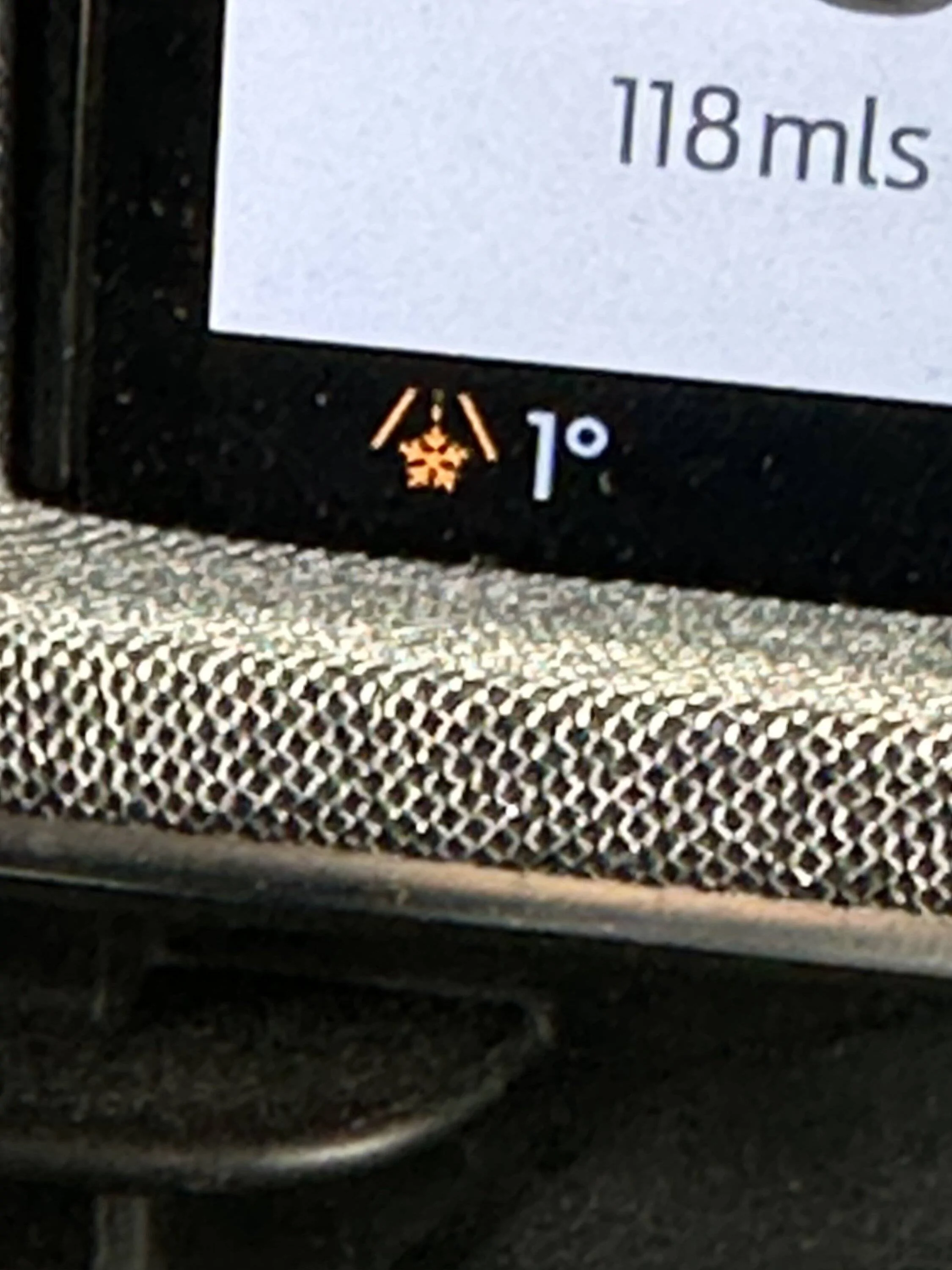

I looked back and found I took the pic below and posted about the snowflake icon on 4th November 2021 when I saw it for the first time. This was in my 2021 Job1 build car which was running Sync version 21139 (UK Power Up 1.6) - so the feature has been knocking around on UK cars for quite some time.
I had always assumed this was a base feature from the very first build so to hear some of you don't have it even now is cooking my brain ?
That was about the same time as I noticed it on my car. First bit of cold weather after we got ours.
