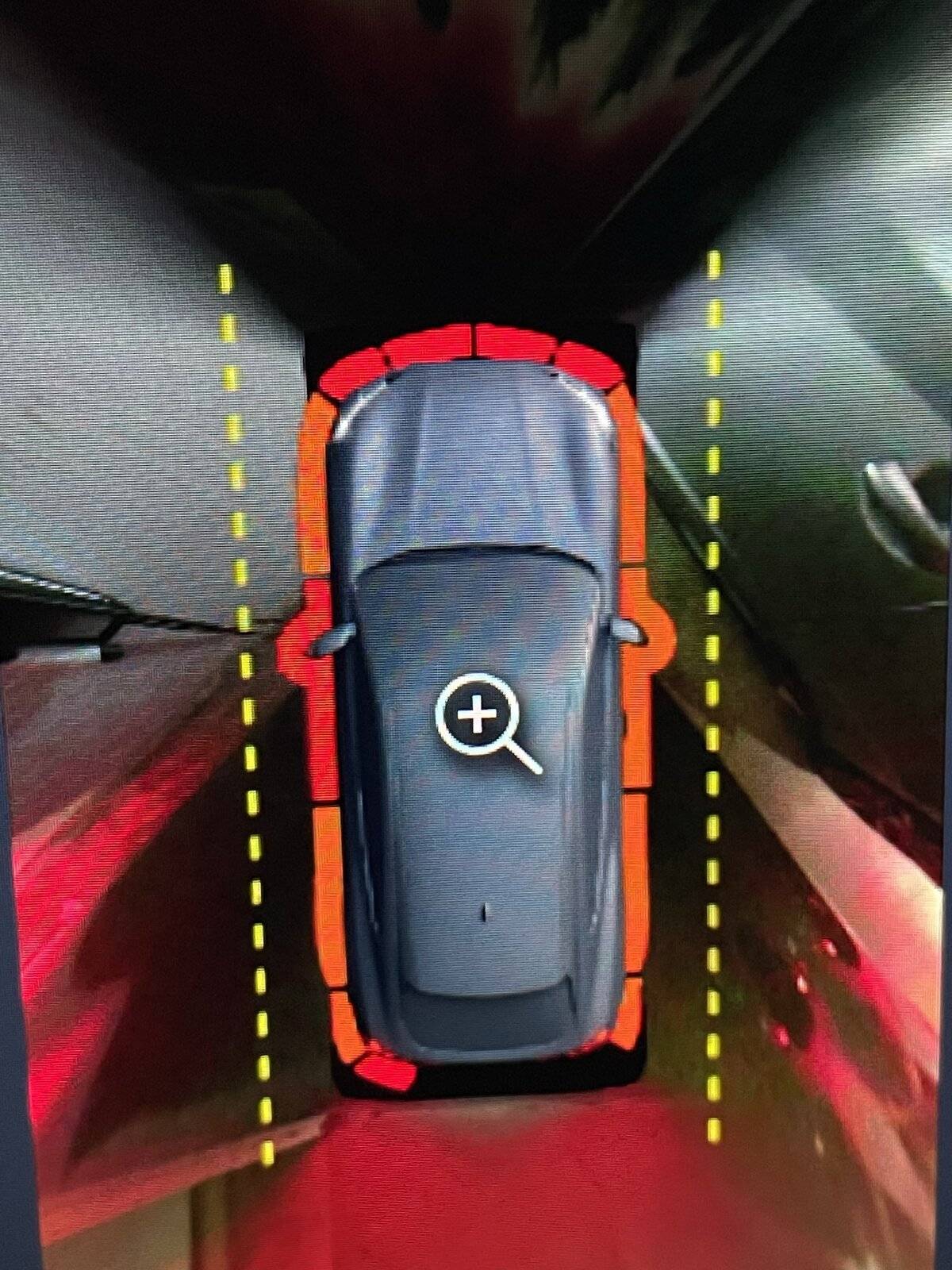

So I use 1PD and have always used it as I've found it fun to use. This is my first EV that I've ever driven as well and I adapted to the 1PD fairly quickly.
I typically always run in Engaged but today I put it in Whisper to mess around. The braking is much less in whisper lol I was coming to a stop that would normally be no issue in engaged but in whisper it was not slowing down. I gave it a little brake and I swear I almost locked up the tires lol So I could see where some people don't like the braking at least if they are running 1PD. If you were not using 1PD then I don't think it would be as bad.
As far as tight spaces and 1PD, it just takes time and knowing your car. I park in a very tight space and I pull in/out in 1PD. One day my 1PD got turned off somehow and it freaked me out cause this car goes zooming with no brake lol I will admit the first 5 times or so of parking was a bit awkward with 1PD.
