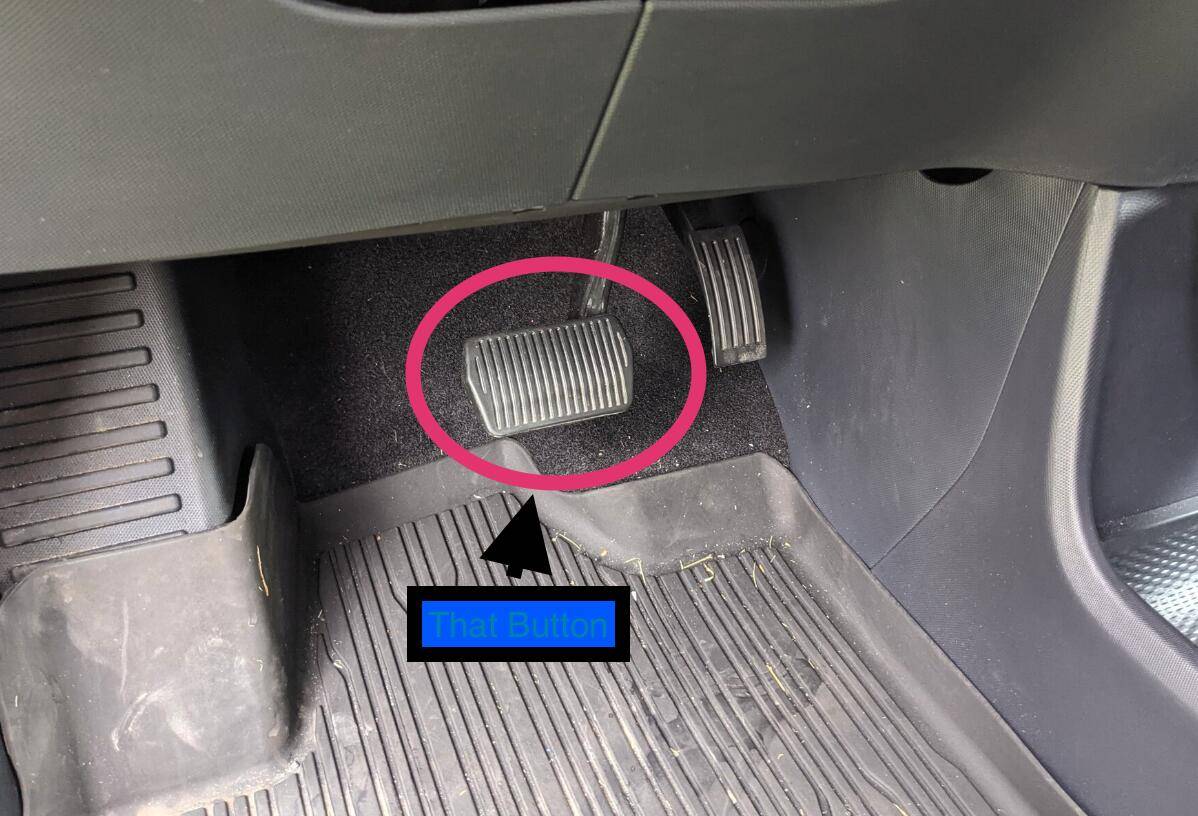

As it's been communicated to me, they don't even have a part that fixes the issue.
Oddly they do and it's already installed next to the other pedal.
